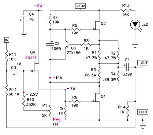

And if you have to stay with SJDP only, you just combine the two sketches
I have posted into one attached.
The new negative voltage reference will set both JFets to the selected current bias, pot in the voltage divider will set the output node to the ~half of the supply voltage. Just find the lowest value for R2, that will work for
your speakers and your ears (again, it's a balancing act). Here R4 will be tens KOhm.
So we have come full circle with some nice changes. We have traded self bias for fixed and added feedback to improve Zout. Nice. Is the top biasing mechanism, consisting of V divider and cap, referred to as a gyrator. Ratio of R6/R5 set gain, correct.
<<Is the top biasing mechanism, consisting of V divider and cap, referred to as a gyrator?>>
No. C2, 300 µF is just a coupling capacitor, and, as demonstrated, is not unavoidable. Gyrators, generally, convert impedances - one into another.
The name of this whole arrangement is SRPP.
<<Ratio of R6/R5 set gain, correct?>>
Not exactly. Since the OL gain here (2×Rload / R2) is not high enough to sacrifice for the FB, I suggested to increase it at the expense of some other parameters by reducing R2. So, for the CL volt gain of let's say 15, that ratio may be ~30.
Besides, R5 will be acting together with C1 and Signal source impedance in series. This is why I stressed the requirement for C1 value. And I have to remind you, that to drive that high and nonlinear Cin of power FETs you will need pretty low source Rout with good output current capability.

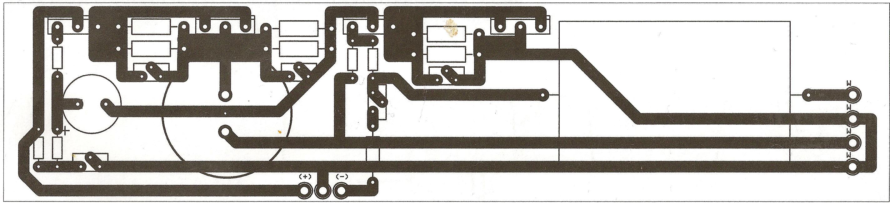

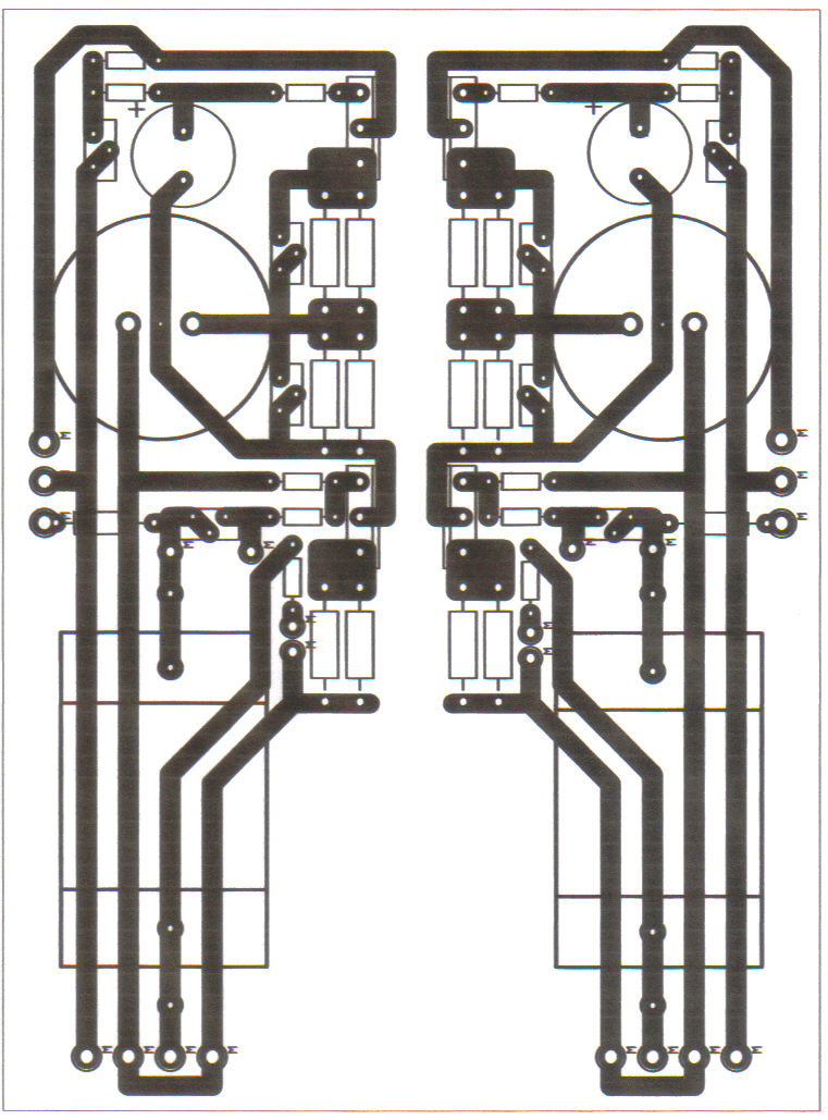

I redid the boards and etched them last night. I have a question about the Rs for the lower fet. Sy is a big fan of LED bias in some of his tube stages. I believe he says that they were tested and found to be quieter than reistors in terms of noise and offer other advantages, such as lower AC impedance. While an LED is not possible at these bias levels, It might be an iteresting experiment. I caould do mulitple, but the number would be too great. This got me thinking about the diodes from the F5. In theory, thewre should be little difference in the two, with the main difference probably being Vf and AC impedance. The diodes from the the F5T, have a larger Vf than I was looking to use, but there are some failry inexpensice schottky diodes with lower numbers. What do you think of the idea and how do i test the AC impedance of one of them.
Since folks are curious how to modify the amp camp amp for depl SemiSouthes, I will attach an example (basic idea) where it belongs.
Clearly, the difference is with the front end circuit.
You will need 2SJ74 V, BL.
You will need an additional neg volt supply, probably up to -10V,
and it will be used to feed the neg volt reference, where the lower end of P1 will be connected.
So, I have marked a few test points to give the ballpark values.
For Q2 SemiSouth depl transistor connection, pick the solution
that works for you (discussed in this thread).

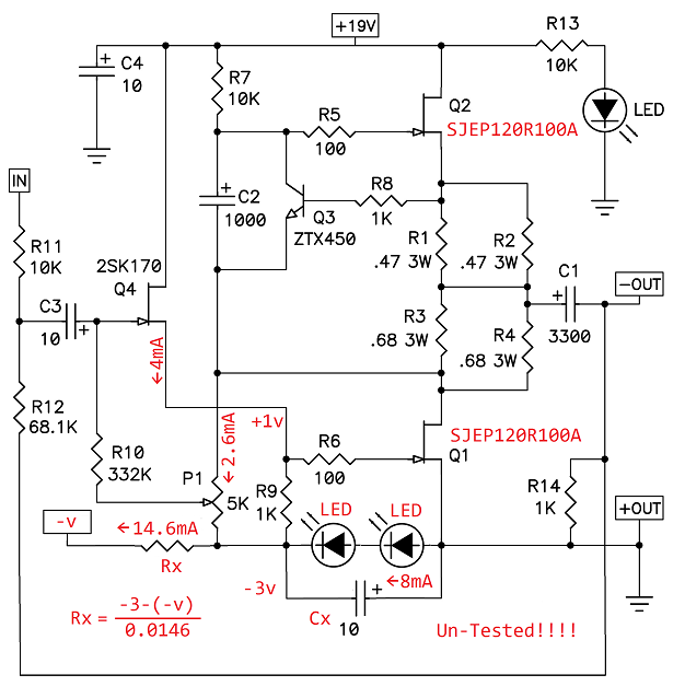

I have not simulated this yet so I don’t know if it will work as drawn. I know this is a depletion Jfet thread but it may be more advantageous to do the Camp Amp like I have drawn it here.
  1. The SJEP120R100A only costs $28 each vs. $41.08 for the SJDP120R085 at newark.com
  2. The top MOSFET can also be swapped out without any changes for the JFET making this an all JFET amp.
  3. There is no need to use P-type Jfets which tend to be harder to find. Moser sells the 2SK170 but not the 2SJ74
  4. You can replace the two LEDs with an ultra-low noise shunt like ADR530 if preferred (Just watch the current limit).
  • I am not sure if the charging of the cap will cause turn on thump?
  • The LED’s should be selected to get a drop of about -3.0~-3.5 volts.
