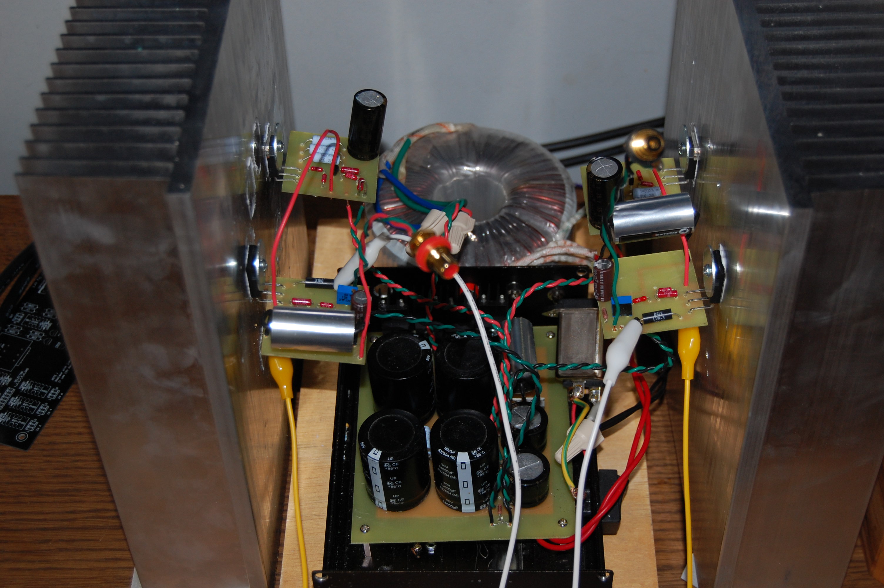

Got mine up and running yesterday. Sounded good enough that i want to cean everything up and get test rig worked out. Iam finishing up the GB, so it is goingt o haev to go on the back burner for a couple of weeks while i get everything sorted.
Well, I played with your graph quite a bit and settled on an operating point about 15V and 3A 😱 That's 45W dissapation!

Based on Nelson's articles, I think 45W is ok. Mine seemed Ok, even if on oversized heatsink. Nelson often speaks of the tendency of Toshiba parts to be able to go beyond specs. I assuming the same here. PLus, I have a nice and quiet desktop fan that can do amazing things to hot amps. What is your rail voltage? I plan on presenting both SE and SRPP version with measurents to boot, as I tihnk this is going to be worthwhile. THe SE version sounded nice to my ears.
Of coarse, the V+ will depend on the speaker and Rl (the effective load) of the gain device. With a 8 ohm speaker and a 14 ohm load R, I would see about a 5 ohm LL with 57V V+. deffinatly something that needs to be experimented and played around with a little...

I have the CCS from the F2 now etched. Resistor loaded comes first(already built), then CCS from F2, then SRPP. I am working on my distortion testing rig now and hope to put numbers with pics and schematic.
