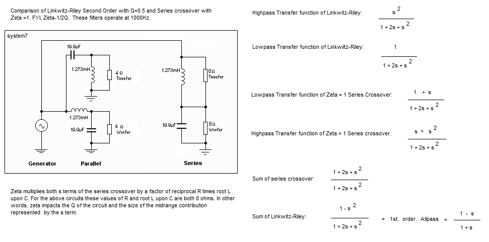

You'll enjoy this, I reckon. I've laboured greatly to produce the transfer function of a series crossover, and compared it with a Linkwitz-Riley using Rod Elliott's values, which are for Zeta=1. 😎
I do find some magic sauce in the midrange component represented by the s term, which we don't often use in crossovers. 🙂

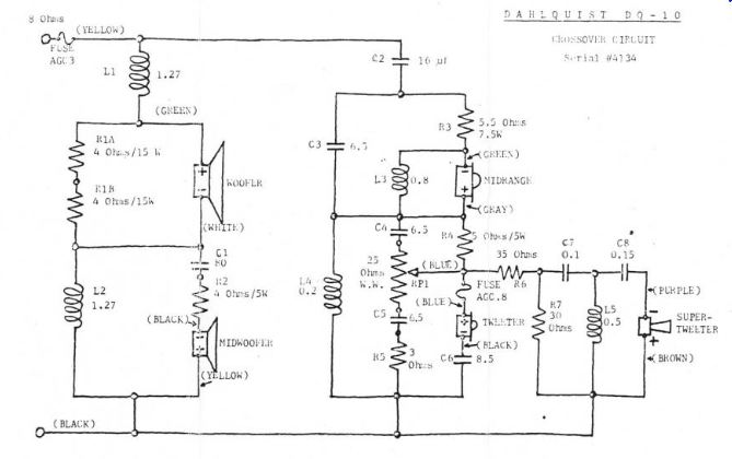

Just for fun, I include a monster series crossover for 5-way speaker known as the Dahlquist DQ-10, which Saul Marantz had a hand in designing.

Even System7 found some 'magic sauce' with the series XO concept and the DQ-10 was a very popular speaker and is still sought after today by vintage collectors. Some claim it came as close to electrostatic panel performance using cone drivers as anything ever built.

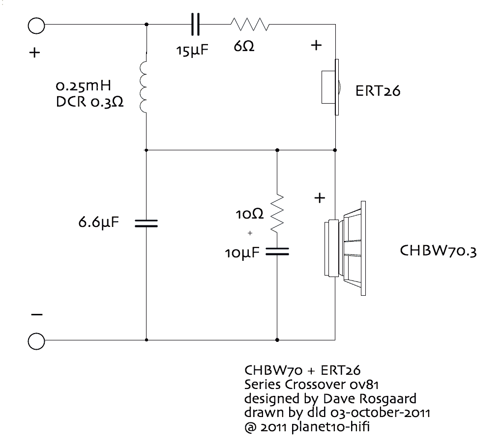

DaveR would not agree with you. But he has spend a huge amount of time, and written his own software,for doing series XOs.
A 1st class example:
of time, and written his own software, for doing series XOs.
dave
Without an analysis comparing series to parallel that is hard to say.
Tony G. uses series a lot, but IMO its religion not common sense.
That particular x/o is 1st order low and 2nd order high series
electrical so it doesn't apply to my 2nd order electrical comment.
rgds, sreten.
