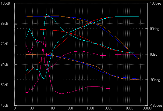

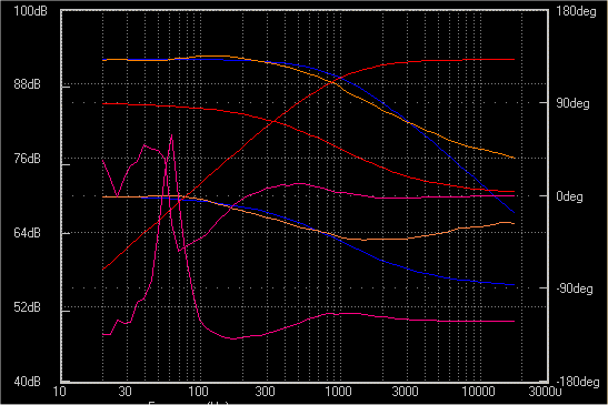

I made a comparison by starting with dummy flat impedance data and driver data, then substituting real woofer data in both the series and parallel cases.
First plot is parallel. Blue is woofer mag/phase before, orange after using real data. Pink shows Ztotal mag/phase for later comparison.
Second plot is series. Blue is woofer mag/phase before, and orange after, then red is tweeter mag/phase before, and cyan after substituting only real woofer impedance data. Ztotal doesn't appear very different.
Not that I see any of this as particularly relevant. The responses shown could be achieved with either type and any interaction is incidental. The point really is....is it the desired response?
