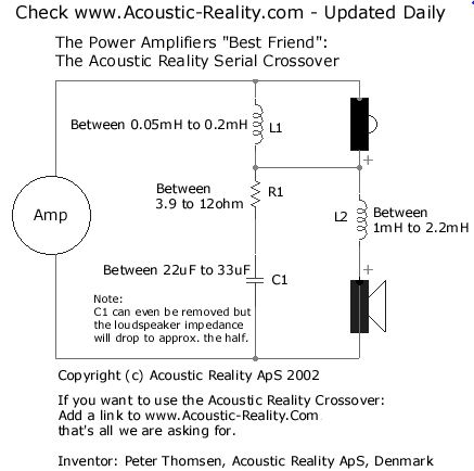

Has anyone pointed ot the problem of intermodulation in series x-o's yet? The back EMF generated by each driver appears, in part or in whole, across the other driver.
This is what I'm waiting for, for my previous question. A technical explanation regarding series filter weakness, which correlate with the sound that I don't like with series speaker (that I have built or heard).
System7 posts 5 way series crossover by Saul Marantz. If some of the links I posted were carefully read Saul Marantz name came up in some of the Fried literature. They were good friends.
Ashley and Small found intermodulation distortion in MOST drivers .They didn't state all. That was in the 60's and 71 papers. Those drivers would have distortion problems attenuated in higher order crossovers. But there would still be diisitortion attenuated.

Another factor with simple LC series x-o's s that you don't have control over the polar response. For example, if you use a simple LC series x-o and dittle with zeta to get flat response, the polar response changes as zeta changes. Additionally, for high zeta each section of the filter (HP and LP) rings around the x-o point and this ringing only cancels on the design axis. Furthermore, as zeta is increased the amplitude at the crossover point approaches and eventually exceeds unity for each band pass with the result that to have flat response there must be cancellation between the drivers. Finally, higher zeta leads to lower impedance around the crossover point.
Additionally, once additional reactive components are added in series with the driver, it is no longer a constant voltage crossover.
Finally, adding a resistor in parallel with a driver (tweeter or woofer) does not mitigate the problem of intermediation due to the back EMF generated by the drivers.
Similar and the same problems can be run into with parallel networks but it is much easier to control the response of each individual driver with a parallel network and the issue of intermediation through the back EMF does not arise.

It should be kept in mind that series XO's lend themselves best to 2-way designs with relatively small mid/woofers like that shown in Planet10's schematic earlier. IMHO, small, mid/woofs back EMF can't be very much compared to relatively larger, dedicated woofers. Thus, back EMF effects may indeed be occuring; but to what degree does it happen in small, 2-ways and to what degree is it manifested acoustically?

Is anybody going to calculate the transfer function for a second-order series crossover? Or do I have to do EVERYTHING round here...🙄

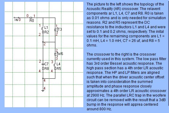

I will probably do the calculation for a series crossover with an additional capacitor and inductor for the two drivers. It's not hard, and I really am fed up with the lack of clear explanation so far. I had to do the sums myself to find out what was going on. In practise, you still add bafflestep and Zobels an stuff. There's an elegance here that interests me.
