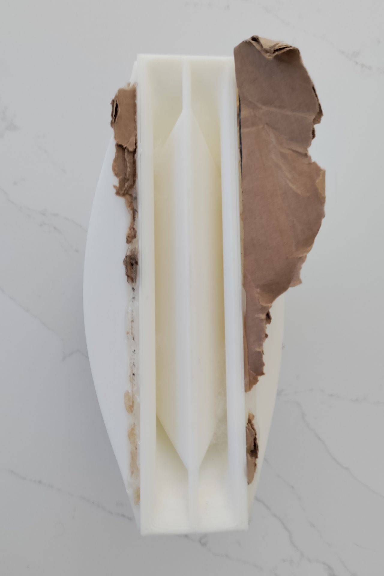

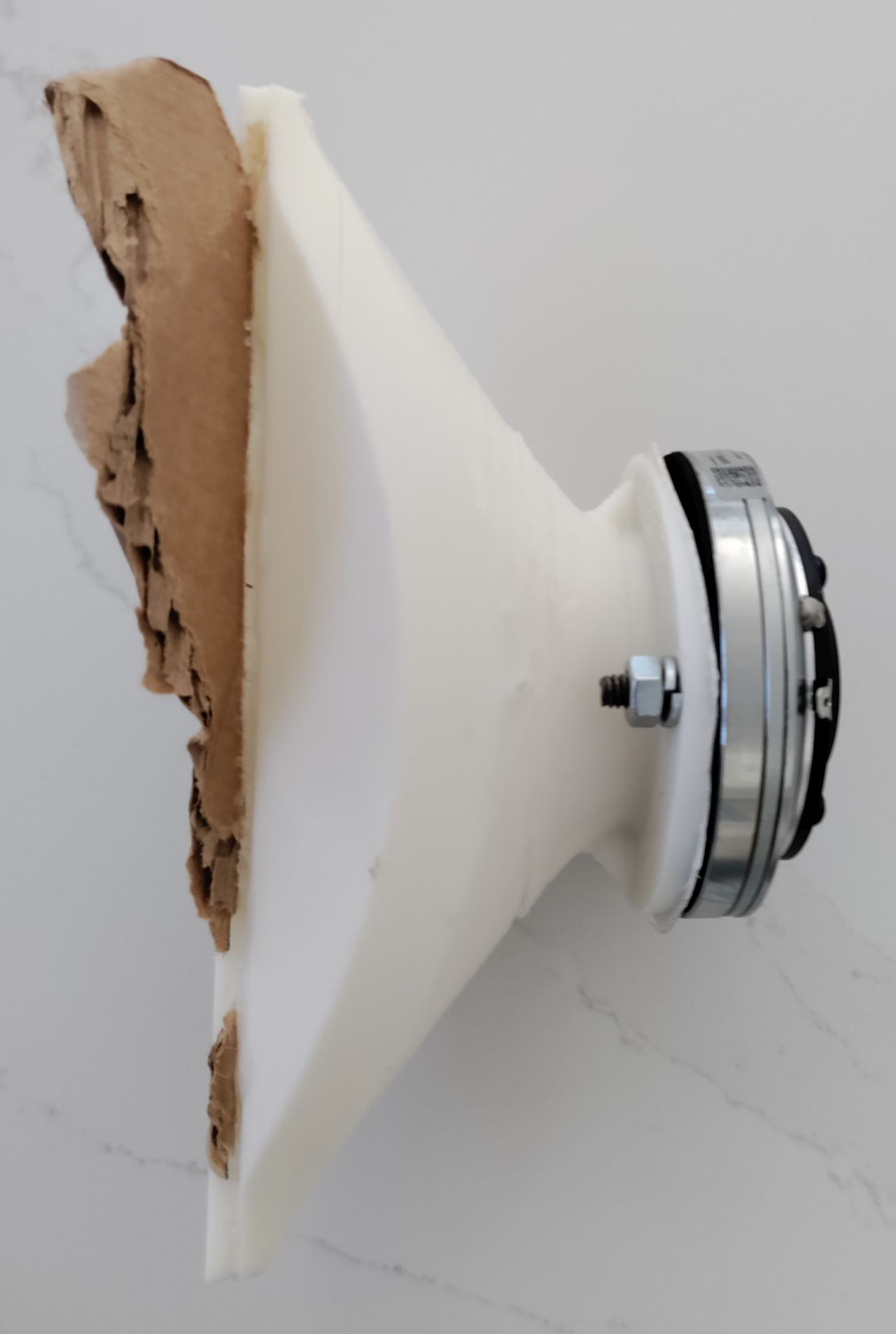

I made a dual tweeter DOSC design. The file is attached. There's a bunch of stuff added to it so that it can print reliably. (I don't like using the raft features included with slicers, I make my own.)
Hopefully the print will be finished tomorrow.
for the dual tweeter design a single waveguide is used for both apertures?

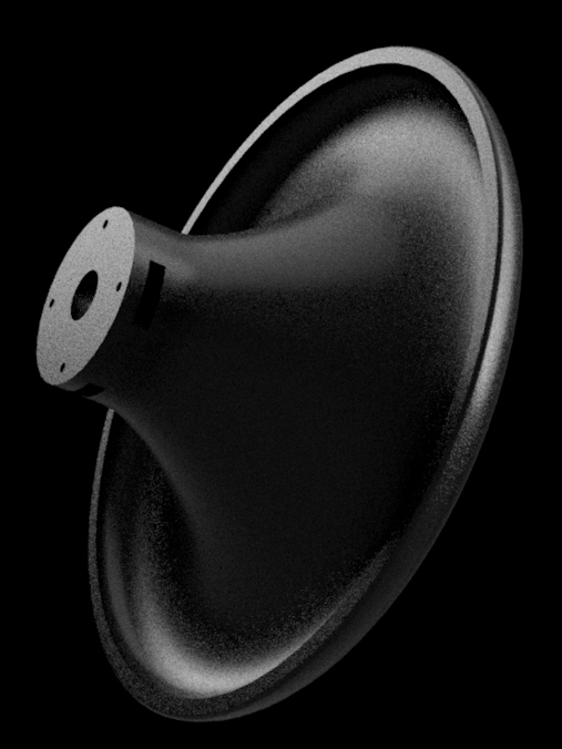

I had a bit of an epiphany when I was working on this thing:
I realized that if you're going to build one of these things, you're probably going to need to commit to building quite a few of them.
For instance, when I wasn't getting the silky smooth polar response that I can get from a ribbon, I began to mess around in ATH, trying to make an ATH waveguide that uses a diffraction slot. Diffraction slots will always compromise a design, of course, but I figured that ATH would be able to minimize things.
But the more that I tinkered with ATH, the more I realized that what I was trying to accomplish is impossible.
Let's say that you make a waveguide that measures 14" x 10" and you include a diffraction slot, with the intention of using the slot to narrow the vertical beamwdith. And due to the height of ten inches, you're looking to cross over to a woofer at about 1350Hz. The vertical beamwidth of the waveguide, at the xover point, is going to be much wider than the vertical beamwidth of the diffraction slot.
You begin to realize why all the audio magazines fret about "integration issues" in ribbon speakers.
Here's the vertical polars of my DUAL DOSC thingy. If I were crossing over at 3khz, the vertical beamwidth is legitimately narrow - about thirty degrees. But due to the high displacement and high power handling, this thing has no problem crossing over at 1khz. But at 1khz the vertical beamwidth is about 120 degrees!
So you can see that if you were going to use one of these in the real world, you probably need to "commit" to using 5-10x as many units.

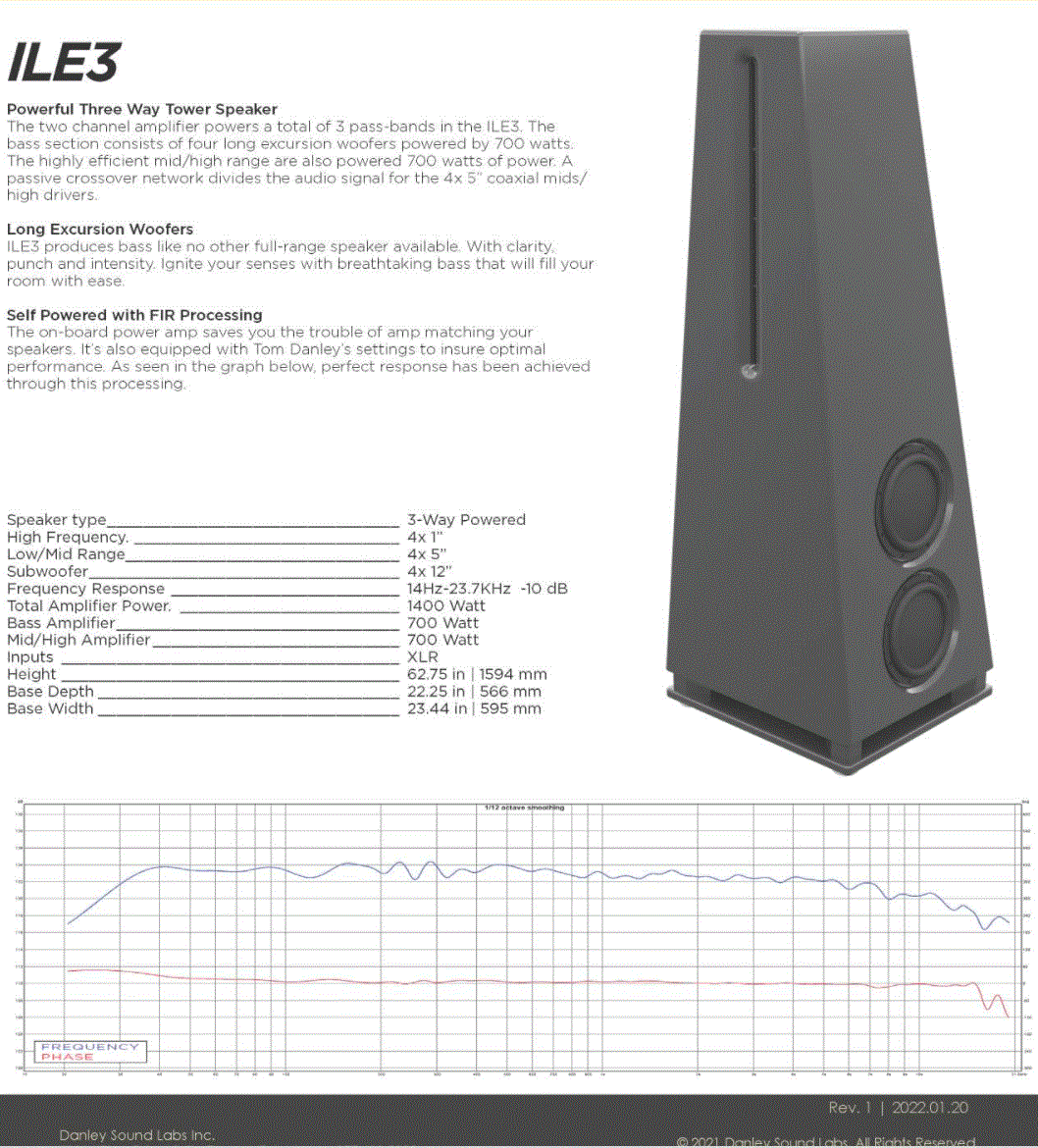

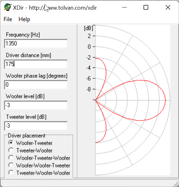

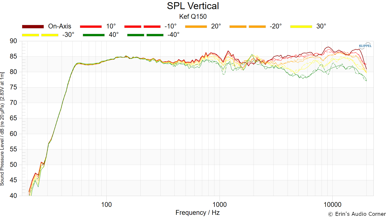

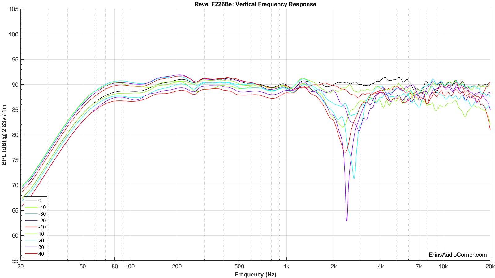

I grabbed some pics and measurements from Erin's Audio Corner which illustrate "The Boring Option." Basically the use of a conventional array to control directivity down into the midbass. The Revel array controls directivity quite low. In comparison to a smaller speaker like the Kef Q150, you can see the Revel's vertical directivity control goes much much lower.

That's kinda the dilemna I've been contemplating this morning. Basically "how do you cross these over?"
If you used two and you crossed them over to a midbass, you're going to end up with a vertical pattern that 's very narrow above 1600hz.
Two ways speakers with ribbons generally ignore this, so maybe that's acceptable? I dunno.
If you were going to use more than two of these DOSCs that I posted, I would consider setting them up in pairs and then tilting them vertically. Basically so they don't interfere with each other.
If you used a crossover point of about 2khz or higher, tilting might not be necessary. You can see in the vertical polar measurements that the directivity is pretty narrow until the wavelengths are physically larger than the dual DOSC. The dual DOSC is about 8.5" tall (1600hz.)

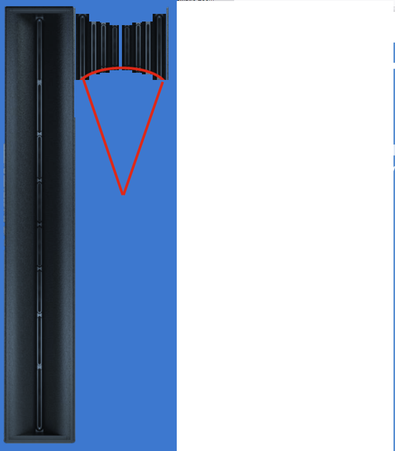

IE, something like this:

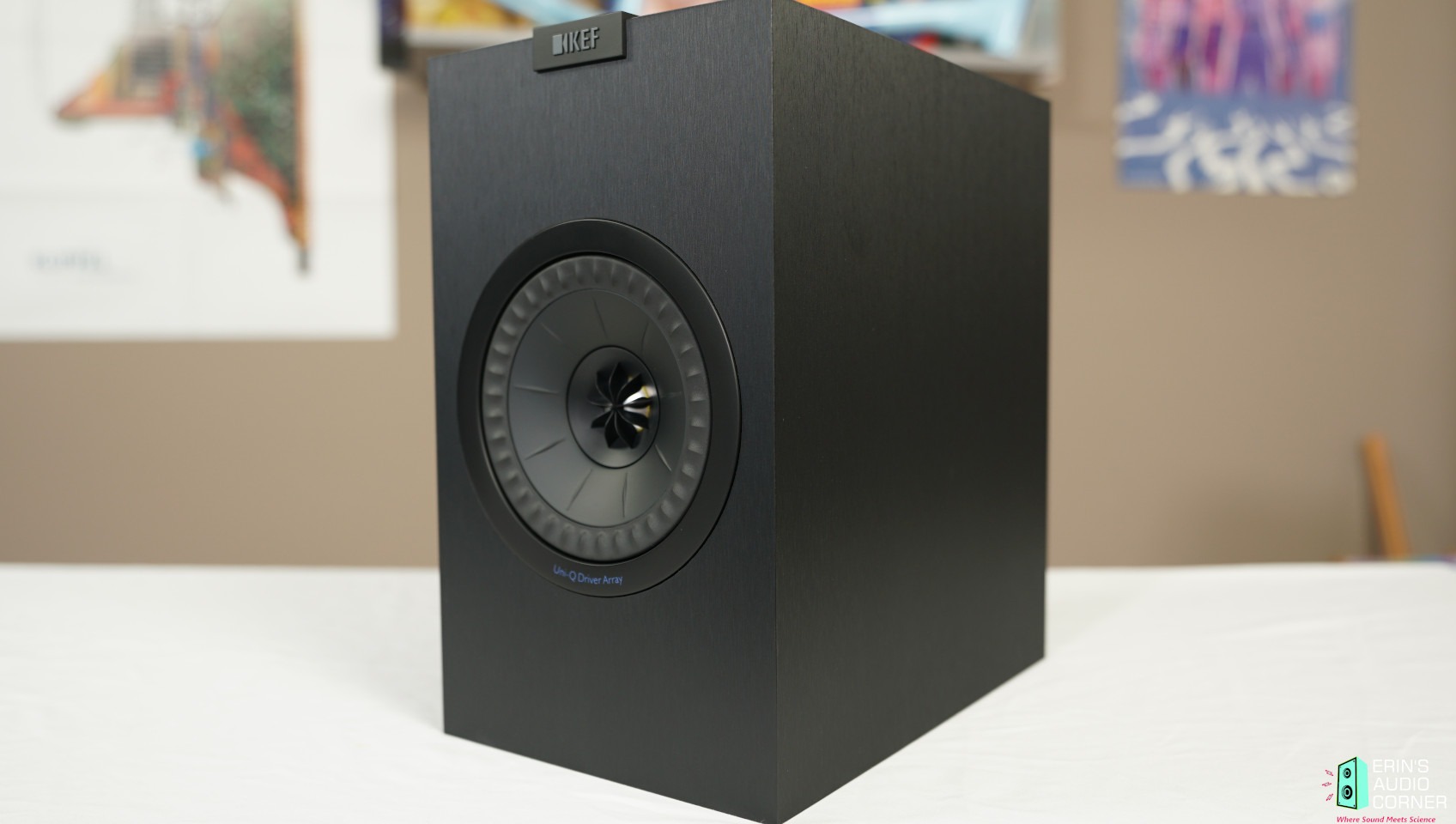

With a bit of reflection, I realized that I may be able to leverage cabinet diffraction to narrow the vertical beamwidth.
I think everyone knows how this works, but just thinking out loud here:
Basically when a wavefront is larger than a speaker baffle, but not a LOT larger, it will diffract off of the baffle and curve around the sides.
This can extend the beamwidth control of the loudspeaker much lower in frequency than you'd normally see.
The Kef Q150 illustrates this pretty well. With a 7" waveguide, we'd expect directivity control down to about 2khz. But there's directivity control all the way down to about 700Hz or so, due to diffraction off of the baffle edges and the transition from half space to full space radiation.
When I evaluated the Danley SH50s in my condo a few years back, I didn't have enough room to really put some "space" around the SH50. My living room just wasn't big enough.
In Erin's measurement of the SH50, we can see that the directivity control goes all the way down to 100Hz, due to the enclosure shape. The 'trick' is that you need some space around the speaker so that the wavefront can transition from half space to full space.
Erin's measurement set up satisfies that requirement.
So what I am thinking is that it may be possible to get controlled vertical directivity as low as 200Hz using an enclosure that's basically comparable to a Danely SH50, but with all the dimensions reduced by HALF.
This would yield a box that's a fraction of the size.
The SH-50 is 11.5 cubic feet and 133lbs. Not a small speaker.
If one were to make something with the dimensions halved, you'd end up with 14" x 14" x 12.75" (1.44cf) and a weight around 30lbs or so.

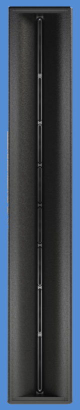

9 years have gone by but not too late for someone just catching up "the width of the flow passageway must be less than one-third the wavelength at the highest frequency of interest. Above this frequency, the mixing of energy greater than about one-third wavelength apart in passage results in periodic cancellation and interference."
In market material about paralines Danley talk about matching the paraline output wavefront to conical horns in order to form a horn of greater effective length. E.G SBH10:
https://www.danleysoundlabs.com/wp-content/uploads/2022/02/SBH-10-Spec-sheet1.pdf
As this speaker has 8 drivers this means that there are 4 unique paralines? (bottom been flipped versions of the top).
That's right. You can see they get progressively taller.
This also curves the wavefront. (The Paralines at the top and bottom are delayed, when compared to the one in the center.)

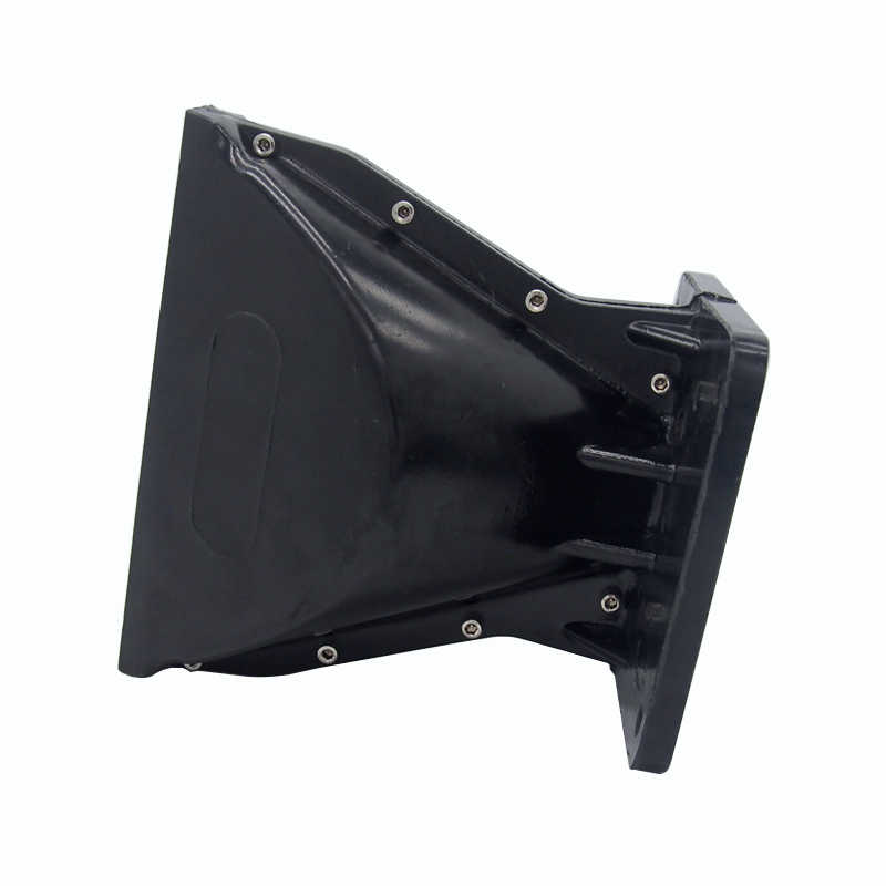

Over the last 3-4 years, I kinda "hit a wall" with these designs.
When I used a 3/4" soft dome tweeter with a VDOSC, I found that performance was significantly improved.
This led me to assume that keeping the pathlengths as equal as possible is ideal, and Nate Hansen observed something similar in his post from ten years ago:
https://www.diyaudio.com/community/threads/square-pegs.217298/page-16#post-3161275
professional-audio-line-array-speaker-tweeter-horn-equipment-for-dj-console-mixer-subwoofer-kara-jpg.898544
I also assumed that minimizing the angle of the bends as much as possible is a good idea.
The L'Acoustic VDOSC waveguides, which predated the Paraline by nearly two decades, reduce the angle of the bends by about 50%, and I've largely focused on cloning those, but not Paralines. But it was also kinda "vexxing" that the original Paralines don't perform much worse than the VDOSCs. (As I understand it, there are something like four or five different Paraline designs out there, from the original in the Danley Genesis Horns, to the VTC Paraline boxes, to the Yorkville Paraline boxes, to the latest version in the newest of the Danley Jericho boxes.)
So the main point here, is that nearly every variation I've made over the last 3-4 years has focused on smoothing out the bends in the Paraline, while also experimenting with small tweeters instead of giant compression drivers. This is contrary to Art Welter's designs, which use a compression driver that's quite beefy mounted to a Paraline with 180 degree bends. (Note that Art's Paralines perform quite well, indicating that I might be obsessing over the wrong variables.)
To be continued...

Basically when I first started messing around with M2 style waveguides, I was using large slots, because the M2 has a large slot.
JBL itself moved away from the "Large Slot Style", and it's likely for similar reasons. The large slots cause a high acoustic impedance, which manifests themselves as:
1) a series of peaks and dips across the entire frequency range
2) a prominent peak in the low frequency of the device, which is caused by a big spike in the acoustic impedance that occurs at the low end of the device
