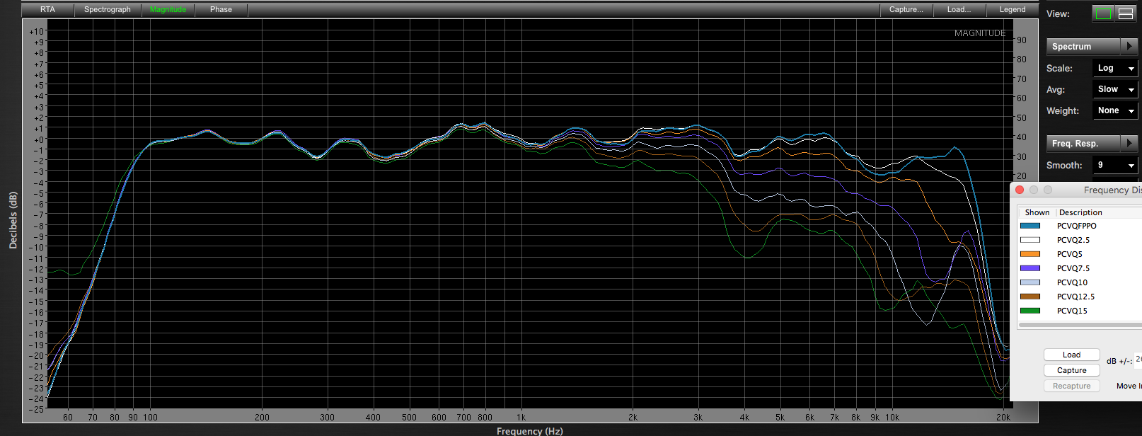

You can use your calculator to determine a 'reasonable" height for the array. For instance, if you listen at a distance of two meters, if the array is two meters high, you can be as much as 26.6 degrees off center, and the sound shouldn't change.

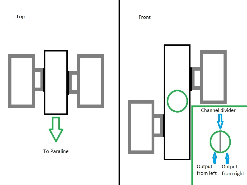

So I have two compression drivers. Say I wanted to combine those in a Paraline, which then couples to a horn shell to provide the final flare of a horn, but all of the Paraline designs I've seen here have a HF driver at the very centre of the device, flanked by two cone drivers.
This seems to suggest that with a two-driver combination, the HF driver would be in the centre, as before, and the low-mid compression driver would have to be offset.
But how would that work? Wouldn't that cause the wavefront coming from the offset driver to be bent?
I don't want that 🙂 I just want to merge the outputs of the two compression drivers into one horn!

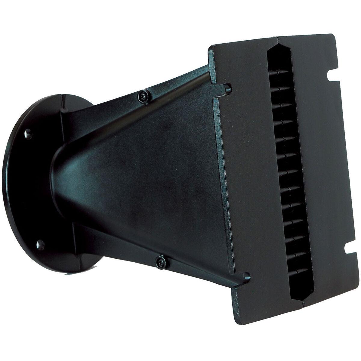

The Paraline, DOSC, V-DOSC and various devices from JBL / 18 Sound / Bose / BMS / etc simply produces a wavefront that's shaped like a ribbon driver.
It's a way to "have your cake and eat it too."
Basically you take a spherical wavefront and you smash it into a ribbon shaped wavefront. You could take any of the loudspeakers that use a Paraline, and replace the tweeters with ribbon tweeters, and they would basically work the same. The main difference is that ribbon tweeters have a habit of exploding and their efficiency isn't as high as a compression driver.
Another thing about the Paraline, is that it's possible to produce a wavefront that's ribbon shaped, but curved. As far as I know, there are no curved ribbons for sale.

So it seems that two compression drivers in a Paraline would be difficult to account for.
Time for a crappy drawing! Could we converge compression drivers into a single exit before it entered the Paraline?
This drawing doesn't take into account any of the internals, and so the effects of each compression driver pushing air down the other's 'channel', the exit angles of the compression drivers, or even what the lengths of those channels before entering the Paraline would do to the overall path length.
I could see, internally, that one side of the channel could be rounded (a D-shaped cross-section), which would then combine at the exit as a circle when the channels from both driver meet. There would be a central divider to keep the horns separate for as long as necessary. Layered combiners are nothing new, but from the patents they appear to be potentially too involved for what I was thinking of...but I'm probably wrong 🙂
It seems like 3 drivers is really the smallest multiple-driver option for a Paraline, because the centre driver can always be the HF, flanked by the mids. Two's more difficult to consider 🙂

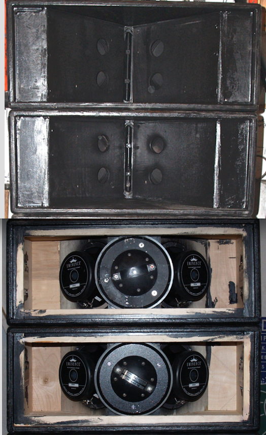

I'm aware of all of those things.
The gist of the post that you referenced is that I didn't realize until the last six months or so, that these devices need to be about as tall as the lowest wavelength that they play.
I would take it a step further, and also argue that their pathlength should probably be kept to a minimum.
For instance, here's the latest one that I've made (before I figured this out.) It's eight inches tall. The cardboard gunk in the pic is from the cardboard waveguide that I glued to it.
The cardboard waveguide was fairly similar to this.
I think that I would get better results with these things if I was using two or three of them stacked vertically, for a total height of about sixteen inches.
Here's a few reasons I think this would work better:
1) A DOSC is a diffraction slot, and if you're going to use a diffraction slot, shorter is better. This DOSC, with a vertical height of 8 inches, has a pathlength of about 5.66" long. I think if I could reduce that pathlength down to 2-3" in length, that would work better. Basically, if you MUST use a diffraction slot, keep the size to a minimum.
2) Another advantage of a shorter path, is that I can make the exit narrower. If you look at the two vertical slots at the exit of the DOSC, the center-to-center spacing between the two is about one inch long. One inch probably doesn't seem like a lot, but 20khz is only 0.675" long and a gap of an inch will cause issues.
3) The Eminence N151M is already ridiculously efficient, but using two or three will increase output, particularly on the low end.

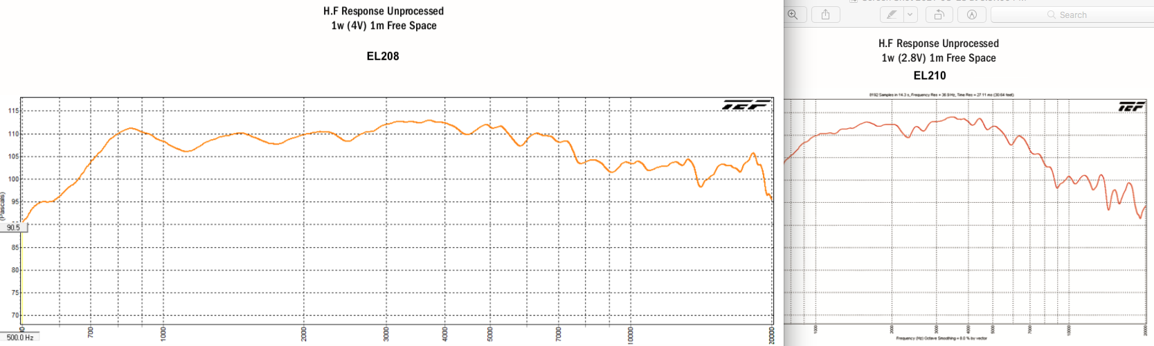

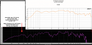

Here's a comparison of the VTC EL208 and the EL210. The EL208 uses one compression driver, EL210 uses two. Although the EL210 has about 3dB more output below 6000Hz, the EL208 has more output above 6khz, despite using half as many compression drivers.
To me, one of the most interesting things is that the EL210 is smoother overall. So the additional compression drivers appear to smooth out the response.
It's difficult to decide which is better though:
The dual driver Paraline of the EL210 is more efficient, with higher power handling, plays lower and is a little smoother. But the maximum output above 10khz is actually inferior, by two decibels.

The comparison of the single driver EL208 (8” tall Paraline) to the dual stacked (12” total tall Paraline) EL210 is interesting, but there are a few more things to consider as far as the sensitivity and maximum output.The gist of the post that you referenced is that I didn't realize until the last six months or so, that these devices need to be about as tall as the lowest wavelength that they play.

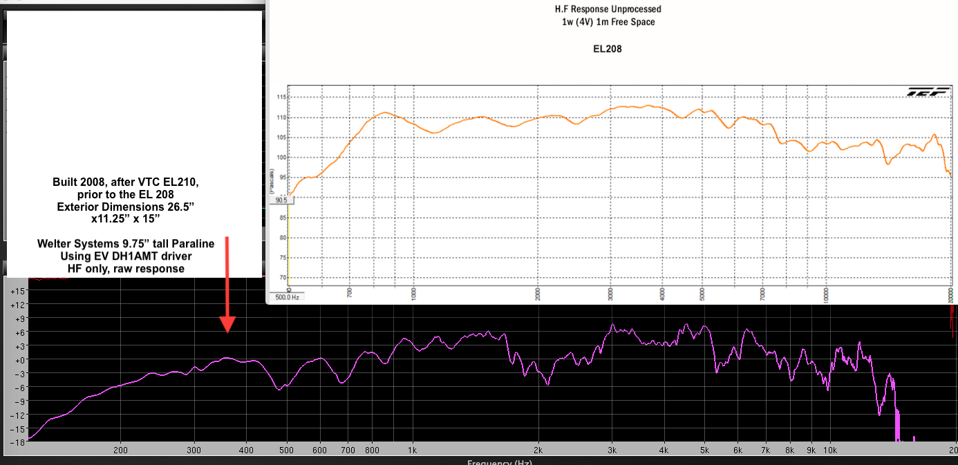

The EL208 is 110 x15 degrees, so should be a bit less sensitive than the 90x10 EL210, even if the driver count was the same.
Doubling drivers should result in +3dB across the bandpass range if dispersion were the same, reduction of dispersion should result in higher on axis sensitivity.
However, at 800Hz and below, the EL208 HF section is a full 5dB more sensitive than the EL210.
The roughly 4” extra path length in the 8” tall Paraline provides better LF loading than the stacked 6” Paralines, an advantage when using drivers that don’t like to go low coupled with LF that band passes at 700 Hz.
As you said, above 6kHz, the single driver again has more output- the EL210, given twice the VHF power would just keep up on axis.
That said, the vertical off axis response in the specified pattern appears better for the EL210, which begs the question if the EL208 uses divergent Paralines, or simply specifying top and bottom cabinet angles as it’s dispersion.
I suspect that the EL208 vertical response might look better if it was also measured at 5 and 10 degrees rather than 7.5 and 15.
Art
Patrick,
Re-using the shells and components of the line array I had built around the year 2000, built a 2x8"/EV DH1AMT Paraline system back in 2008, after reading about the VTC EL 210, four years prior to your starting this thread.
The VTC EL208 had not yet been released at that time.
Having dug into my records more (after re-reading most of this entire thread), thought you might be interested in seeing the raw response of the EV DH1AMT Paraline HF portion compared to the VTC EL208.
It's additional height (about 9.75" compared to 8") makes the throat adapter about 3.5" longer.
Had forgot how low the response of the DH1AMT HF went compared to the tiny BMS drivers.
Raw response +/- 6dB 200Hz to 16kHz. Can't run it that low for PA without running out of excursion, and response is rough (some possibly due to the parallel top and bottom horn walls) but it's there..
Had also used 2.5 degree increments for testing vertical polars, it appears to be smoother than the VTC's off axis response.
The processed polars include the 8" drivers also, using smoothing similar to the VTC's charts.
Art
Math error correction.It's additional height (about 9.75" compared to 8") makes the throat adapter about 3.5" longer.
The path length through a non-divergent Paraline is only roughly 1/2 the height. Since the exit width is the same for the taller exit, the driver throat to exit ratio increases for the taller unit.
That said, the DH1AMT throat is 1.4” (35.5mm) the BMS 1", so the throat to exit expansion ratio of the 9.75" tall Paraline is nearly the same as the 8” VTC EL208.
Art
