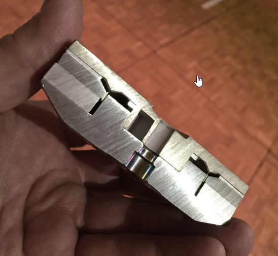

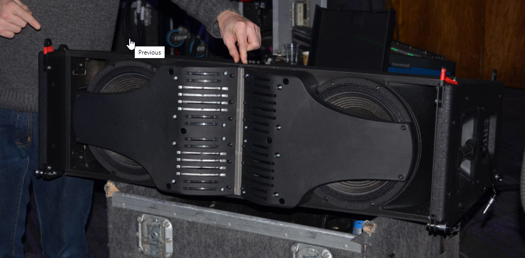

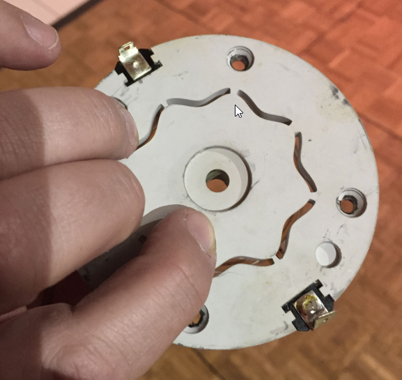

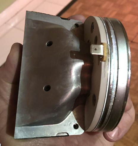

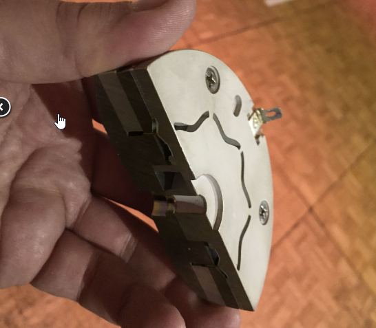

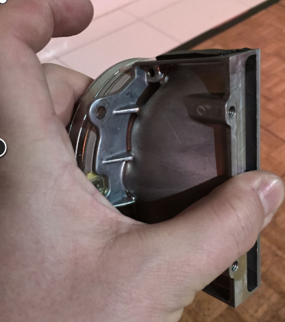

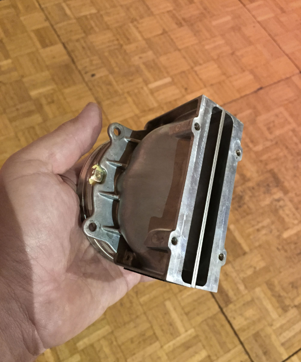

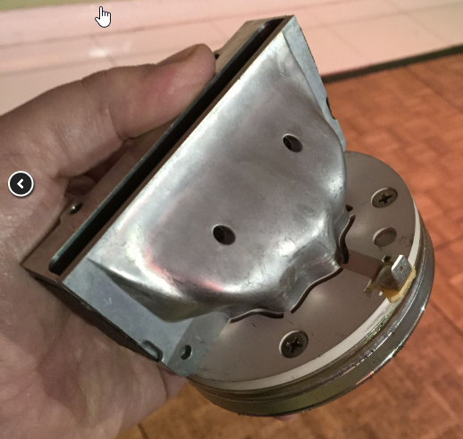

Here's some pics of JBLs new compression driver for line arrays. Looks like they ditched those awful "channel" things they used to use, and went with something much simpler.
Kudos to Ro808 for the find.
2020-01-24 12_46_52-JBL VTX A12 – nowy 3-drożny koncertowy system liniowy - PortalNaglosnie.png872.6 KB · Views: 803
2020-01-24 12_47_26-JBL VTX A12 – nowy 3-drożny koncertowy system liniowy - PortalNaglosnie.png482.1 KB · Views: 309
2020-01-24 12_47_37-JBL VTX A12 – nowy 3-drożny koncertowy system liniowy - PortalNaglosnie.png479.2 KB · Views: 321
2020-01-24 12_47_49-JBL VTX A12 – nowy 3-drożny koncertowy system liniowy - PortalNaglosnie.png541.8 KB · Views: 322
2020-01-24 12_48_20-JBL VTX A12 – nowy 3-drożny koncertowy system liniowy - PortalNaglosnie.png351.3 KB · Views: 279
2020-01-24 12_48_32-JBL VTX A12 – nowy 3-drożny koncertowy system liniowy - PortalNaglosnie.png455.9 KB · Views: 310
2020-01-24 12_48_51-JBL VTX A12 – nowy 3-drożny koncertowy system liniowy - PortalNaglosnie.png500.3 KB · Views: 1,490
2020-01-24 12_50_01-JBL VTX A12 – nowy 3-drożny koncertowy system liniowy - PortalNaglosnie.png802.2 KB · Views: 865

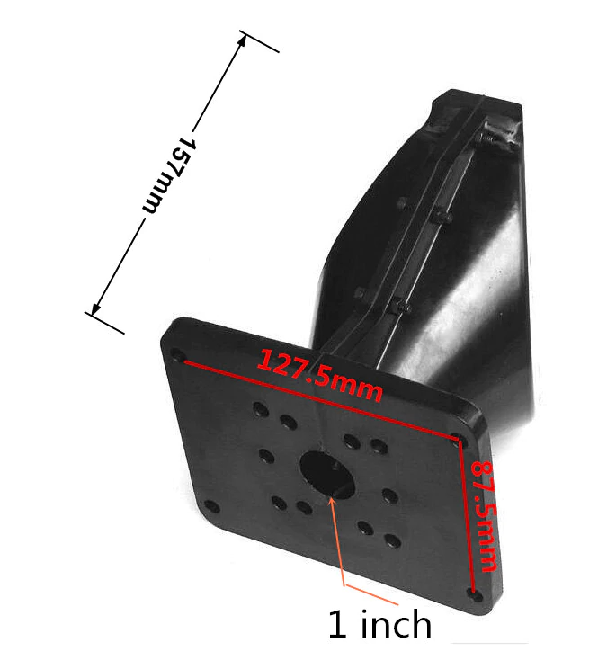

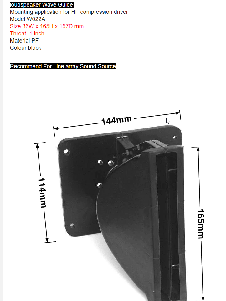

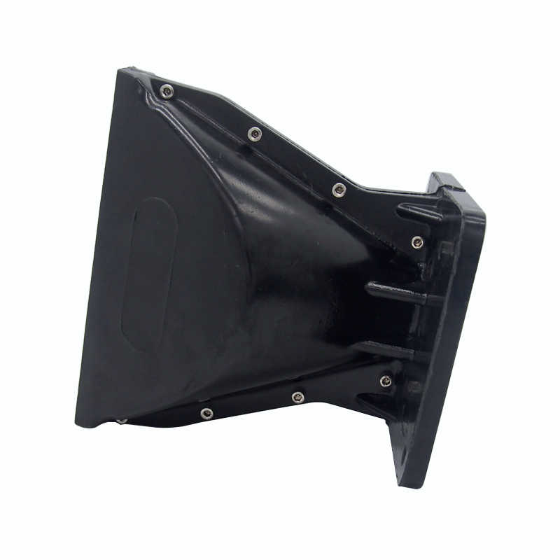

I thought I'd posted this project online, but I don't see any record of it.
So, here's something I built about seven months ago. It was my attempt to take the L'Acoustic "VDOSC" technology about as far as it would go. It looked like a VDOSC, but the "secret sauce" was inside of the lens, where I really put in a lot of work to smooth all sharp edges.
It basically looked like this one you could buy on Aliexpress: https://www.diyaudio.com/forums/att...equipment-dj-console-mixer-subwoofer-kara-jpg
Mine was 3D printed, of course.
Here are the horizontal polars
Here's the same measurement, but I filled the lens with polyfill. My thought was that the dip at 12khz may be a higher order mode, and polyfill might reduce the impact of that mode. If you simulate these devices in Abec, you'll see that a significant fraction of the output is delayed, diffracted and reflected by the bends. So anything you can do to reduce the impact of those factors should be A Good Thing.
Here's a graph showing how the polyfill impacts the output. As you can see, you lose about 4dB of output from it. This is a bit tricky; the entire point of a VDOSC is so that you can array tweeters. But the polyfill reduces your maximum output. And note that a tweeter is generally the weakest link in a loudspeaker, and dictates the maximum output of the entire speaker.
Here's the vertical polars. They're kinda terrible. This measurement is with no polyfill, iirc. You can see that the beamwidth is around 40 degrees, not the "zero" degrees we'd expect.

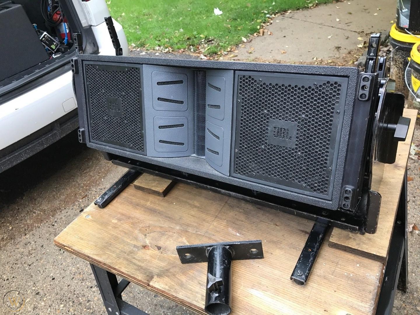

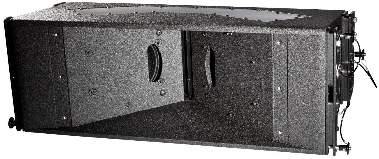

JBL is simply using a slot now. Nothing hyper complex, just a slot. They used to have much more exotic solutions.

Something I noticed, from reading my own threads on this:
It looks like these devices only work optimally if they're as tall as the wavefront that they're playing.
I don't think I've seen this quantified by anyone, but it seems to be a rule that's followed by the pros.
Here's some examples:
The VTC EL208 has two compression drivers, a crossover point of 900Hz (15") and a height of eleven inches.
The JBL VT4886 has two compression drivers, an unknown crossover point, and a height of eight inches (equivalent to 1688Hz.)
Here's my thoughts on this:
If you look at the horizontal polars of my latest VDOSC style device, they're not "amazing" but they're not awful either:
But if you look at the vertical polars, they're pretty bad:
And the one that I made a few months earlier wasn't any better:
