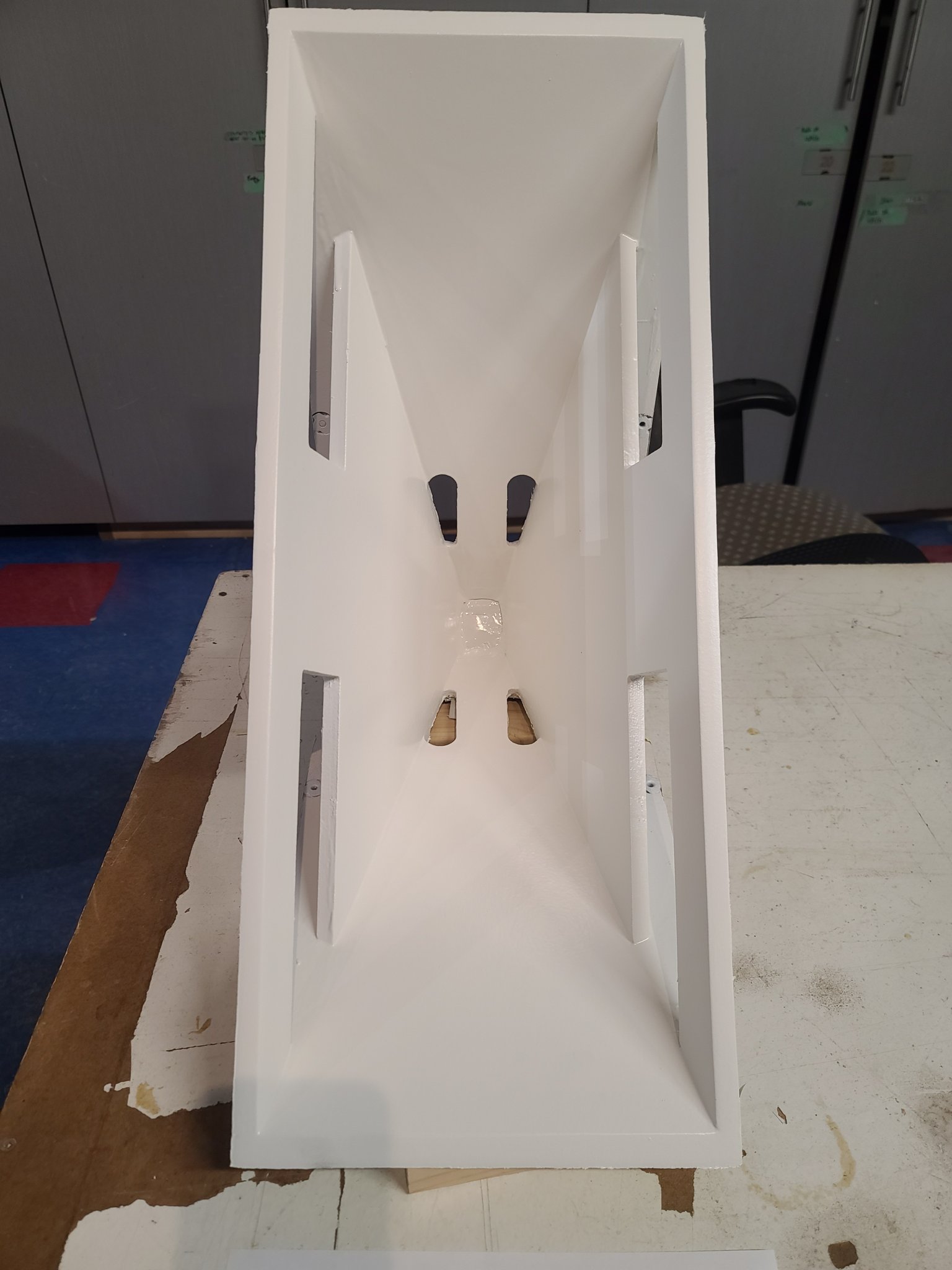

I spent a few hours trying to come up with a conventional waveguide with a very narrow vertical beam. Basically, a way of replicating something like a VDOSC or a Paraline but without a reflector.
It's surprisingly difficult to do, but I thought that I'd post the results, in case anyone else has considered using a diffraction slot (or if they have an idea of how I can fix this.)
Here's the overhead view. Note the deep diffraction slot.
Here's the side view. Note that the diffraction slot is only on one axis.
Here's an old school diffraction horn, for comparison's sake. Similar idea, but the sharp edges create HOMs
Here's the front view, you can see I invested a lot of effort to blend everything together
Here's the vertical and horizontal polars. I see a bunch of issues here:
- The first issue is the ragged response
- The second issue is the peak in the upper midrange
- But the biggest issue of all, is that the beamwidth on the vertical axis just isn't very narrow. My goal with this waveguide was to try and come up with something that might be able to replace a Paraline or VDOSC but WITHOUT bends. If the waveguide in this post was able to produce a wavefront with a vertical beamwidth of 10-30 degrees, I could live with some wiggles in the frequency response, and maybe even that peak in the upper midrange. But it doesn't achieve those goals, in fact the vertical beamwidth isn't much narrower than the horizontal beamwidth. Now the OBVIOUS way to make the vertical beamwidth narrower is to make the diffraction slot deeper. But I can't do that BECAUSE the peak in the upper midrange is CAUSED by the diffraction slot. IE, the bigger and deeper that the diffraction slot is, the worse that the peak is.
Here's the report on the waveguide, from ATH

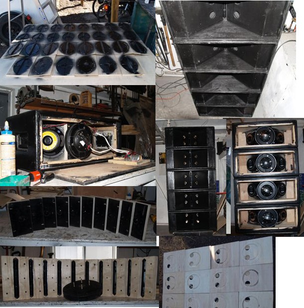

The SynTripP is identical in size to the Paraline system I built in 2008:
e.
Closely coupled subs add +6dB.
Two compression driver outputs through one throat in theory would result in +6db, in practice around 4dB is usually closer to the results. If using low displacement drivers, better to stack shorter Paralines with multiple CDs on top of each other.
Using 12" drivers for mids, using 4" diaphragm or co-axial drivers like Todd ("TDM") uses in the current Yorkville/VTC is the way to go.

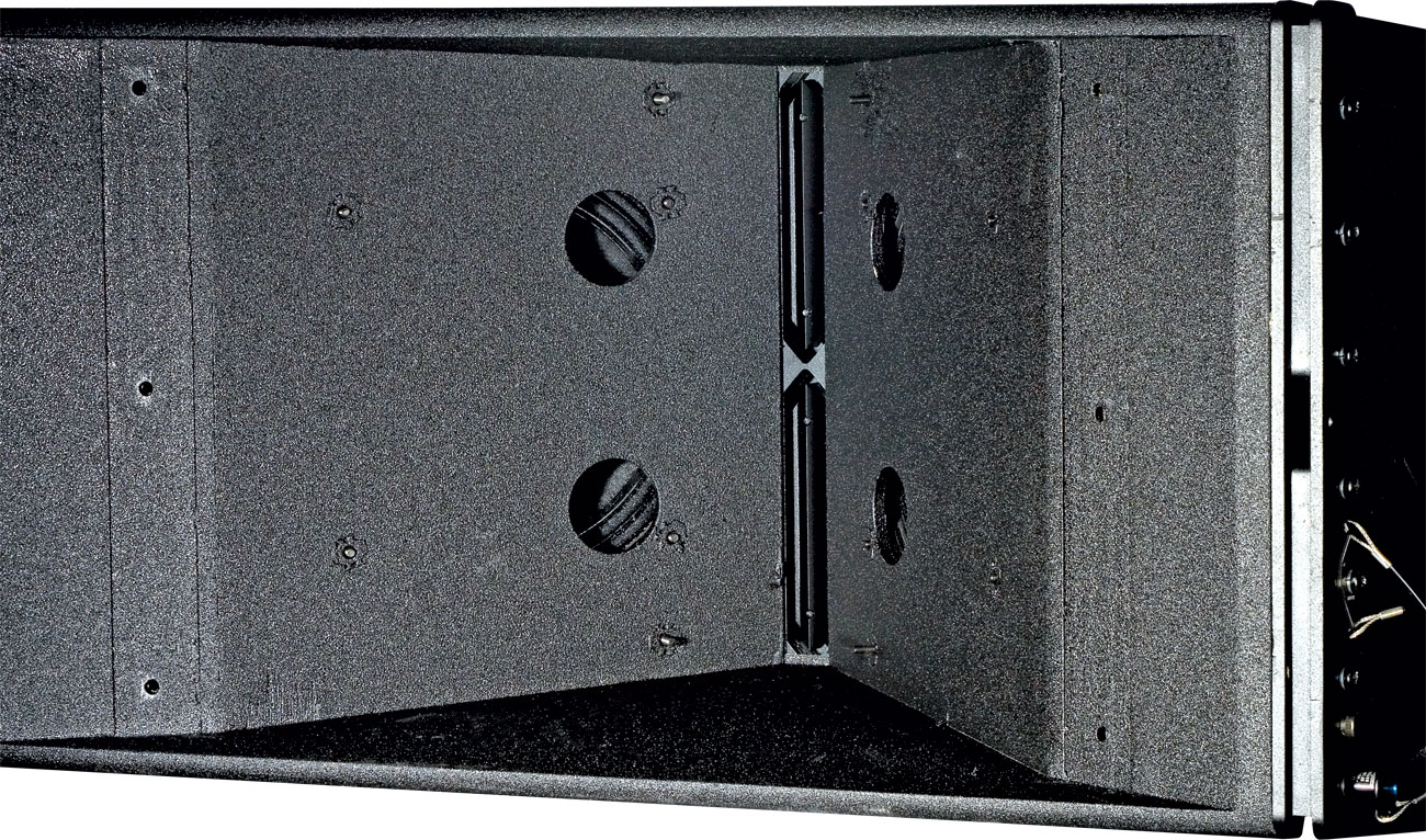

Thanks, nice job.
I think cnc machine would improved quality a bit, especially paraline throat which could be made out of aluminium.
May be because of inadequate throat coupler in practice, I wonder how good is Danley design of first using paralines and then couple them like this.
To me seems like maybe better option than stacking 2 of them verticaly because we are losing point source and 1-3db gain when stacked. Also instead of making short paraline with long throat after we could make converging part of paraline longer so we also make that angle less hard.
There are 4x 90* angle inside paraline throat, do you think its too much regarding SQ.
Do you think longer throat with less hard angles over a shorter one would be better?
Ofc production would be more expensive and complicated over standard paraline.
Im not sure that there is no similar horn already in use, even more complicated that have fins
which direct the sound with curves so that a flat sound wave is obtained at the entrance to the horn.
They are also directed into the horn so that each one covers part of the horn on its own.
Typical for line arrays.
None of that is the case here and there seems to be a big difference between the sound path length between the different places in horns.
It may be good but while thinking it wouldnt make a sense. Also it wouldnt work in line array because drivers should be smaller than throat so they could fit inside of horn (cabinet).
I have found somewhere that Danley said about paraline Its the best throat they measured and when using few of them stacked, by moving compression drivers entrace up or down from the centre they could curve sound wave at exit of each paraline to make one big slightly curved wave that looks it came from one single driver.
Do we gain more that 3db when use double throat like that or needs to be a single throat for both CD?

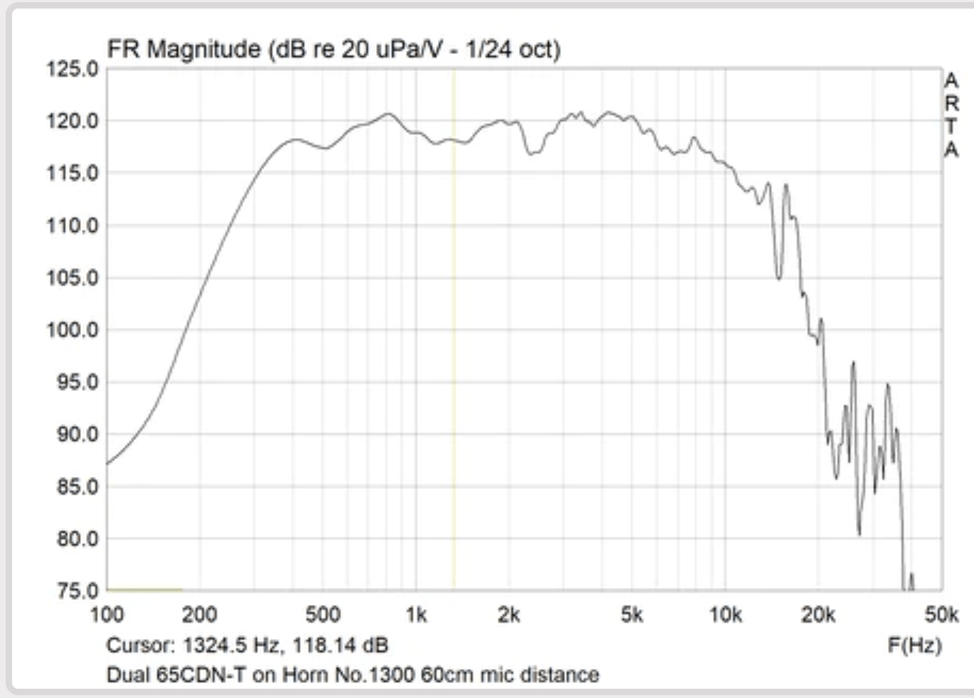

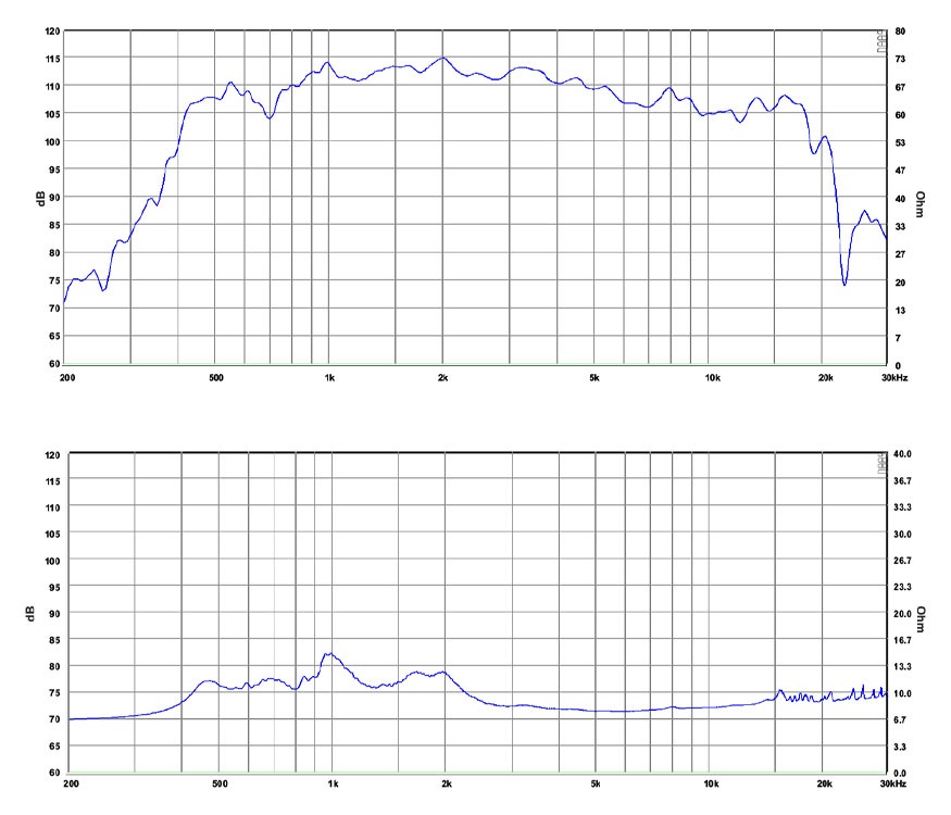

Attached are pics comparing the Crowe combiner with the "stock" response of a single compression driver alone. It's a bit of an "apples vs oranges" comparison because the waveguides are different, the Crowe device was measured at six tenths of a meter (not a meter) and the voltage level isn't specified.
