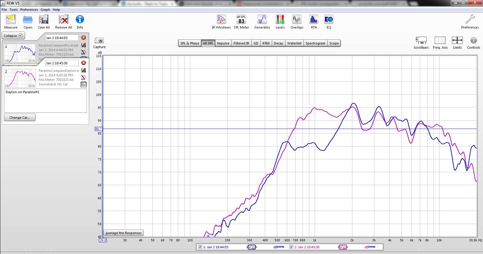

Patrick, I feel your pain but would have you look at the two measurements.
These are the raw responses for a Paraline element driven horn and an SH-50 horn, both driven by the same model driver (The Paraline had wider H, narrower V pattern horn).
These were at different times and places but taken in a more or less same way (TDS) and shown at 1/10 Octave smoothing (although the SH-50 was measured on a tower outdoors at 2meters at twice the Voltage and the Paraline at 1 Meter).
Now, guess which is which? Rather which one has a simpler shape curve to deal with?
A clue, on the white curve, the dip around 4500Hz, is the hf driver radiation exciting the mid drivers low pass filter, as the two driver ranges are coupled together still a little at 4500Hz, shorting the mid drivers terminals (or driving them in use) changes what that feature looks like.
Anyway, when made properly, a Paraline doesn’t need to have big peaks and dips and the Yellow curve for the Paraline response actually has a somewhat simpler shape than the conical. Keep in mind that if one wanted a system with flat response or drooped response with either system, the maximum sensitively is set by the hf end, in this case for Hi Fi say 16KHz or so. Everything below that has to be attenuated to get flat or whatever response shape.
If you have “excessive measurement grass” as opposed to large peaks and dips, see if averaging a number of measurements change the appearance because there are small differences from measurement to measurement. Impulse measurement systems are often limited here and averaging 5 or more sets (like if using ARTA) gives a better (less noisy) measurement.

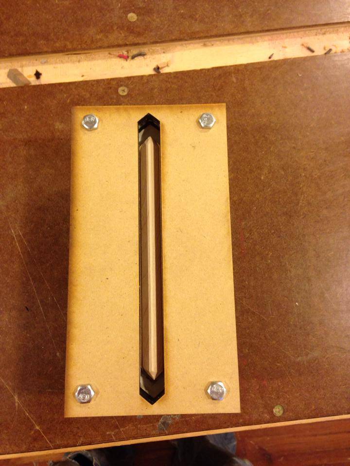

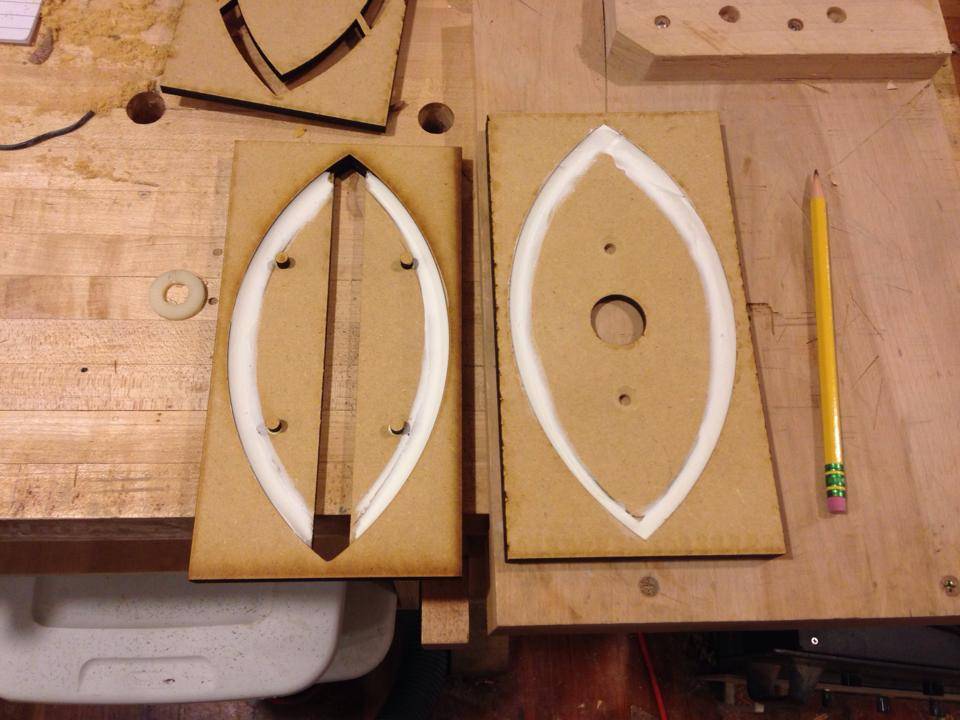

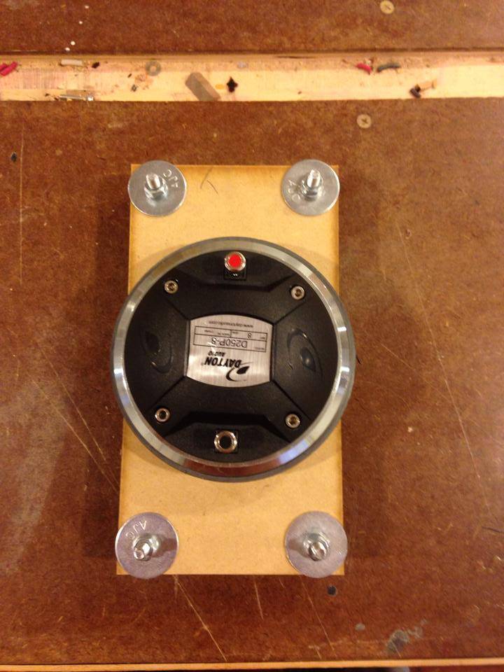

There are a couple “Things” that come to mind which you need to keep in mind. Make a drawing of what you built, make graph of the cross sectional area each say ¼ inch of progression away from the driver (the pressure waves view more or less). What you don’t want most of all is any portion where the area momentarily reduces and then expands, also not wanted is a portion that doesn’t expand longer than about ¼ inch. Ideally you have a nice expansion.
My first small Paraline prototypes were made from a stack of 5pc of 3/16" metal plates (the first one was plywood, 5 feet tall and the driver 90 degrees off axis to the exit, reminiscent of the old ATT&T microwave horn/reflector towers ).
Before I poured polyurethane into that Paraline on a hunch and sealed up all of the tiny cracks and pores, I was losing a bunch of high end and got a squirrely response at one end of it. These were already clamped together with 12 screws. Oh yeah, let the liquid drain out and then let it sit with a fan blowing on it for a couple days.
Later after that “Duh” moment, sealer was applied on assembly.

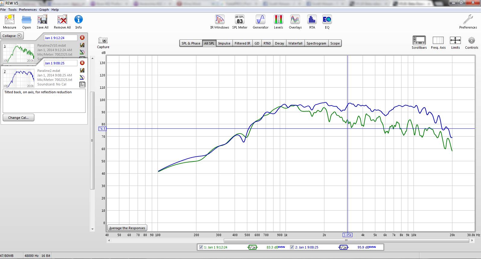

Here's a measurement of two QSC waveguides, and a car audio horn.
The car audio horn is dramatically rougher than the waveguides.
I'd thought this roughness was endemic to *all* narrow angle horns, and had thought that the roughness became worse as the wall angle narrowed.
And when I saw that repeating pattern of peaks and dips, it reminded me of what I was seeing in Paralines, so I drew a connection between the wall angle and the frequency response.
It looks like that is not the case.
Hopefully I don't get flamed for my NEW theory, which is that the roughness in the car audio horn is partially due to a reflection in the throat caused by a 90 degree bend. Along with a lack of termination in the horn.
More data here: http://www.diyaudio.com/forums/multi-way/247744-wide-angle-vs-narrow-angle-horns.html
* kudos to Nate Hansen for providing this measurement of a BMS based Paraline earlier in the thread
The car horn is not really a "narrow angle horn", it is more of an abortive emulation of the old EV 8HD diffraction horn.The car audio horn is dramatically rougher than the waveguides.
The right angle throat reflections and reflections at the bent mouth effectively insure the horn would have a terrible response on any axis of measurement.
There's something strange here, in that you continue plugging away but do not seem to grasp things very well. I'm not sure what it is- this is not meant as an attack, but just an expression of confusion. With thousands of posts on horns, you don't anticipate the garbage horn with a 90 degree kink and no meaningful mouth termination having ****-poor response? Heck, you've measured it before! And the mockups you build with extremely rough walls and whatnot... um what?
Is it a game? If so, you're winning.

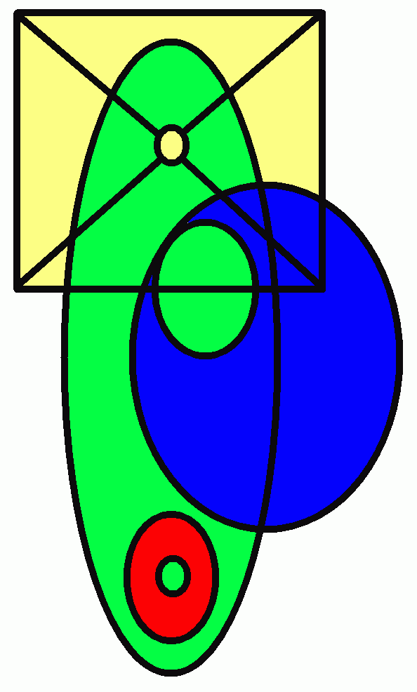

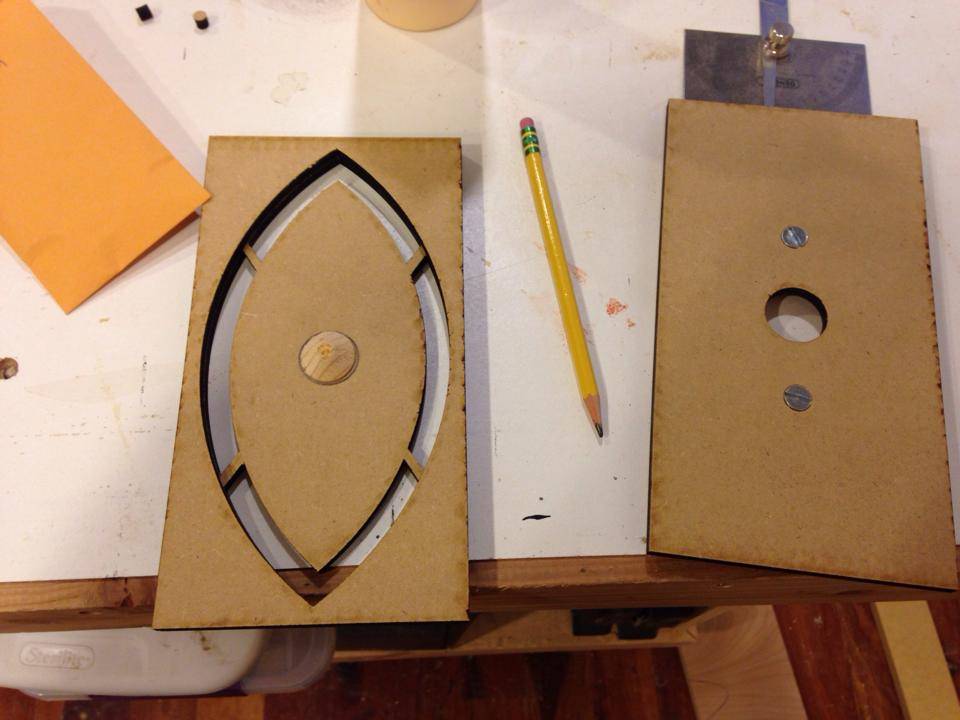

An ellipse has two focal points inside...
A flat ellipse has 4 potential ports of focused entry or exit...
You could add woofer in the middle somewhere and maybe not
disrupt highs moving through, I mean if the bass tap wasn't in
focus...
Ellipse has a history of another very loud and bright application,
we won't go there...
focus...
Like suppose this ellipse stood in for a plane wave tube.
Except the bass tap can now be hidden from focus.
And because the true impedance in the middle is less
compressed, maybe the taphole leaks less treble too.
Or suppose we put two full range on either side of one
focus and the horn throat at the other...
If you are crazy you could have two horns pointed
opposite ways... Not that you would want to...
Just sayin' it makes an unusual option available
cause the drive is not behind the horn but at the
other focus...
If the horn and CD are on the front face of the ellipse,
the entire back face of the ellipse can be for mids or
woofer. Clearance for much bigger than I drew.
Should the horn throat hole be larger than the CD
hole? To fake like the throat has expanded? Or we
risk turning this to a ring radiator if the throat hole
for the horn is presented that way.
other focus...
So I thought I'd give it a 2'nd try.
About a year ago I tried a 22" tall paraline with two 5.25" PA130 mids and a Dayton compression driver.
It didn't work well at all.
I did it wrong.
I decided to give it another go. I have access to a laser cutter at work...so I used it to make the fundamental pieces for an 8" paraline.
I used REW for measurements under very non-ideal conditions (sitting on a crowded work bench angled back to avoid that first reflection off the bench). I've still got some early reflections in these measurements and I've smoothed them at 1/24 octave.
Critical points.
1. I used caulk to make 45 degree reflectors at the edges.
2. I used a 45 degree reflector at entry and exit. (These are musts)
3. I braced the center part against the front using small off-cuts. (this one may not be as critical.)
I'm full speed ahead with a full speaker based on these...they turned out pretty good I think.
I did it wrong.
Critical points.
So, I just got in some PRV D280's to try on the paralines...completely different response.
I built two paralines, put a Dayton polyimide driver on one...and a PRV on the other...then swapped paralines/drivers same answer.
Folks more experienced with compression drivers...care to explain the difference?
Both are more than usable in my intended application...it's just the PRV will take a lot more crossover complexity to get there.
Scott
Scott
Scott
Horns are resonant devices. If you have two horns of equal length, and one horn is smaller than the other, the peaks in the second horn will be more prominent. You can see this in hornresp; if you make a horn very small it's response becomes very peaky.
One way to combat the peaks in a horn is to increase motor force. For instance, if you take two horns and you power one with a driver that has a BL of 20 it will be less peaky than if you drive the same horn with a driver that has a BL of 10.
This is one of the reasons that prosound drivers often have motors that are more substantial than what you'd find in a driver intended for a sealed box.
If you look at the PRV and the Dayton, the Dayton has a much larger motor. And I think that's why the response of the PRV is peakier.
I thought the dayton and prv were the same driver. Looked the same on ebay. One is bolt on & the other screw on
