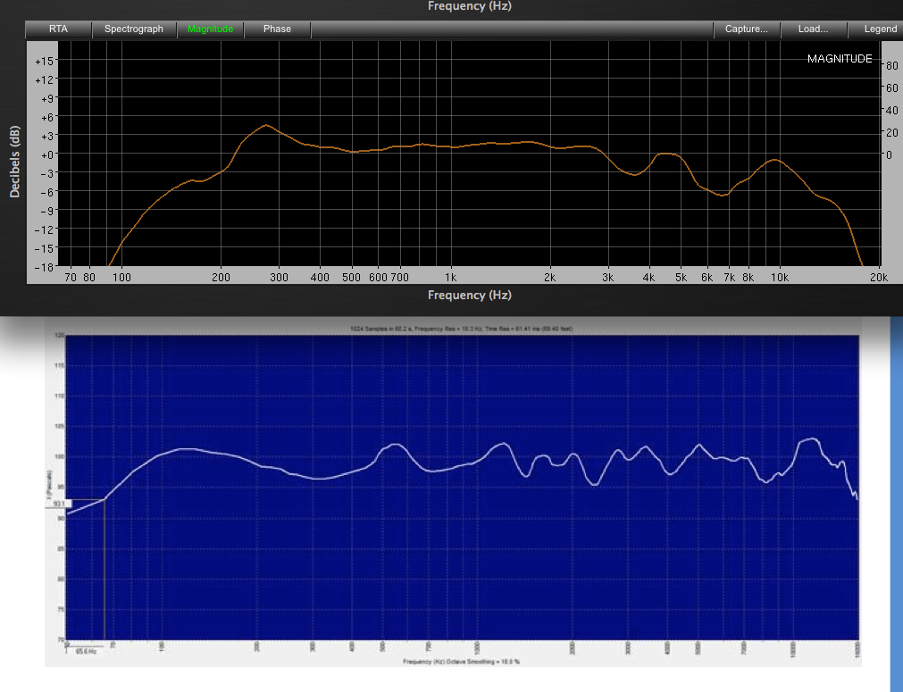

I recently redid the Dirty Dozen line array using 25 cent Jamo buyout speakers.
No crossover, just dirt cheap speakers wired in series parallel.
Though the response does not go as low or high, it is in general considerably smoother on axis than the SBH-10.
The charts below show the Dirty Dozen on above the SBH-10, the vertical scale is the same.
DSL has not "solved" the frequency response problems inherent in the Paraline, but has made them more tolerable.

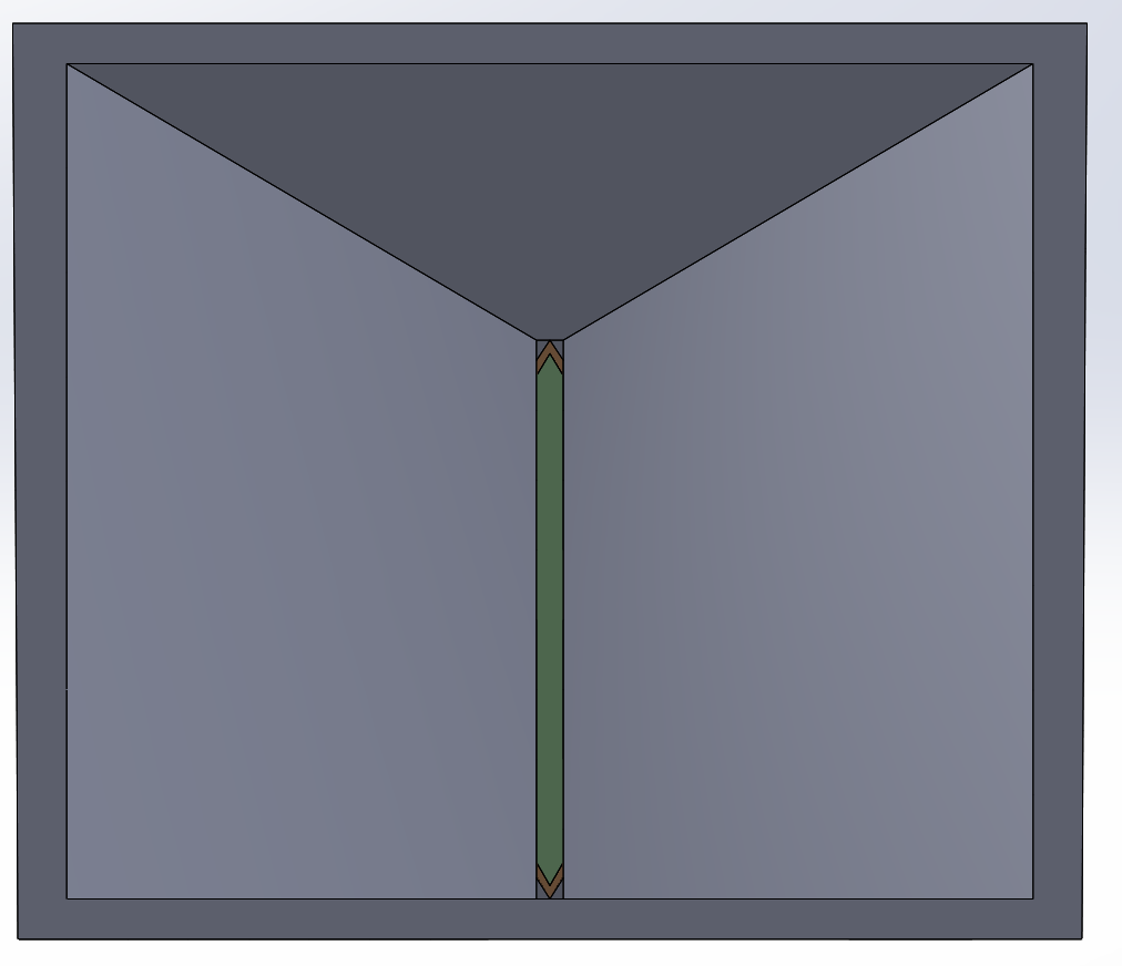

I wouldn´t mind trying a paraline synergy horn, and would be willing to do some 3d printing or CNC to get the parts right. I have been playing around with parabolics in CAD the last few days, so let me see if I get it right:
You can basically create any "shape" wavefront as you want (in one axis), and it doesn´t have to be symmetrical. If I understand you correctly (forgot which post you mentioned it in, so please correct me if I misinterpret) Patrick, any curved wavefront variant will be less plagued with resonances than one without.

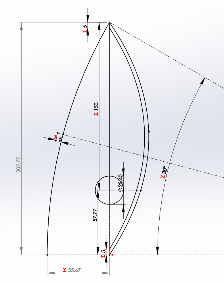

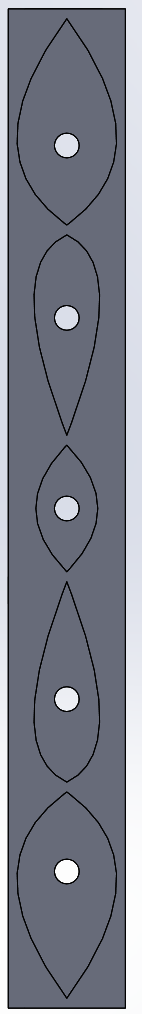

So the idea is to be able to create a horn that is parallel to the floor on the bottom, and 30 degrees vertical directivity, combined with 60 degrees horizontal directivity. The reason is that the horn would be placed low, perhaps on top of a bass bin.
The shape I have used is like this, with somewhat arbitrary figures right now: 5 mm layer depth, 150mm path length to exit (to top of paraline), 30 degrees wavefront on the vertical axis.

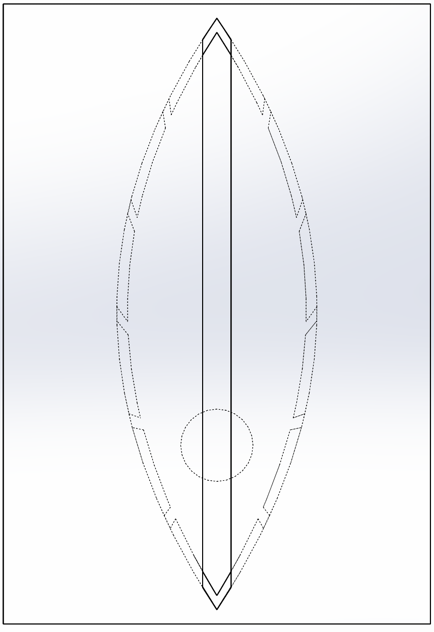

This turns into a paraline shaped like this:
The width of the exit slot is set to 2x layer depth.

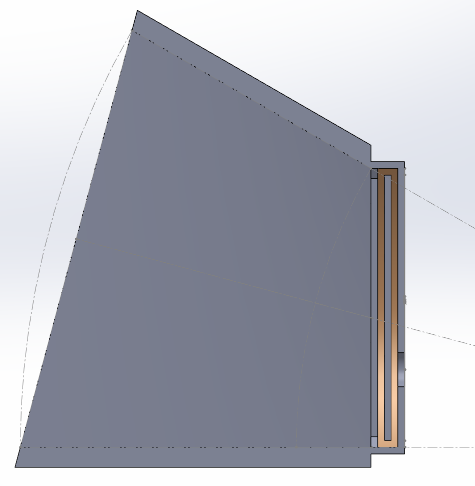

Seen from the side, this should give the a wave front like this:
And such a horn shape should be possible:

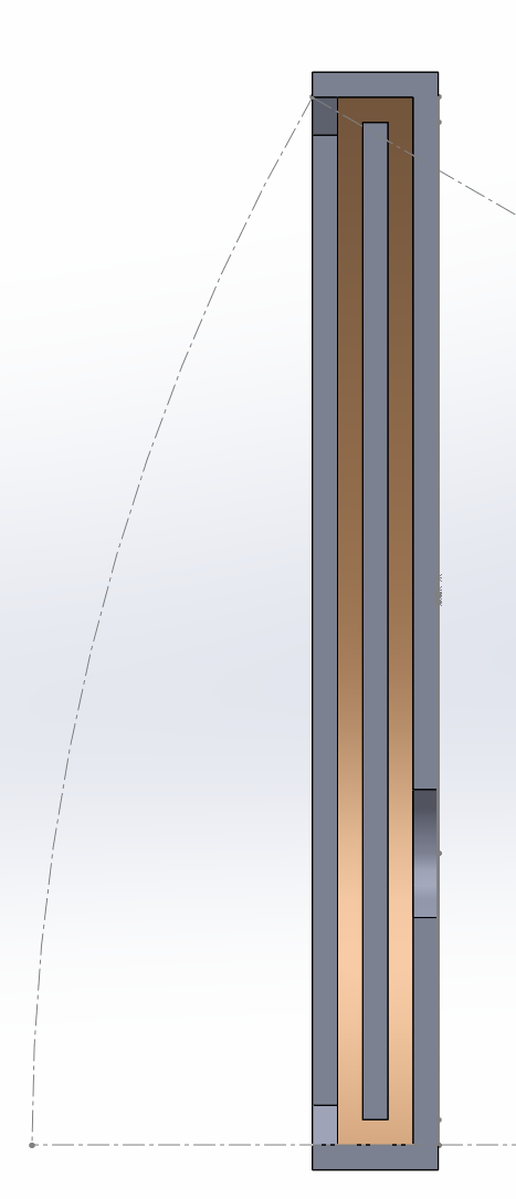

And seen from the front:
I did not do any akabak simulations, calculate the required horn depth etc so far. What i´m looking for is for the experts in here to say whether or not I completely misunderstood the concept, and if not (i hope!) whether it´s worth building on.
If resonances (leading to jagged response) is a function of several equal distances, then this version should perhaps reduce that and spread resonances over a wider bandwidth. I didn´t fully build draw the paraline (missing reflectors etc) nor the horn (no anti-waistbanding flare), but wanted some feedback before continuing. Keeping everything parametric, so that it can easily be modified by changing values rather than redrawing everything.
