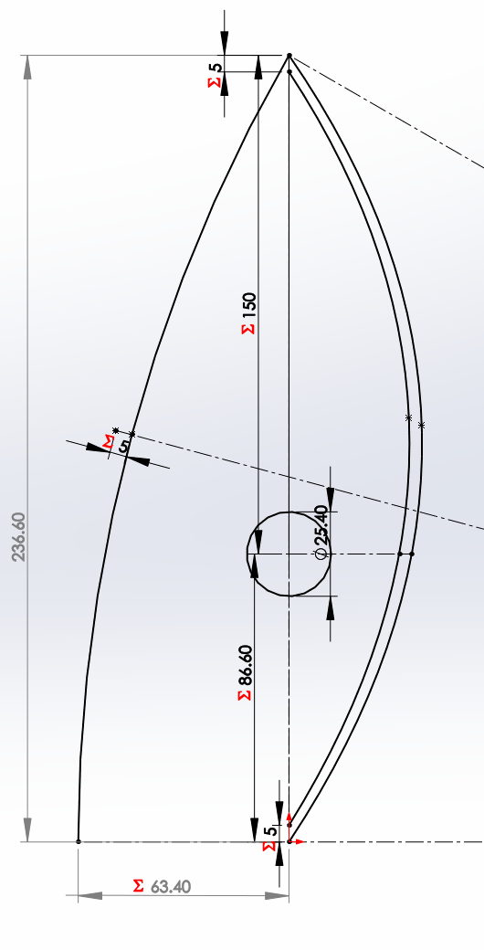

The Paraline has been a frustrating project for me, because it seems to have so much potential, and it's so elegant, but the frequency response is just so ugly.
And I've tried SO many things to make the response better:
1) I've tried improving my construction technique
2) I've tried painting the inside, to smooth the surface, as Danley mentioned that a rough surface would reduce SPL
3) I've tried big Paralines
4) I've tried ribbons
5) I've tried domes
6) I've tried compression drivers
7) I've tried small Paralines
8) I've tried alternate geometries, like my 'Squar-a-line' and my half-a-para-line named 'Stargate.'
Nothing seemed to make a difference.
But a huge light bulb just went off over my head, based on a comment that JLH made.
JLH noted that the spl output of the Jericho J3 is probably 'obscene'.
And I was going to chime in, because I've noticed that the output level of the conventional Synergy horns are close especially if they have narrow coverage.
But you can't have your cake and eat it too; the wide angle synergy horns have smoother frequency response. The narrower the angle is, the worse the frequency response is.
Long story short - perhaps the ragged frequency response has as much to do with the coverage angle as the reflector. Perhaps very narrow angle horns are naturally rougher in response than wide angle horns.

Narrow angle horns are not naturally rougher in response than wide angle horns. No perhaps, not.
My 13 degree Maltese conical horn has a very smooth response, the same driver on a 90 degree Paraline has ragged response.
I have posted the comparison several times before in your parallel universe of perverse posts, you seem to forget and repeat the same false conclusion repeatedly 😉.
Putting large port holes in a narrow horn cause more HF ripple than a wide angle horn simply because the area of interference is larger in relationship to the horn wall area.

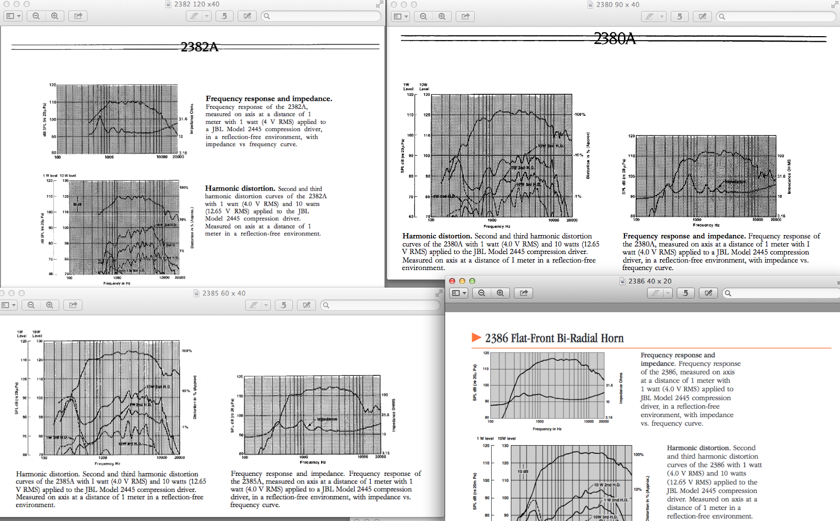

As we have mentioned, there won't be a (direct) connection between angle and smoothness.
Looking at the JBL 2380 series of diffraction horns, all of which are the same frontal size and depth, other than the much deeper 2386 40 x 20, we can see that dispersion angle is not an indicator of smoothness.
If anything, the narrower dispersion 2380 horns are smoother.

In a conical or OS type of waveguide, one could compare units with the same mouth size, with various wall angles, which of course would result in different depths.
