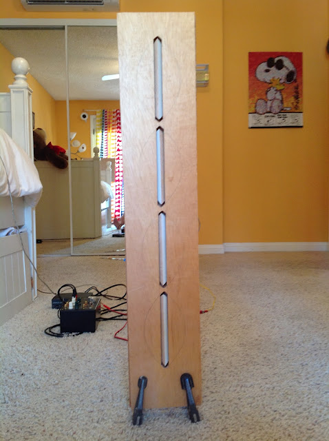

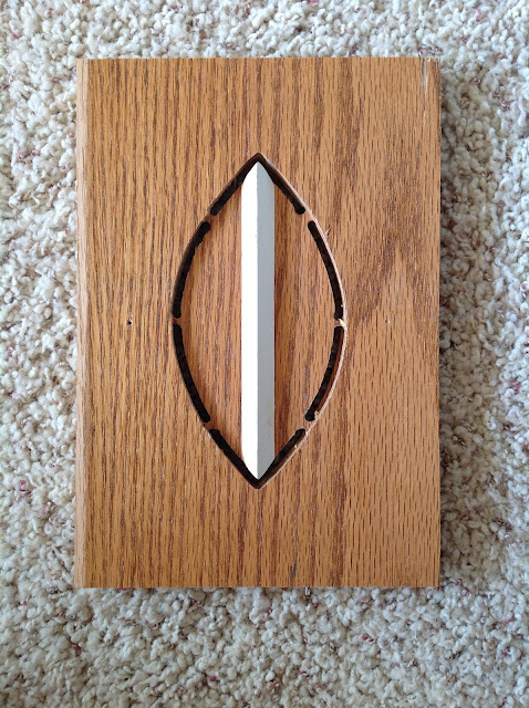

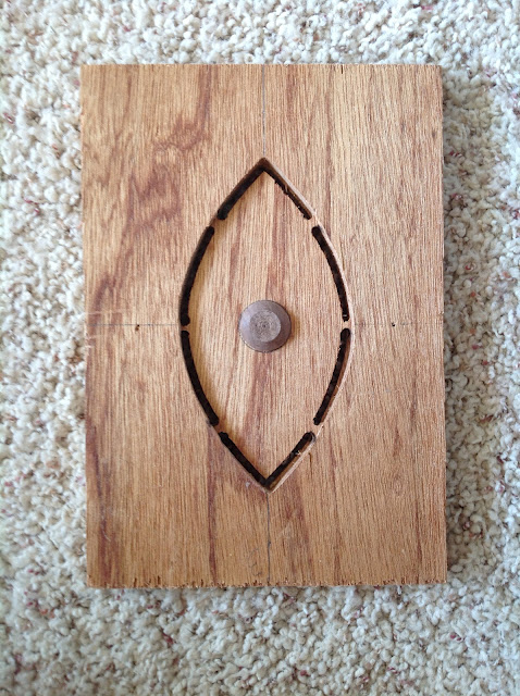

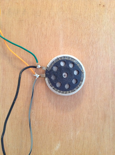

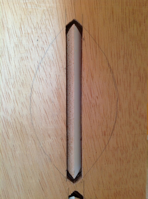

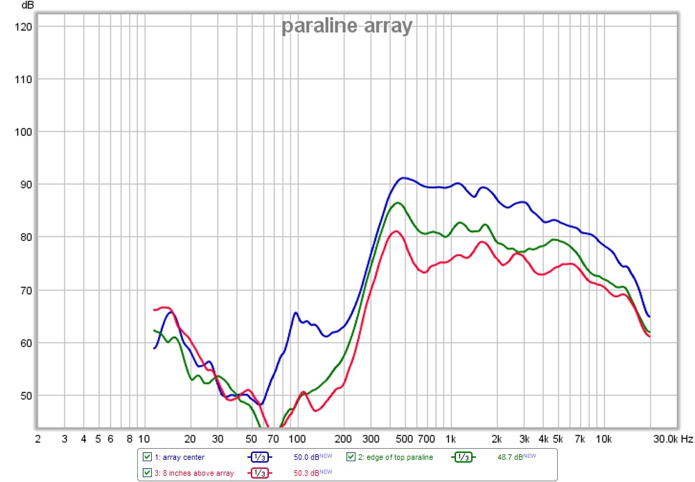

I have a bunch of sawafuji ribbon tweeters and decided to make a 4 paraline array to test how they work. I made an entry deflector that only deflects the radial holes from the tweeter, plugging the center hole. By using the paraline I will need a lot less tweeters (if I wanted to build a tall array). The one surprise is that the tweeter goes quite low. The vertical directivity is as predicted, big difference from the response in front of the array versus 8 inches on top of it. SPL levels up/down the array is constant so the paralines integrate well vertically. I attached some measurements although it is not a great setup as I want to stay air conditioned🙂.

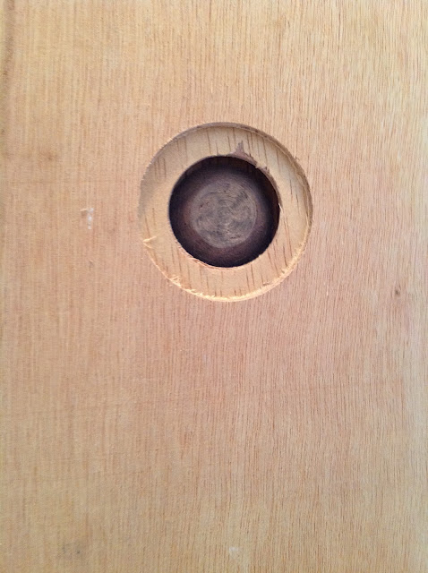

Building the paraline was not too difficult. I made a router template with indexing holes to repeat the cuts. I did a layer at a time. Next time I think it is easier and more precise to do the three eye layers at the same time.
In the end I cheated a little. I had made the template to use a 1/4 inch spiral bit which I did use, but I did not have enough 1/4 inch material to do it. I used 3/8 material instead. Also the front layer with the exit slot is not 3/8, it is 1/8 inch.
I want to try get some measurements with the array wedged into the corner and use the 90 degree wall as a horn.

WOW 🙂
Nice work, and I appreciate the measurements.

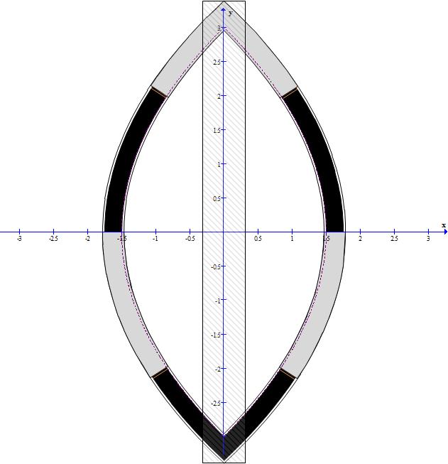

Forgot to mention that the two back layers of the paraline are also 1/8". The inner has a 1" hole which is exactly the diameter of the outer ring of holes of the tweeter. The outer layer has a hole of 1.5 inches, exactly the diameter of the tweeter so it is quite a nice fit.
I have attached the drawing I used to make the router template.

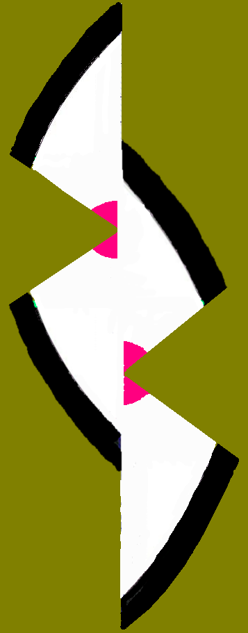

I'm just sayin' try the outer edge of the parabola only.
Avoid the "round" part near the middle.
Why? Cause middle part is all nearly the same reflection
distance back toward the driver. Maybe aggrivates dips?
Anyways, also thinkin you might fold this down the
centerline, and then drivers would be on opposite sides,
instead of crowding each other.
Aplologies to drawing above, I totally butchered it...

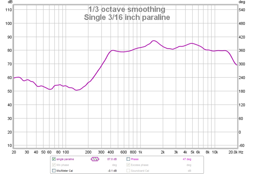

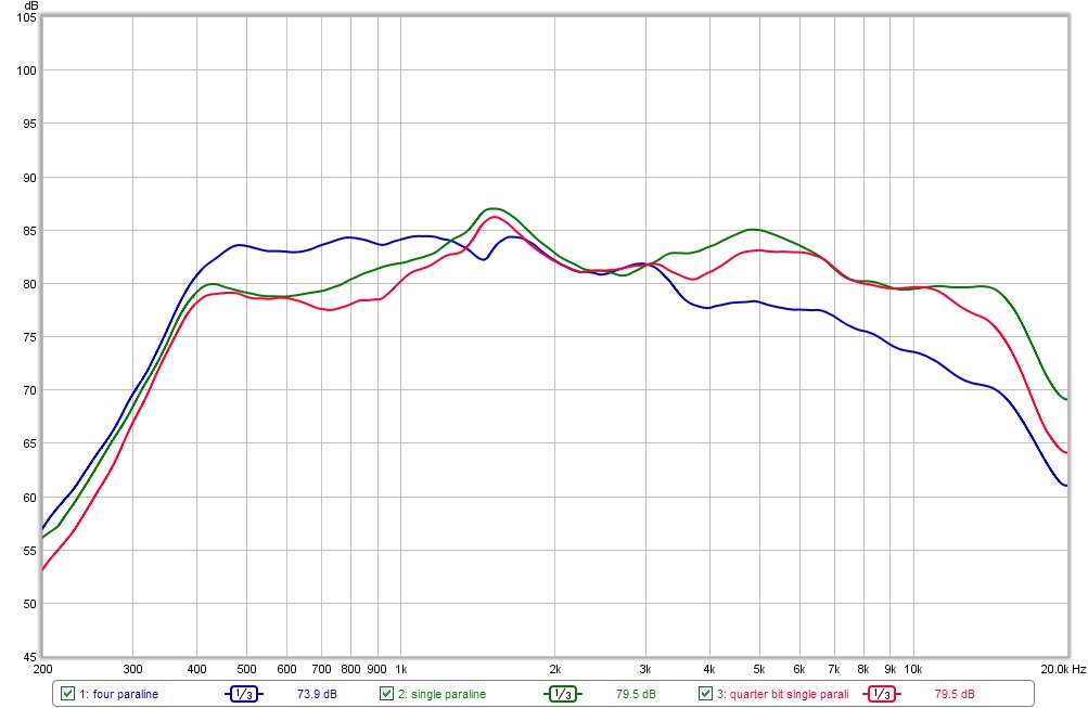

I made a single paraline but this time it is all 3/16 to see if the HF improved. Indeed it did, but peaks around 1.5k and 4.5k are prominent. I wonder if these are related to the length of the paraline whose fold is 3 inches long per side. Wavelength of 1.5K is 9 inches, 4.5K is 3 inches. Is this a resonant mode? Maybe it is just a coincidence.
Ok, so I ran another test to see the individual FR of the original paraline used in the array. Both single paralines show the bumps. The 3/16 paraline shows extended HF. 3/16 router bit vs 1/4 router bit.
Also, the interaction between the paralines in the array is lowering the HF and bringing up the mids. I don't have any experience with arrays so I can't explain what may be happening. What happens to the phase as you go from the the center of the slot to the ends?
