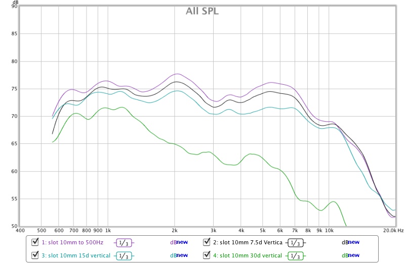

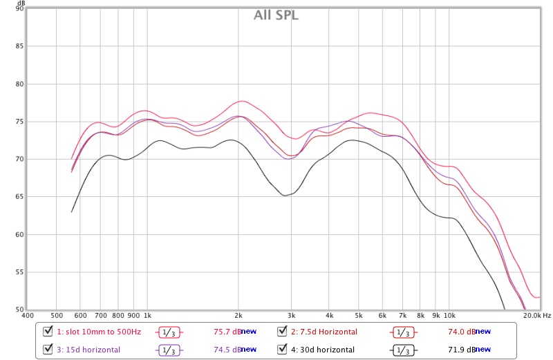

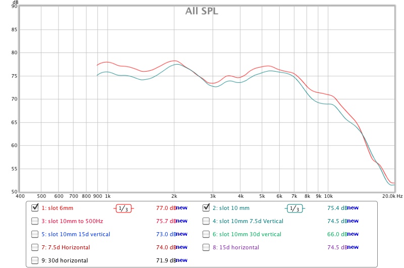

Last weekend, I build a Paraline with 20 centimeter height and 4.34 cm wide (30 degree vertical) with 3mm thick acrylic and put B&C DE500 as tweeter.
Since, I don't understand how to calculate the wide of the opening slot, so I made some experiment. Here is the result. Opening slot is 20 centimeter long with 6mm wide and 10 mm wide. Seem to result in the same shape except 10 mm lost some dB.
Measure with REW, indoor, gate 8ms

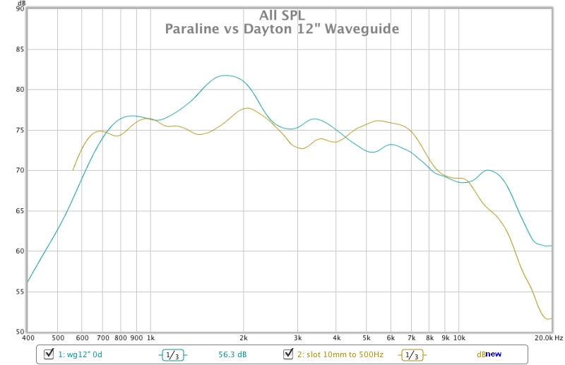

Getting a good HF response seems to be the real difficulty with the Paraline. You mentioned using 3mm thick acrylic. That means the height of each chamber/channel in the paraline is 3mm in your build?

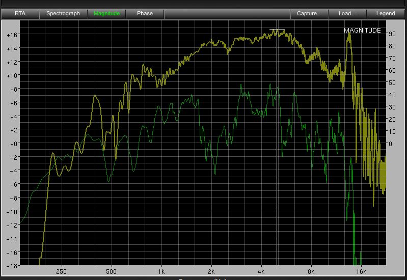

Received my BMS 4524 compression drivers today. I mounted it to a .5" piece of mdf with a 1" hole bored in it, and clamped this to my Paraline. The hole is centered with the Paraline. Still no reflector at the driver throat, and there aren't any midrange holes yet on this mounting plate. Gonna be some diffraction from my clamps probably, but here's 0-15-30-45-60 at about 1 meter. I was excited to hear a "real" compression driver finally! I'm pretty happy with the result. Eq to get it flat out through the top octave is a piece of cake, with the response falling sharply at 17.5khz as expected. That's about as high as I can hear anyways.
Horizontal:
Vertical, I'm thinking this is a lot of pathlength cancellation. How do you measure a line source?

Your response curves look good.Vertical, I'm thinking this is a lot of pathlength cancellation. How do you measure a line source?
Hopefully I'll get going on the conical horn prototype tomorrow.
Ideally you measure in the far field, far enough out so that the up/down angle will still result in less than 1/4 wavelength path length difference between the on axis and off axis response.
If you use a different time window (using Smaart the "auto sm") for each test as the horn is rotated, the path length difference will be compensated for.
Unfortunately, ground bounce is a measurement problem in the far field, so the horn is best pointed up in open air.

Sure would be nice to see a baseline response curve on the compression driver to see what the paraline is doing to the frequency response. This just looks pretty ragged for a compression driver.
The Paraline is not particularly smooth, but has outstanding horizontal dispersion linearity on and off axis, and very narrow vertical pattern control, allowing multiple drivers to sum seamlessly.Sure would be nice to see a baseline response curve on the compression driver to see what the paraline is doing to the frequency response. This just looks pretty ragged for a compression driver.
The upper trace is a EV DH1A on a conical Maltese horn, the lower is a DH1AMT on a Paraline.
The driver's raw response may deviate slightly from each other, but the Paraline obviously does not appear nearly as "smooth".
Having replaced the Maltese horns with Paralines in my PA, the Paraline's response in multiples, after EQ, is far superior.
That said, I see no benefit (and many down sides) of the Paraline over a simple conical horn (as used in DSL's Synergy horns) for home use.
