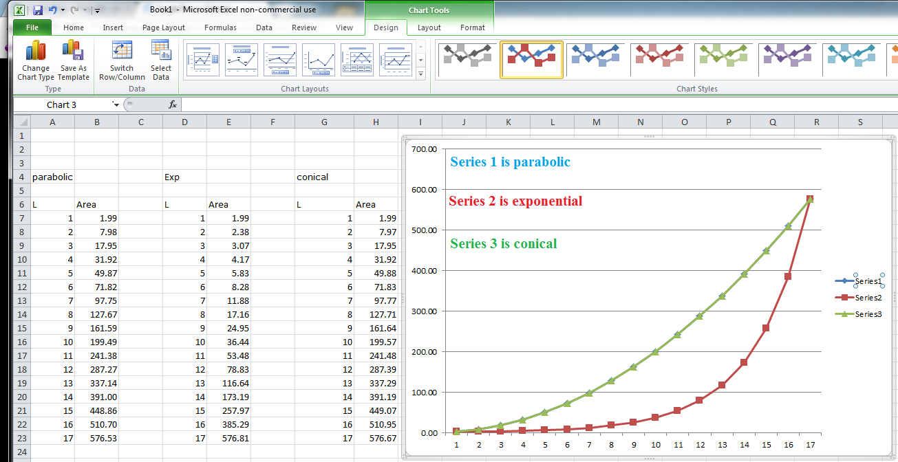

Out of my own curiosity I decided to compare the parabolic, exponential, and conical profiles. I started with the same throat areas and ended with approximately the same mouth areas along the same distances. I overlaid the three to see how close they were to each other. The parabolic and conical practically lay on top of each other. The exponential deviates from the other two by quite a bit. This is what I meant when I said the paraline approximates the conical profile. Go ahead and try this yourself. I was actually surprised how close the parabolic and conical are. I double and triple checked my calculations to be sure before I posted this. Nothing like looking like a fool in front of the whole internet. 🙂 I think we are dealing with a situation where these line up closely due to the areas and distances we are working with. If you extend these out to a more extreme example, I think you would start to see them separate. This is very much like how the tractrix and exponential are impossible to distinguish from one another near the throat of the horn.
... Nothing like looking like a fool in front of the whole internet. 🙂 ...
Your apology is accepted. 🙂
.. but seriously, I see your point. "Approximately conic" is close enough.
