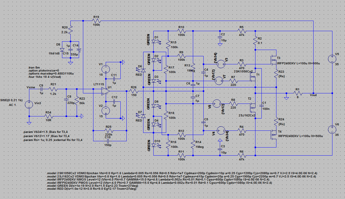

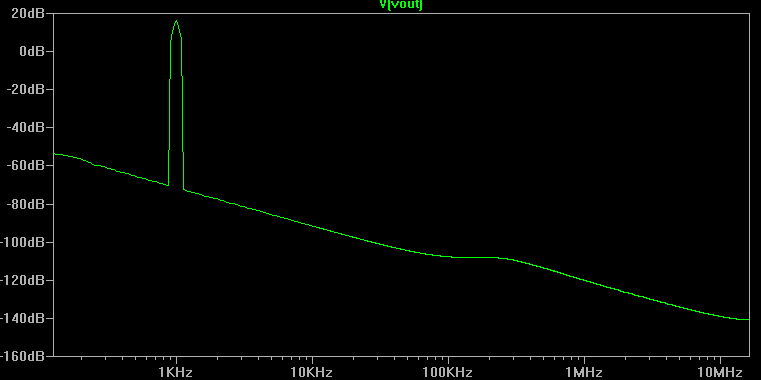

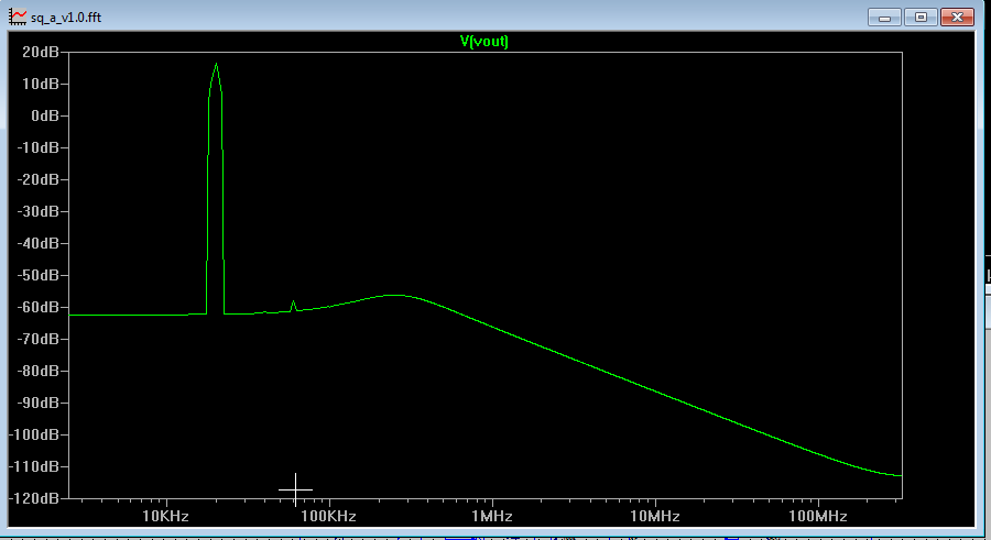

I added an opamp to the input stage, and lowered the DC offset. Simulation gives me the following performance:
THD @ 1kHz = 0.0028%
THD @ 20kHz = 0.022%
Not too bad for 50W Class-A?

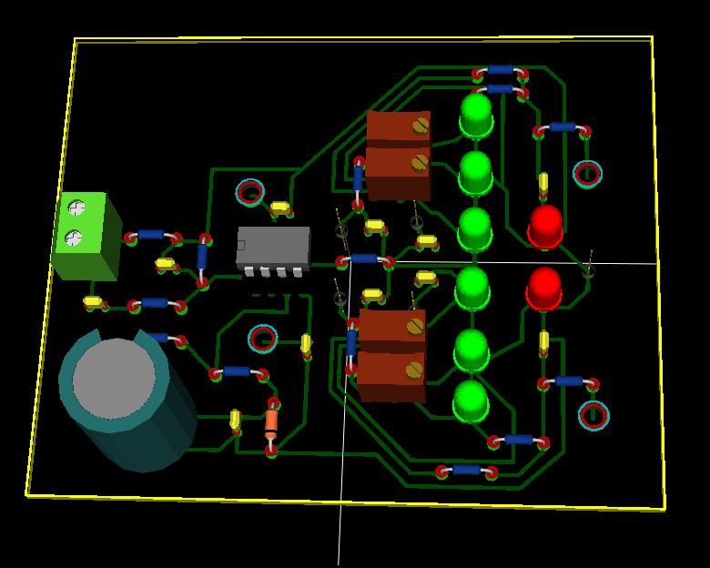

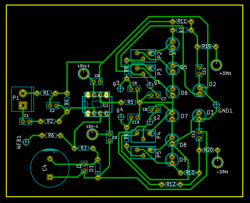

Bias & Input PCB
I've made my first attempt at creating a PCB for the input stage and bias circuit for Ian's Square Law Class A, as featured in Linear Audio Volume 1.
My plan is to create separate PCBs for the bias and output stages. The idea is that this will give more flexibility in mounting the output transistors to the required heatsink. This is basically the same approach that Ian took in the above mentioned article.
Attached are schematics for the entire circuit and also the input/bias module by itself. Attached are screen shots from Kicad showing the PCB for the input/bias. I will continue work on the output stage PCB.
Comments and helpful suggestions are appreciated.
