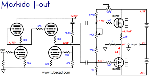

the idea comes from John Broskie and his TCJ Moskido I-out More Current-Output Amplifiers

I knew this site,
what I wanted to show
is an interesting output circuit with grounded sources/emmiters.
This of course makes relatively high output impedance
but
this makes current output which sounds so good (only peak resonances of the woofers/tweeters have to be dumped)😉

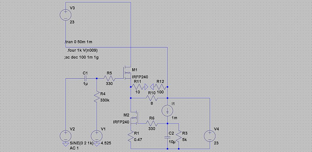

Ultra low on resistance MOS-FET 2SK1595 classA single power amplifier
At this output stage you can adjust between grounded emitter and emitter follower:
this one I forgot but looks very promissing,
thank you

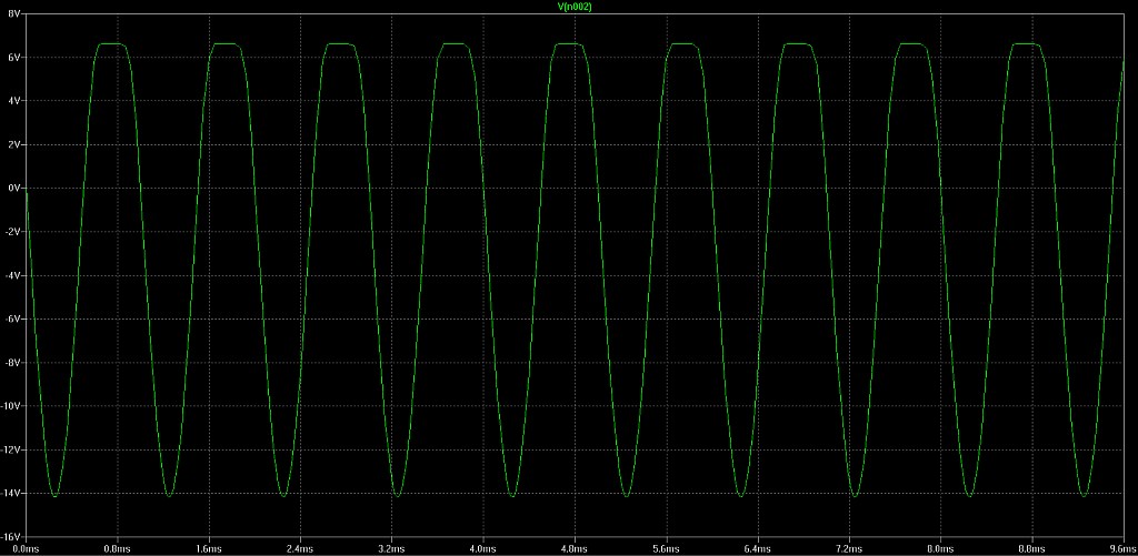

so why it clips positive sine halve @ +6,6V?
any ideas how to set it up?

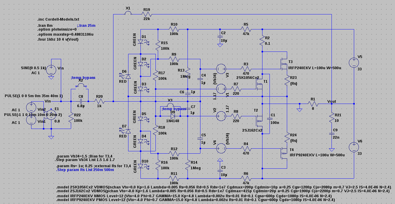

Ian Hegglun's Square Law Class A

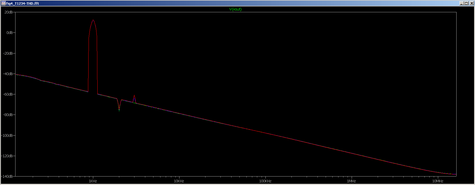

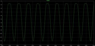

I've been in contact with Ian Hegglun and he helped me simulate figure 4 from his Linear Audio, Volume 1 article. Ian has also been very helpful answering questions in regard to this circuit. Ian's skill as a design engineer is very impressive; he's put a lot of good engineering practice and thought into his Square Law designs.
Attached are screen shots and LTSpice simulation files. Ian tweaked the EKV transistor models to simulate square law behavior. I'm also using some of Bob Cordell's models.
This circuit will be my next amp project.
Tiny currents of 150mA peak in T3 + T4 are square law class A.
But much bigger currents of 2A peak in T1+T2 are linear class A.

Which currents are these? With output signal? The bias currents should be much, much lower, so although the circuit 'works' like a class A circuit, the bias current (and thus the eficiency) is of a class AB circuit.

The bias current for T1, T2 is 1.13 A when I simulated it, so it is class AB but very deep one. For T3, T4 is 26 mA only. The power dissipation wile idling is 76W and this is not so low.
How to to thermally stabilize this combination of lateral and vertical MOSFET output transistors?
