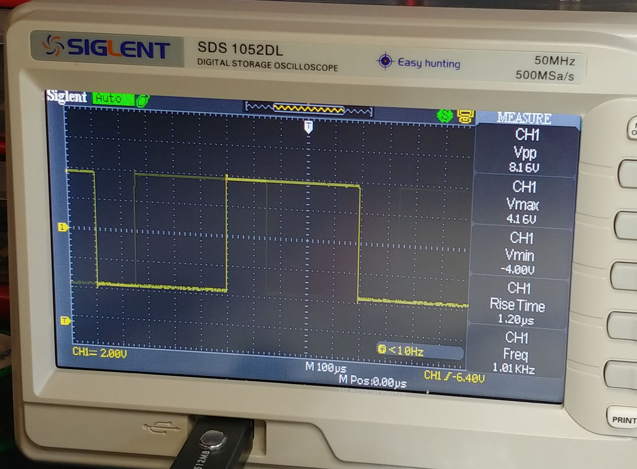

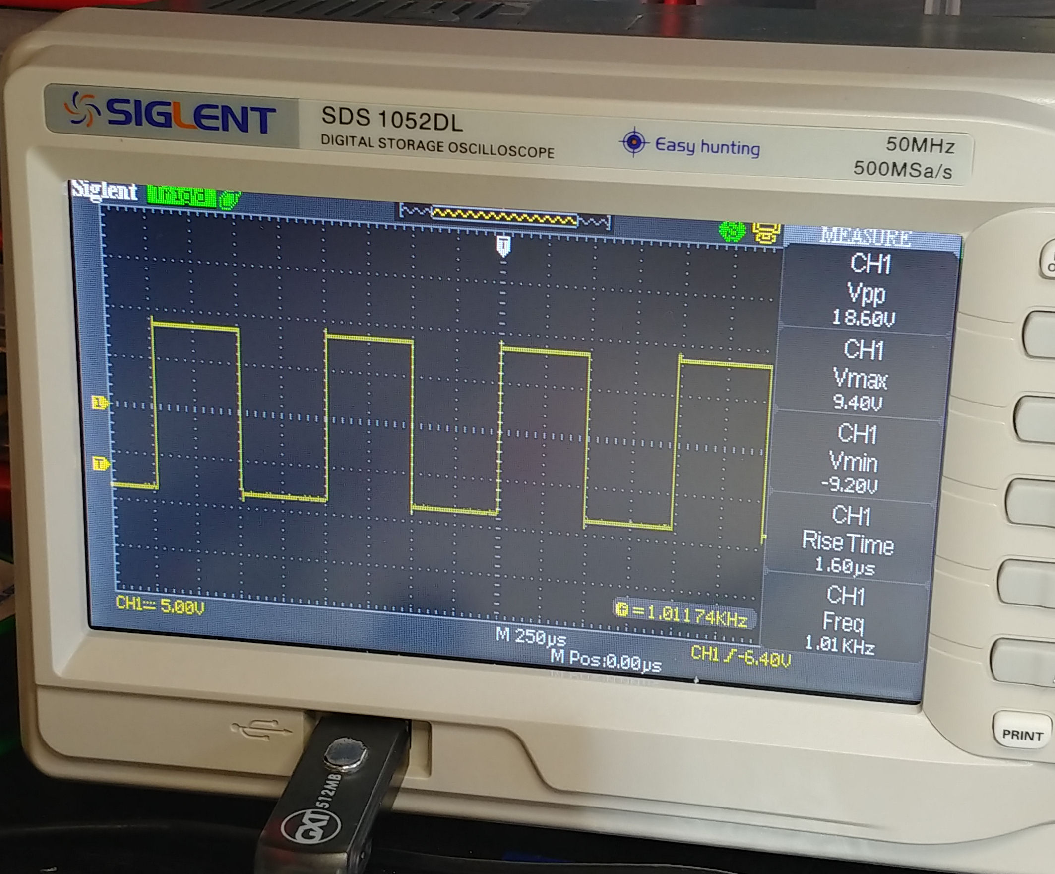

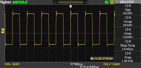

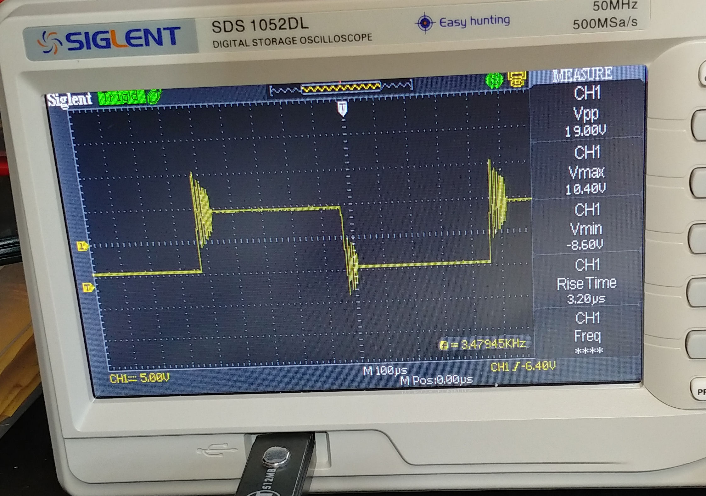

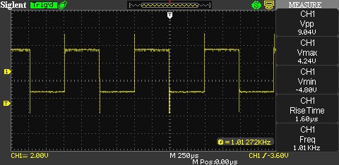

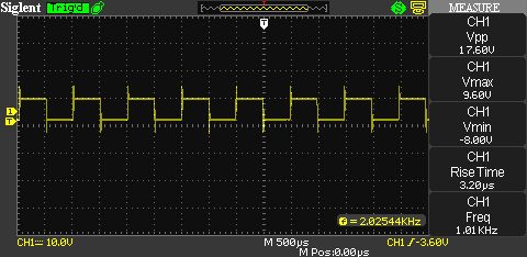

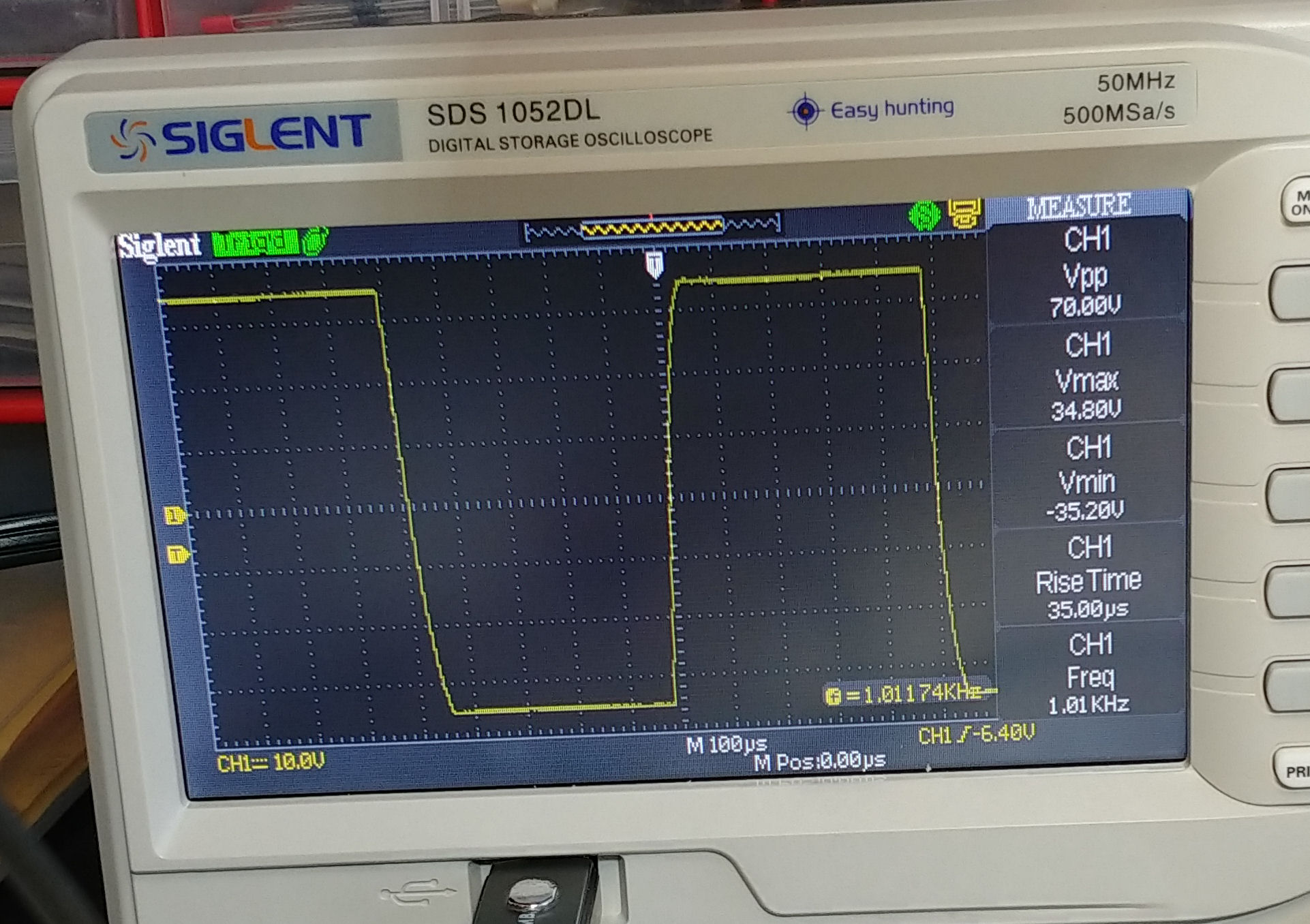

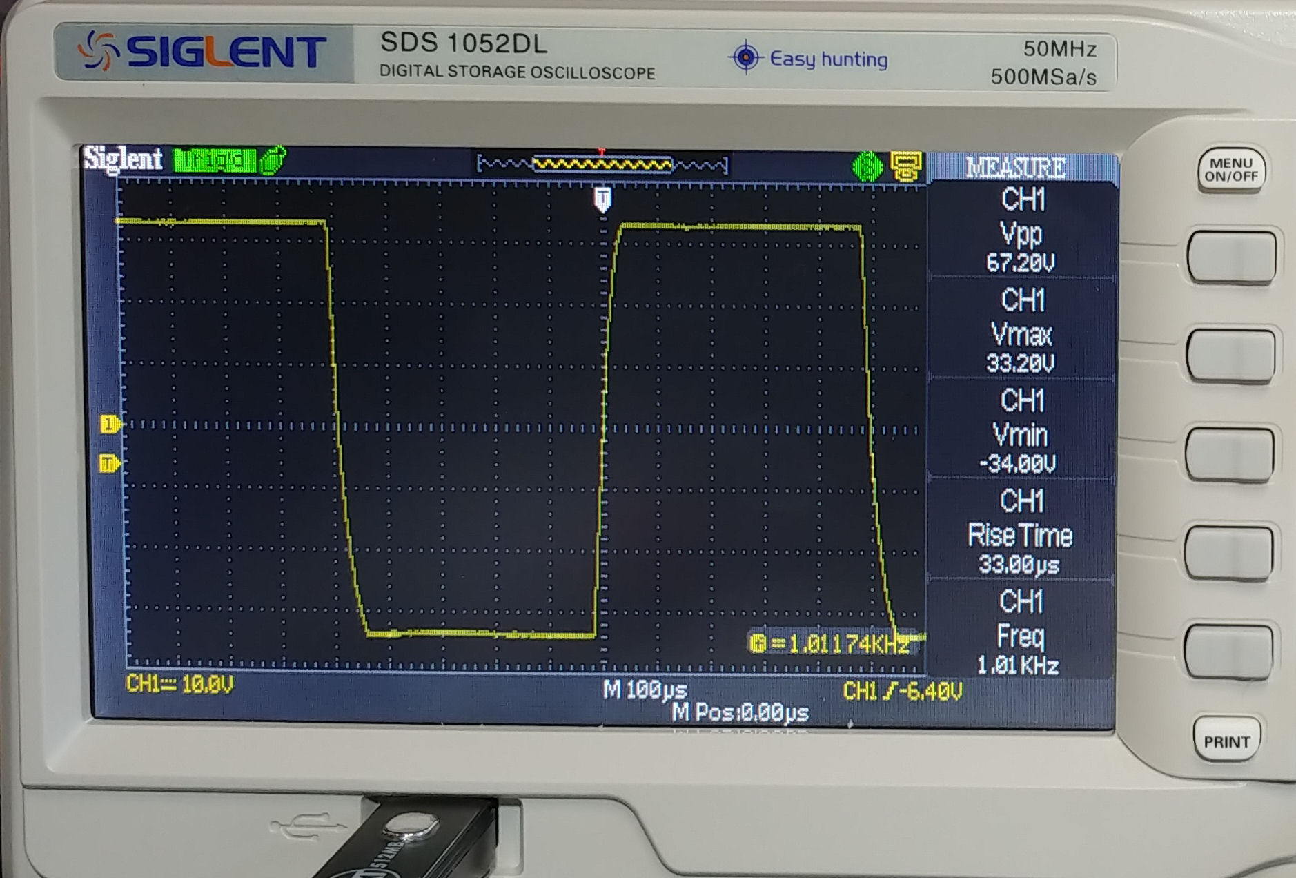

I tried 4 combinations so far. This is a lot of work (soldering/desoldering), because I'm working with pcb installed on chassis/heatsink..

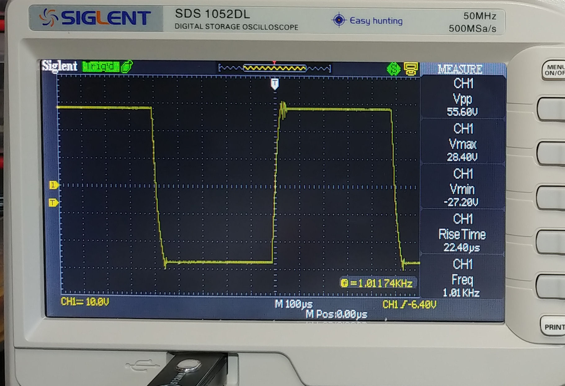

Here are results for 390 Ohm + 1n5 (load 8 Ohm).

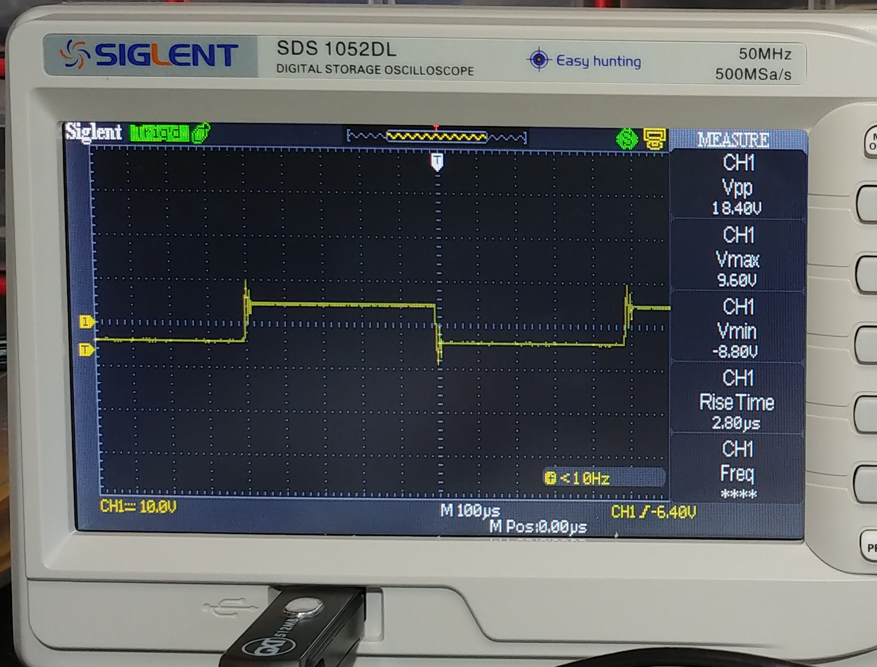

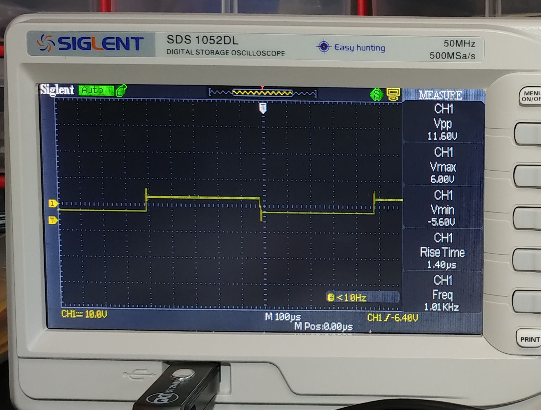

These are results for 270 Ohm + 1n5.
I also tried 270 Ohm + 1n, but amp was unstable and oscillating even without signal.
Taking photos with camera is much faster than using oscilloscope 'save screen' function.
Saving screen to usb takes 20s !!!
Looks like can't go lower with the 'C'. Perhaps should try lower R with 1n5 ?
Also - output Zobel is now 10 Ohm + 220nF for all today's tests.
Rails are 38V.

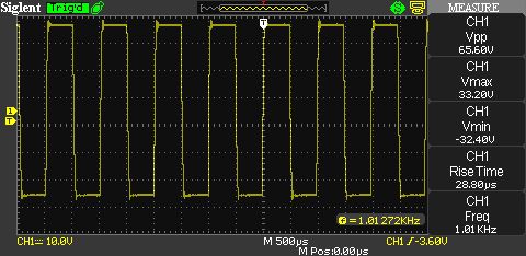

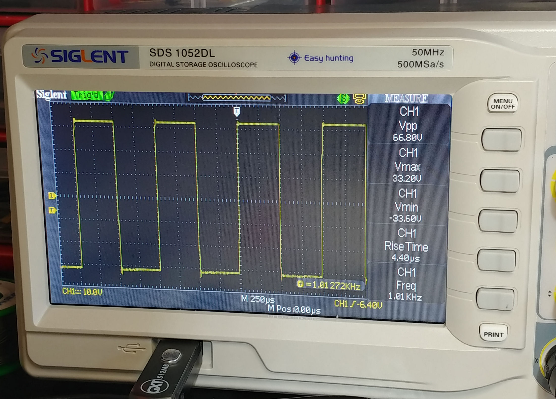

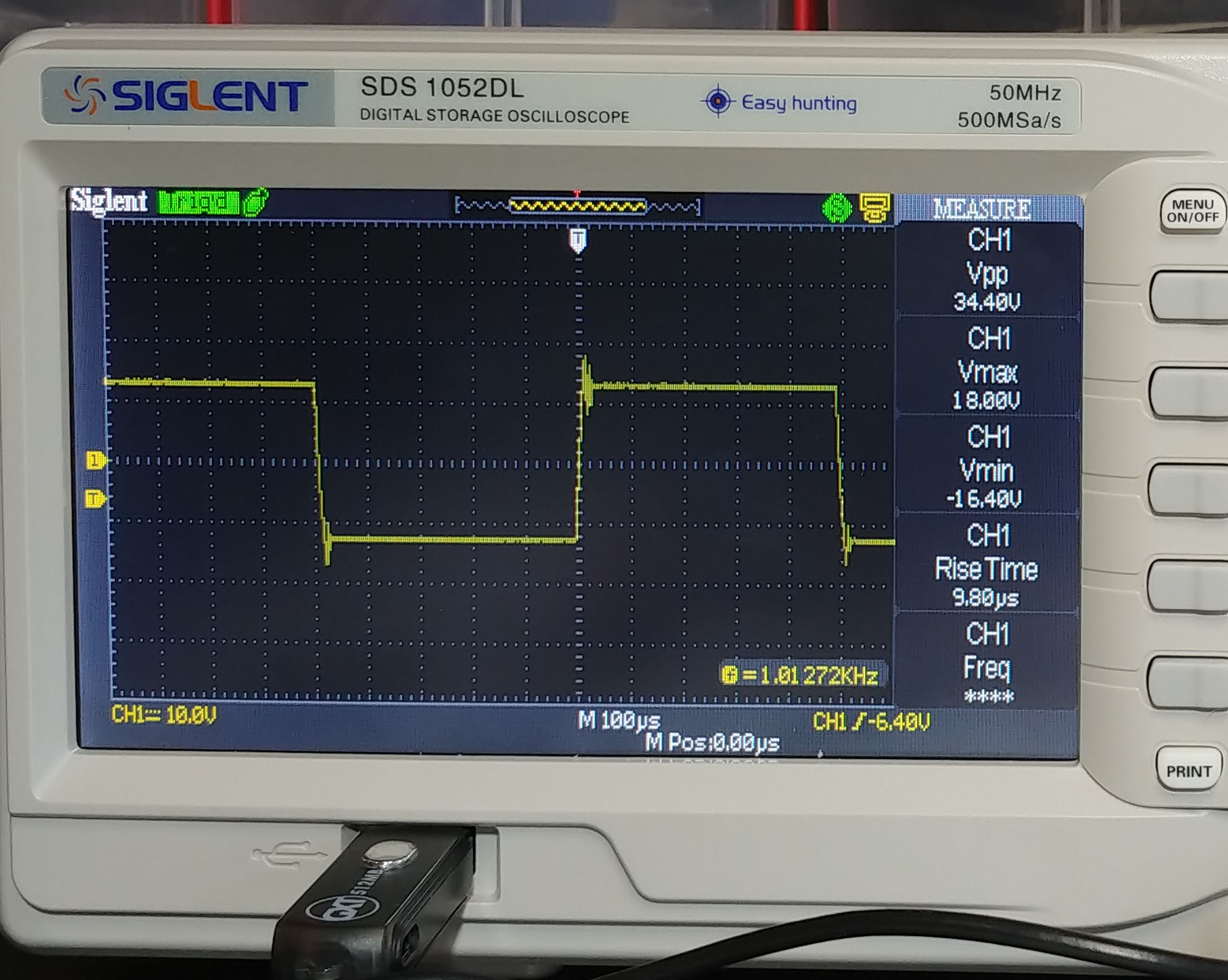

One more: 470 Ohm + 1n5
Higher R = Slower RS
This one looks the best to me, except for RS.
What I generally do in such a case is to install female socket strips instead of the critical components: you can then swap them easily and quicklyI tried 4 combinations so far. This is a lot of work (soldering/desoldering), because I'm working with pcb installed on chassis/heatsink.
Ideally, each time you change the cap value, you should also adjust the R value, because the RC product has changedLooks like can't go lower with the 'C'. Perhaps should try lower R with 1n5 ?
The ringing on the edges is not really acceptable. It should be reduced to a mere overshoot.One more: 470 Ohm + 1n5

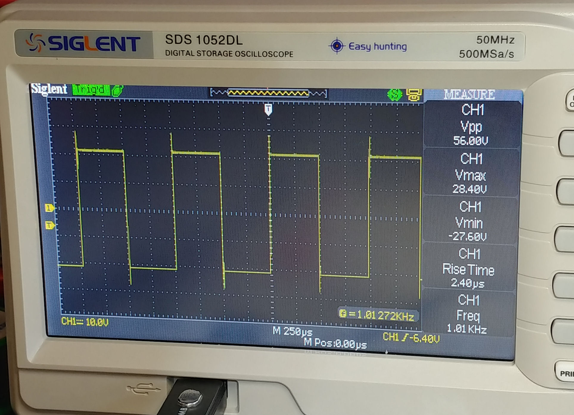

Some other ideas: bypass R1 and R23 with 4n7 caps, to eliminate the parasitic pole they generate;
install your RC networks across R14 and R17 instead of D-G: it will include the driver in the compensation.
You could also try to compensate U1 with a light RC network

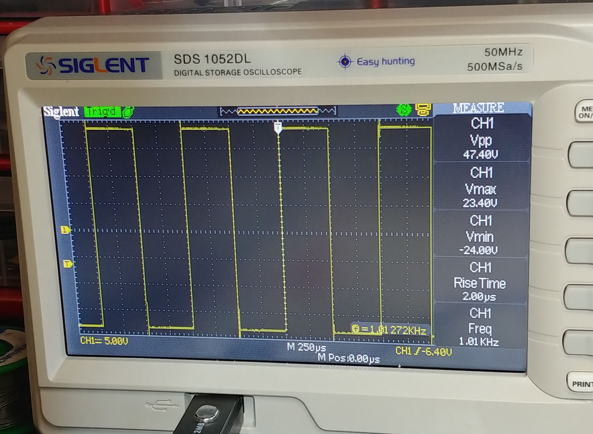

Did exactly what you said, and here are the results.
RC is 270 + 1n5.
Huge improvement.
Even slew rate is acceptable (but barely..).
Let me know if you ever come to NY..
RC is 270 + 1n5.
Huge improvement.

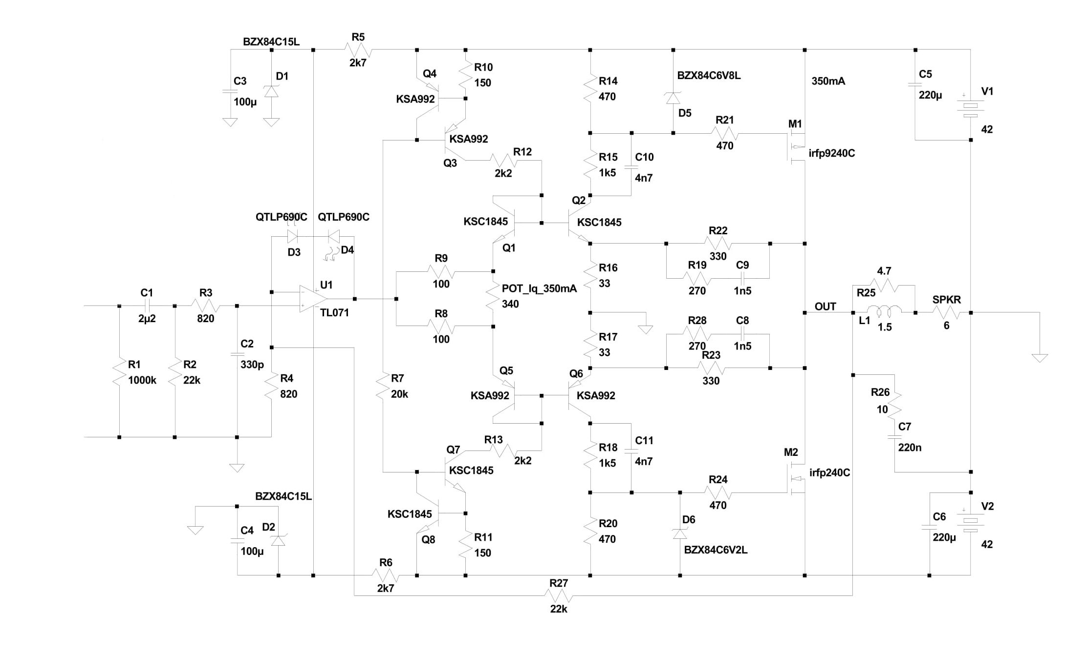

This is the latest schematic so far.
The numbering of all parts has been changed (compared with previous schematics), previously the numbers were kind of random...

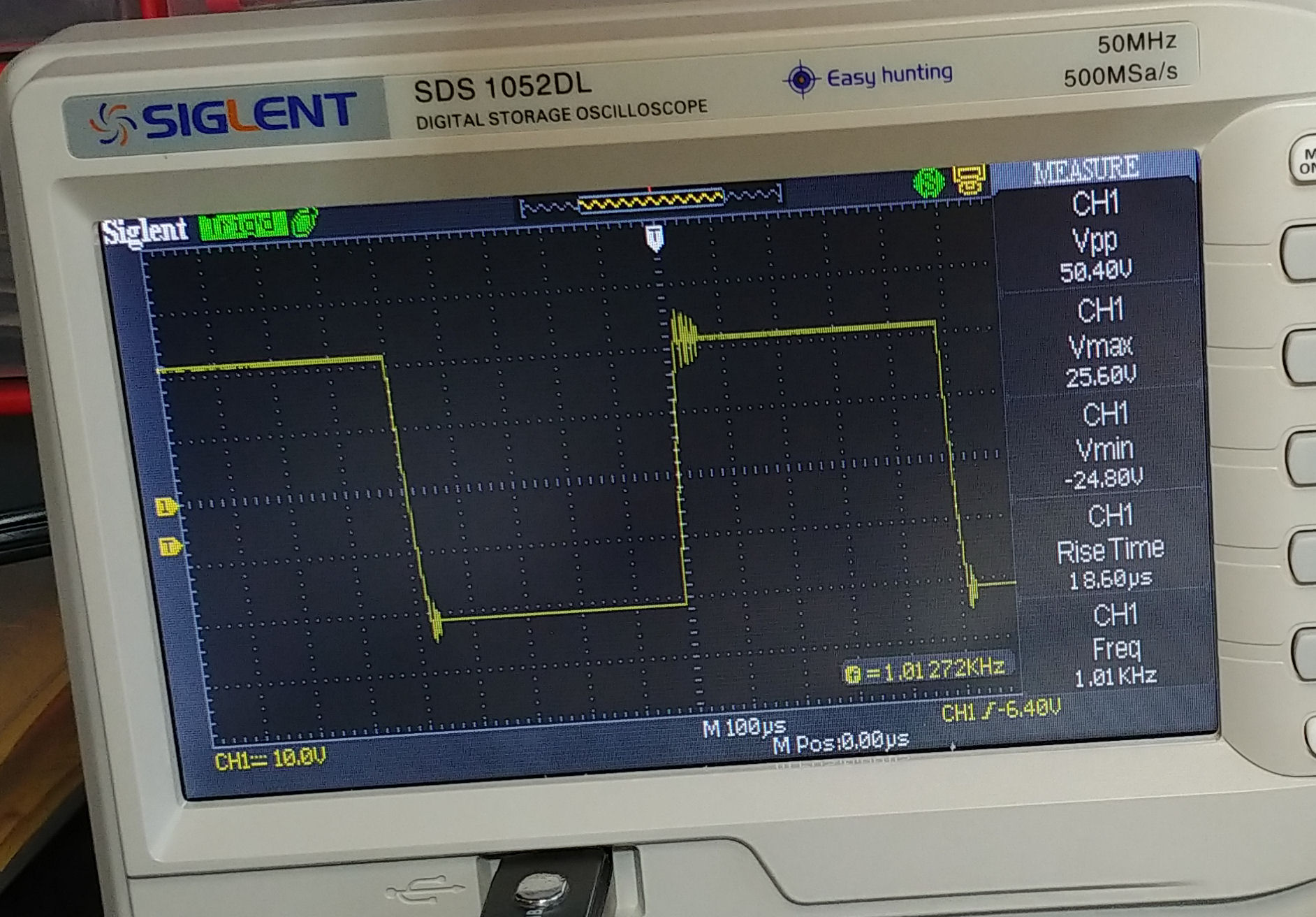

Done testing for today. Tomorrow will test with unregulated PSU, speakers and music.
This amp has been tortured with square waves for the whole day.
I have to say, based on my history with square waves and amps, it is VERY robust

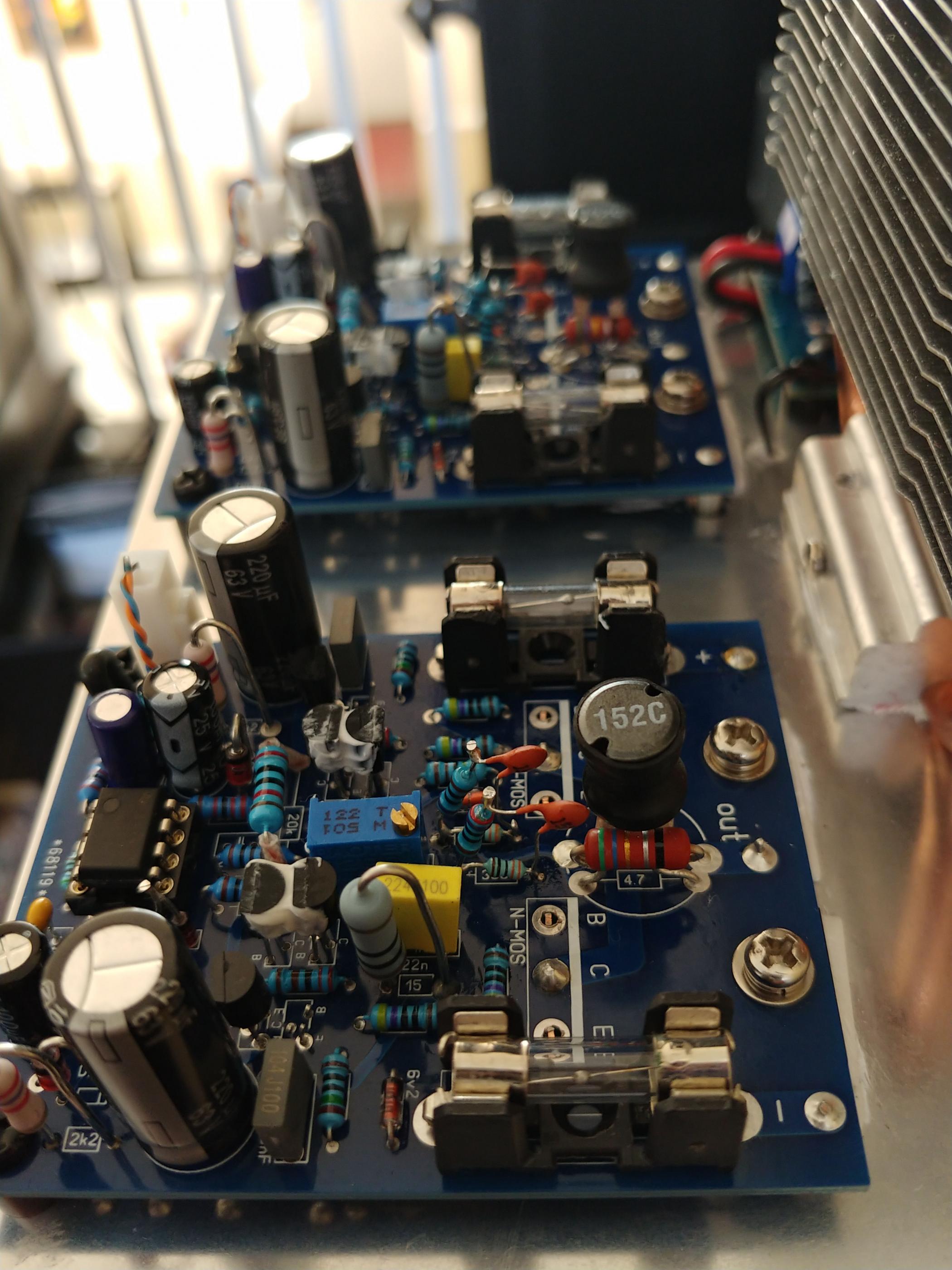

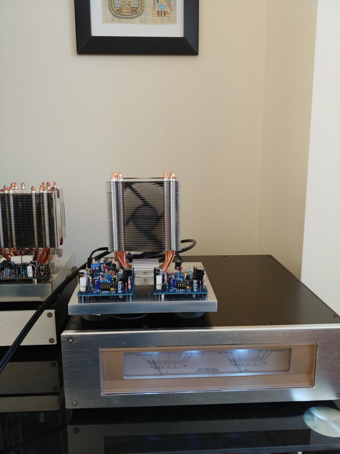

Amp's been playing music for 2 hours now.
Everything is stable, and seems to be perfect.
Sounds very good, and it has very powerful bass, more than
any of my previous amps.
Fan controller is set to keep chassis temperature of 35 C.
Small transistors are running at 55 C.
Op-amps at 42 C
Rails 38V (idle current at 38V is 270 mA, it was originally set to 330 mA at 42V rails).
Detailed photo shows how RC network has been added on top of existing 330 Ohm resistors on on the pcb.
Additional 4n7 caps are soldered under the board.

That was a great effort! It's not an easy beast to tame. One area to yet to consider is the zeners across the opamp; their capacitance is quite large reducing slew rate and capacitance changes with opamp output voltage creating unwanted distortion at 20kHz and making it harder to stabilize. Attached is a jig that plots the capacitance for two 6.8V 1W zeners in series. The capacitance is 286pF at 0V rising to a peak of 561pF at 0.45V then flattening to 430pF above 4V (then the breakdown current starts).
What to do? One option is to omit the zeners and use a 33pF capacitor across the opamp. This will increase the slew rate by about a factor of 10 (then 100 ohm gate stoppers seem to be optimum). Another option is to use clamping diodes in series with the zeners and then biasing the zeners with a few uA (with a 10Meg from the 15 volt rails).
The attached circuit uses clamping diodes with biased zeners improving the slew rate by about 10 times compared to the ordinary zener arrangement. Distortion at 20kHz is reduced by a factor of 6 times. All the best. I hope this helps.
BTW I discovered the zener clamp method today in an ON Semi application note that was linked on Susan Parkers thread Post 1680 Zero Feedback Impedance Amplifiers and the link: Zener Theory and Design Considerations Handbook (see Fig 30 on p28)
Back with another iteration. This time I reduced the gate-source resistors (R10,R20) to 220 ohms (was 470R). Then add LEDs to get 4V gate bias voltage without increasing current in the driver stage. C7 across the opamp can probably be removed and 50 ohm gate stoppers.
It gives about twice the slew rate of my previous. Now more like 20-30V/us. THD is pretty low at 1W and 20kHz. Nice if your build can get closer to these sim figs.
