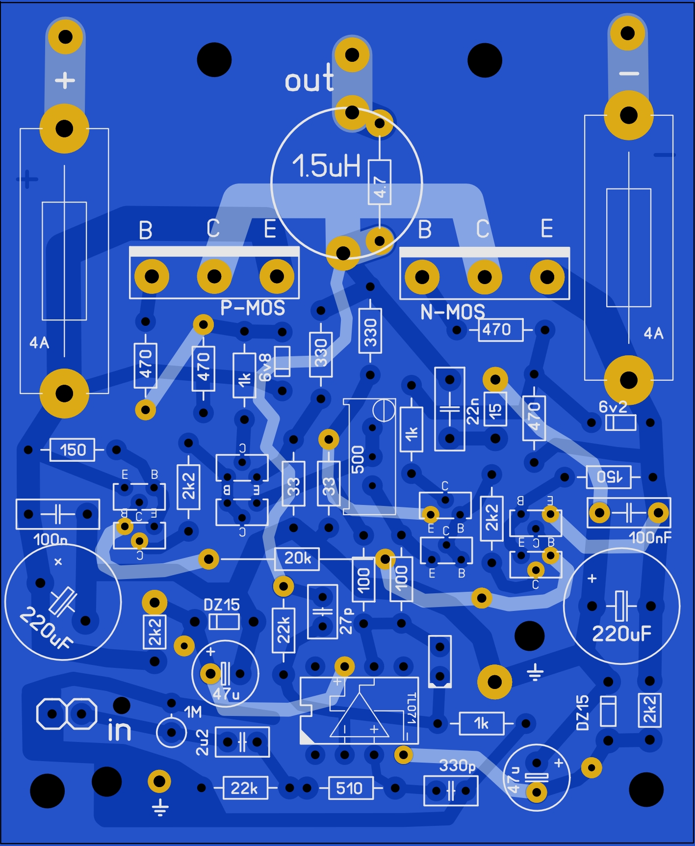

Check the input grounding.
Post 50 PCB shows the input ground is separate from the power ground (as it should be).
But how are these two grounds connected in your amp?
Usually there is a 10 ohm 1W on the PCB for when these grounds are not connected via the input cables.

I design all my pcbs/amps like this.
Two separate grounds (dirty and input) on the pcb.
Two separate wires from PCB to the common ground point from the PSU.
Never had to use 'lifted ground' with a resistor - it's cheating 🙂
With this design, never had any hum, noise, etc...
Ground for speakers is also taken from the common ground point (from psu);
not from the pcb.

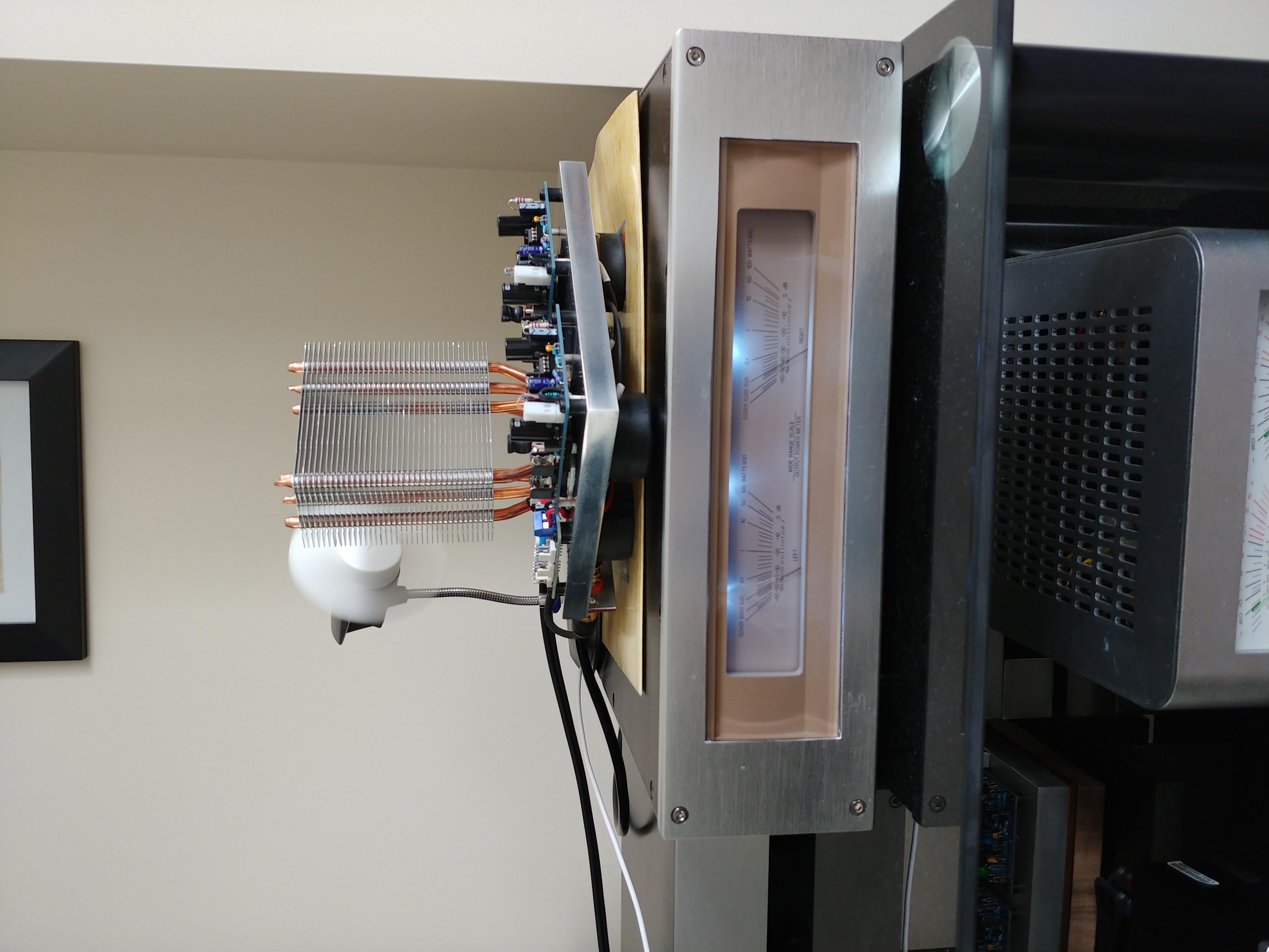

The psu, all the cables, speakers, speaker protection ,etc... are alll
the same I always use for all my other amps.

Here is similar PCB (with two grounds) I made for this amp:

See the big PSU with VU meters, and square law amp on top of it.

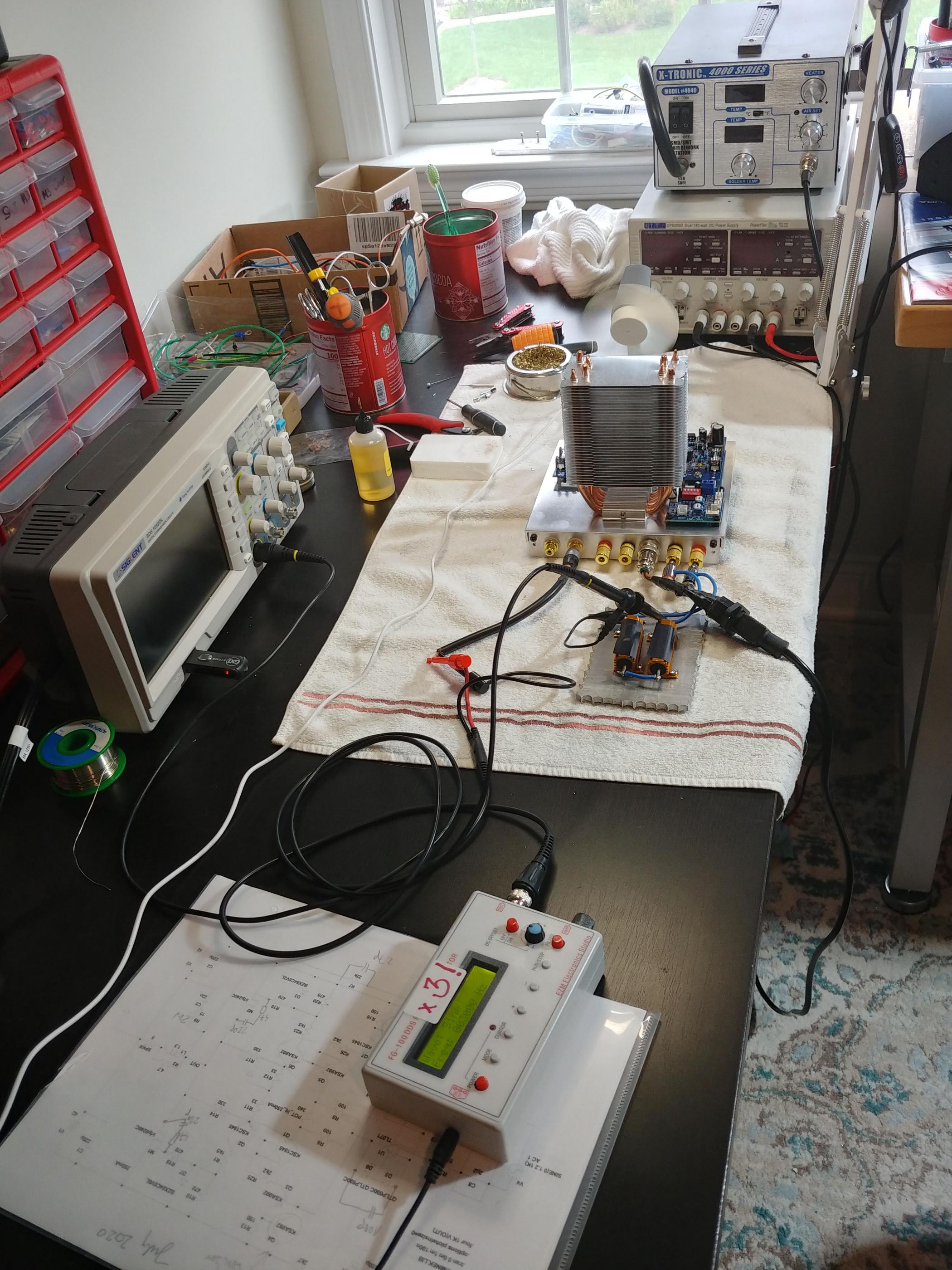

Going back to testing/troubleshoting with signal generator and oscilloscope.
First of all, have to replace Zobel resistors (and maybe put 2W instead of 0.5W).

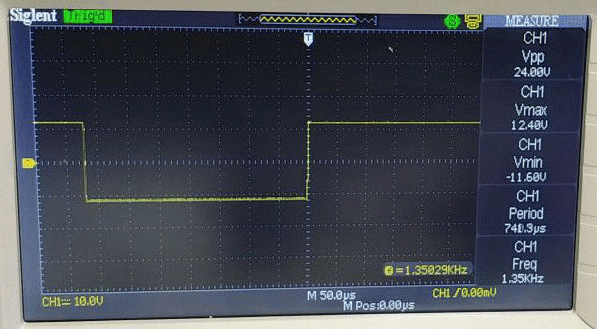

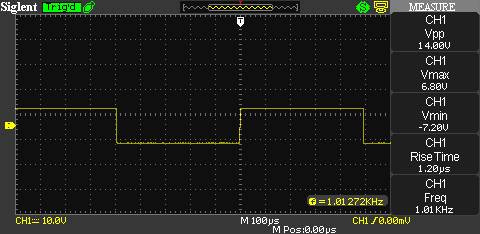

On the bench repeat the squarewave test. The bottom line appears to be noisy (below) but the top line thin, or is that just the scope's DSO resolution.
One way to check is there is some MHz oscillation is to place the 2nd scope input to the Zobel resistor which needs one end to ground (as seen on your PCB photo in Post 50, but not as shown on your circuit). If there is a MHz oscillation then the voltage across this resistor will be in the several volts region. You can trigger on Ch1 with a squarewave as before.
If there is some MHz oscillation, even low level, then try your ideas with capacitors to see which ones reduce or eliminate it. Look at the effect on risetime and overshoot or overdamping. Some values may make it worse. It is helpful to see what does what.
If there is no MHz oscillation then it is still helpful to try your ideas with capacitors to see which ones reduce or eliminate it or the effect on risetime and overshoot or overdamping. Some values may make it oscillate eg too much C6 across R7 feedbcak resistor will probably cause oscillation.

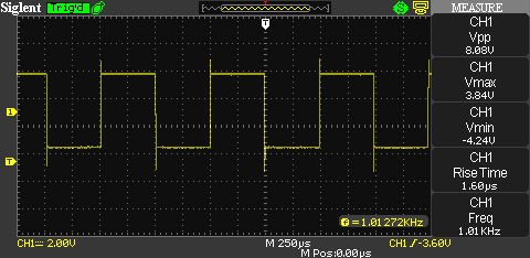

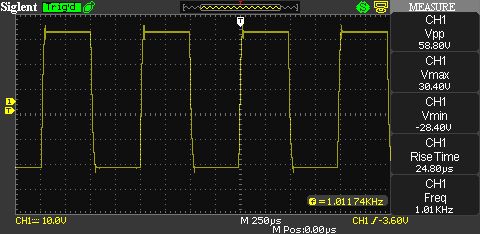

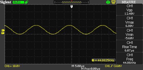

To measure SR, risetime, you just need a squarewave generator and an oscilloscope (preferably analogue if you don't want to miss any subtleties of the waveform, but a good digital phosphor already works well)
While I'm testing again, I measured SR: 800ns - 1us while Vpp is 8V.
Once amp is stable will try higher Vpp...
My oscilloscope has option to calculate and display it.

>On the bench repeat the squarewave test. The bottom line appears to be noisy.
They always look like this, even if I connect oscilloscope directly to the generator...

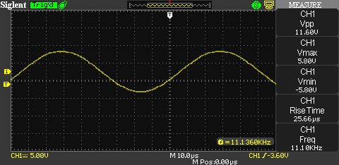

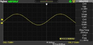

Testing again. Replaced Zobel resistor with 10 Ohm 2W.
So far everything normal on the bench.
Without input signal (input grounded on the pcb connector) ,
I see some noise at very low level, various kHz range frequencies, averaging +- 20mV.
With input signal present, all waves showing up fine and clean.
One thing I noticed (took me a while): if I use low quality usb psu required by my wave generator, the waves I see are ugly..
Had to change the usb psu to a better (?) one.
This thing (usb charger from LG phone) was polluting...
Next step - will try real speaker and music source.
Music plays fine, no oscillations or anomalies I can see.

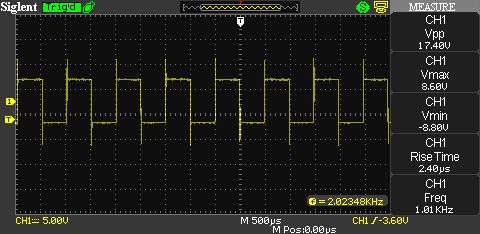

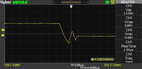

Now I tried small caps:
1) With both caps (27pF across feedback resistor, and 100pF across op-amp)
the amp goes crazy. Lots of oscillations all over the screen.
2) With only one cap (100pF across op-amp) - it works fine until Vpp=16V,
when is start clipping lower half.
Actually it's not just clipping, but cutting 3/4 of the bottom half of the sinus.
According the sim, cap across feedback resistor only make sense if the other cap across op-amp is present, otherwise even sim oscillates; so I haven't tried that combination.
Next thing to try: small Zobels between G and D.
If they don't hurt, will leave them, and try the whole amp again with unregulated psu.

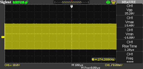

On the bench:
1) without load, all waves look good, I don't really see any problems.
Schematic 'as built', without any additions/'improvements'
2) with speaker and music, all seems to work OK. Haven't tried real loud music, so that means nothing...
3) with resistive load 8 Ohm, SOMETIMES it will start behaving weird
at over 20 Vpp at the output. Sometimes at 20Vpp, sometimes higher.
Suddenly it will draw more current (20% jump), bottom half of the sinus will be
cut almost completely, and showing messy horizontal line instead.
This happens only sometimes (3 times out of 5) and only under the load.
Sometimes amp will "latch" in this mode, and even turning off the input signal will not help it to recover.
So all in all, I think there are more than one problem.
Up to 20Vpp everything always work fine..
My original Zobel in first post was 10 Ohm/100nF.
When I upgraded resistor to 10 Ohm, 2W, it's not burning or running hot.
All oscillations seem to be non-destructive.

1) So, now sinus waves look perfect, clipping happens at 70Vpp,
upper sinus wave. With 8Ohm load.
2) RS on square waves is from 1us to 1.2us all the way to 30Vpp
With 8 Ohm load.
3) 1kHz sqare wave with load, after reaching 30Vpp, will look like on the attached pictures. It oscillates after reaching little bit over 30Vpp.
Perhaps this is too much for a square wave test? It's pretty harsh for the amp, I guess.
When it oscillates like this, amperage shown on my PSU is 3.5A.
No idea how it's possible, because this PSU shouldn't be able to deliver this amperage at 72V, it only has 180W, and my previous experience was that even this 180W is optimistic.
Square waves were tested with Zobel in place, it's a miracle how it survived... didn't even smell any smoke 🙂
With 8 Ohm load.
4) A few times, it went into exactly same kind oscillation (as far as I can tell), after running for a while on sinus wave, and when (at the end of the test), I turned input V back to 0.
This behavior will have to test further tomorrow. I'm kind of not worried about square waves oscillation, but this is more
worrisome...

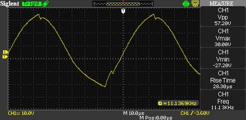

Latest test results with Elvee's Zobels (470 + 2n2) between D-G.
Everything tested with 8 Ohm resistive load.
1) Sinus waves in all kind of ranges look more or less fine
2) Previous kind of 240kHz oscillations is gone.
3) Square waves go without oscillations up to 60Vpp
4) There is overshot on the square, getting relatively smaller as Vpp go higher
5) RS is slower than before (1.2us): 1.6us now, and 24us when square Vpp is 58V.
Previously, 1.2us was consistent with the slew rate of TL071.
6) This triangle wave in one of the photos, is actually a sinus at 44kHz / 27Vpp
So I guess it is an improvement.
Not sure about RS numbers increase, how these compare to other real-life amps?
The 470/2n2 local FB network is just a starting point for further iterations: it is obviously much too aggressive, but it is stable.
You can now try other values: for example, try to reduce C in a E6 progression (2n2, 1n5, 1n0, ...)whilst adapting R to improve the square response/keep things stable.
At the same time, you can tweak the other caps in the amp, to improve matters.
A SR of 30V/1.6µs is 19V/µs, slow enough to make many members cringe in disgust, but more than sufficient in practice.
If it can be improved to exceed 30V/µs, it would be better, but it is not essential
