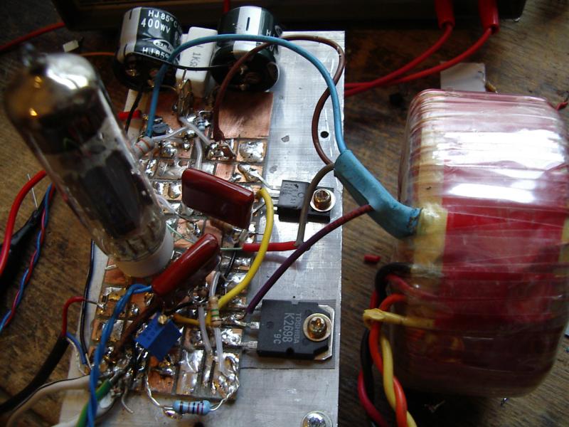

I built the differential 'top-servo' design we worked out in the schematics posted above.
DC performance was fine, better than 1mA balance. AC performance terrible, too tough to reconcile all the time constants - instability, motorboating.
Those that called for something simpler were right.

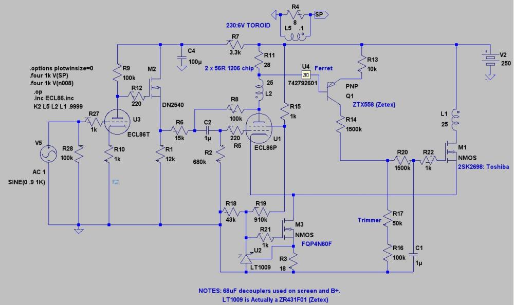

so here's the next step.
I designed it, built it and tested it today and it's much better. You need a trimmer to set up a given valve (the worst complaint), but it is very stable after that - the valve drops about 1mA when really hot, so adjust it after 10 minutes or so. dc balance to 0.5mA is quite possible, but use a 10-turn trimmer for that.
Operation:
Circuit based on a very stable current source. I bought 100pcs ZR431F a decade ago, and here's a good place to use them. It shunt regulates to 2.50V right out of the packet, and is temperature stable. Set it up with a 600V FET to give 110mA.
At cold power-ON, no current flows in either side (no crash-start blow ups!). As the valve warms up and takes current, R11 senses anode current and Q4 relays an amplified sense current to the FET M1 (antitriode).
When it is warmed up, adjust R17 to balance the currents - 55mA each in this case.
I tested it with an EL84 and EL86, in pentode mode - using a 100VA 12+12V toroidal trafo. At 250V 50mA it gave about 5W into 8.0 Ohms, and at 210V/55mA a little more.
I suspect I need a 9V trafo!
Operation:

Hey Rod,
Nice to see you did a testrig! About the first circuit I guess a servo needs a fixed reference to work well.
For EL84 you need a tranny with ca 7V unloaded secondary voltage. They must have sweated with your 3kohm load! Circuit looks simple enough, will just try to adapt it to my depletion MOSFETS😀😀.
All my experience is that these circuits are remarkably forgiving of load mismatch on the output. Just goes to show how well the partial feedback works.
Underloading tends to make the bottom end suffer most.

Hey Rod,
Did the design that was oscillating badly have a resistor in the servo tail or a CCS? I can see where a resistor there would open the door for common mode feedback oscillations.
Seems like the circuit asks for a stable B+. A 5V drop upsets the currents by ca 2mA when simmed, any impressions from the real world?. Thank God its Class-A😀.
Another observation: With unequal currents through the transformer halves, clipping gets more symmetrical. Seems like it is when Ia+Is equals Id. Maybe we should add a CCS from anode to ground to equal the currents.
Did you try regulated G2?
Lars, that's a good one. How much better does it behave if R16 is returned to the valve cathode/FET source? Leave C1 connected to ground. Don't worry - R16 carries only 0,1mA!

Hey Rod,
Don, I used a cross-coupled transistor CCS (with ferrite beads in the bases).
The problem seemed to be that big signals easily overwhelmed the servo - and fixing that with filtering caused a kind of tail-chase with the antitriode FET & its filter.
I tested it with 91 Ohm sense resistors, with & without bypass caps, which did not help.
It oscillated to death in the end, and at that point I looked at it & thought there was too many parts, and it had to be simpler.
Had to go home and sim during my lunchhour!
Rod, had to return R16 as I have a depletion MOSFET as M1.
As Wavebourn indicated in his question the problems where gone when simming with a constant screen-voltage.
BUT..... I think we can live with some current-drift in this simple application. As long as it is within some mA. Anway 5V drop will not happen in this Class-A circuit.
Also added a CCS at the pentodes anode to ground. This to make Id=Ia+Is (41mA= 36mA+5mA)as I mentioned earlier. Now we get indications of higher power, symmetrical clipping and lower distortion!
But best simmed results so far have been achieved with a Schaded depletion MOSFET instead of the pentode........

Lars, that's very interesting!
Remember, you can use the trimmer to set the current out-of-balance.
connect a dummy load, Let the amp warm up, then add a drive signal until the amp just clips. Then adjust the trimmer until the clipping is symmetrical.
