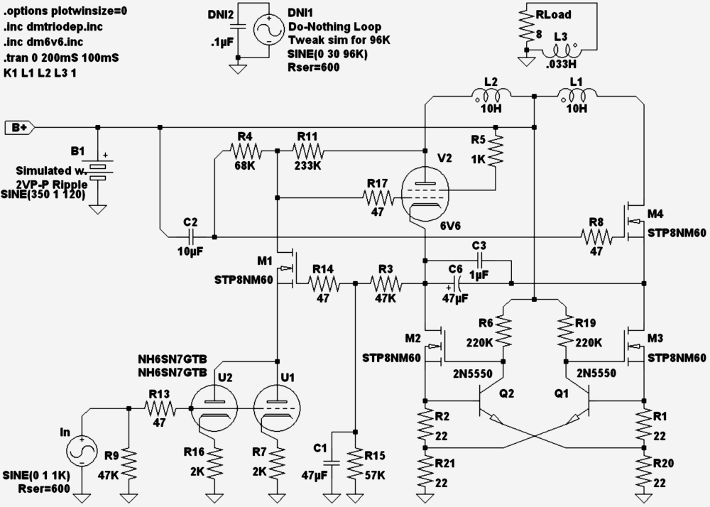

And still forgetting that AC screen current variations in R15 are inverted
and sent back up M1 into the output transformer. Your correction for DC
balance at the plate has not yet done anything to address this AC path.
I already mentioned that Don offered a solution for this anomaly for pentode-tetrode connected finals.
I have taken little interest in this aspect because my own version of this design (which I am now beginning to like a good deal) will be a larger amp - 6L6Gx triode connected AB2 with toroidal OTX. The cost of toroids doesn't increase much between 50VA and 300VA, for my preferred vendor at least. And the circuit is already showing a Power-FET grid driver; we may as well make it work for its living.
I do hope you like the vanished electrolytic version.
Rod,
Minor detail fix on schematic of post #58. Without Q4 in the circuit, R20 needs to go over to the R14 side along with R16 too.

"6L6Gx triode connected AB2 with toroidal OTX"
With AB mode, the cross connected cathode to slave/anti-triode scheme won't work. Assuming this would mean conventional P-P AB2 design with toroid OT. Although there is the untried, so far, idea of using the anti-triode scheme for a driver stage, which could then drive a conventional P-P stage in ABx mode.
Ken,
Your Blumlein derived garter bias circuit probably can be made to track quite well versus temp. if the two bipolar transistors are a matched pair. Analog Devices makes some dual matched parts. MAT01, MAT02 ...MAT04, and SSM-1 .... as I recall.
Don

Hey Rod,
Couldn´t keep away from the FET s😛. Also removed the "anode-caps" and returned to the 33 ohms. Seems to work quite well in theory(LTSpice) when pushing the ECL86 both up and down quite a bit. Forgot to add gatestoppers for the PFETs:
About the bigger toroids you are looking at, they seem to have low inductance over 80VA. Have you measured?

Lars, you certainly like your FETs.
Only thing to watch is that the sample-to-sample variation of FETs is much worse than BJTs, so the balance will be worse - you may need a trimmer to centre the diffl amp. you can build the rest of the circuit the same if you substitute the MPSA92s again - with a current source tail, the input impedance problem vanishes.
As for toroids, I would be interested in recommendations for mains parts - thanks for yours, Shoog.

Oh, I forgot to mention that one can just put a CCS on the other side of a P-P output xfmr to run SE without an airgapped xfmr. (or can do the same CCS DC compensation on the secondary side at lower voltage/higher current) It doesn't provide any extra power over SE though, just wastes more.

Well, this works out pretty good, till I try CCS shunt reg screen.
Then LTSpice can't seem to find stable operating point to start.
Just want to throw about 8mA at each leg, what don't care
how much goes thru a pentode screen or shunt reg past it...
Adjust Garters back up to 40mA per leg (counting the extra 8).
I think some days its just this sim too stOOpid to let me do stuff
that I'm sure works fine in real life..

Ken,
Very interesting design. Looks like V2 cathode is slaved to U1,U2 plate via M1 feedback, then M4 anti-trioded to V2. And M1 provides the hi Zo to drive the Schade feedback point for V2.
Could get rid of the last triode (U1,U2) and put a pentode there. Plate as output to the Schade point in place of M1, and screen grid as input from V2 cathode (buffered). Just an idea. No obvious advantage.
Michael,
Class AB output certainly raises the bar for difficulty. Only obvious way I can see would be using the anti-triode scheme for a driver/splitter, followed by a very transparent class AB stage. Maybe error correction or some kind of local feedback for the AB stage. Likely also need some feedback to the driver stage "triode" like Ken has in his recent schematic. Making the whole output stage a slave to the triode.
Or, an anti-triode scheme for a driver/splitter but using pentodes (or modulated cascodes as Ken used), then the class AB P-P outputs would individually feed back to the driver tube screen grids. CCS pullups on the driver plates to get high loop gain between each driver and output tube. Effectively slaving each P-P side to each driver tube individually.
Bigun,
Yep, class A is just not efficient. Notice how many of the posters in this thread hail from cool climates? 🙂
Don
