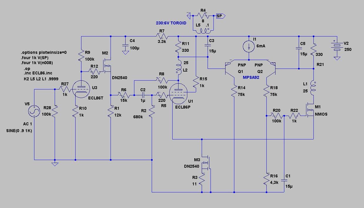

Don, you are right, the diodes were there to keep the PNP bases from getting blown when the amp is in overdrive and all kinds of inductive currents are running around.
A low pass filter would protect them almost as well. However, an RC filter on the base may suffer from the low impedance looking inward, since the emitter load is so heavy.
But we can adapt the idea and simply bypass the sense resistors: 6V durability for the elkos will do, and 220u rolls off at low enough frequency. This hands us another advantage: we can increase the sense resistor without increasing the losses from the anode currents. Now we can have more headroom on the diff pair, and its temperature effects are almost vanished.
The balance point for the diff pair in the previous circuit depends, as you noted, on the MOSFET turnon voltage Vgs(th). And as this shows wide variation across samples AND drifts downward as the FET warms up, we could have trouble. OK, since we're raiding old stocks of TV triode-pentodes, why not try a sweep BJT? The old BU508 can do 700V [ces]. It'll need a darlington, but why not? For designers focussed on gm, this configuration yields a gm rated in Amperes per volt!
The pic shows a circuit idea for that setup, with 100 Ohm sense Rs, and 3mA per side on the diff stage.

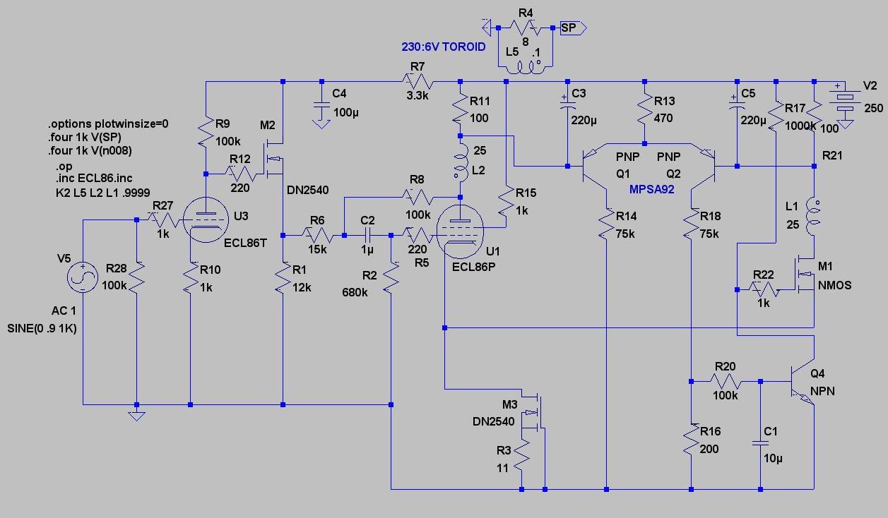

Rod,
Your bipolar version looks good to me. Might want to return R16 and R18 to ground as Lars has suggested, instead of the cathodes (and adjust R16 upwards) for improved sonics (no servo currents in the audio path that way, although they are nearly constant and LF here).
Normally, the base current of Q3 would be a concern for fidelity of duplicating the emitter/cathode current, but the Darlington here should be an adequate fix-up if Q4 has high Beta.

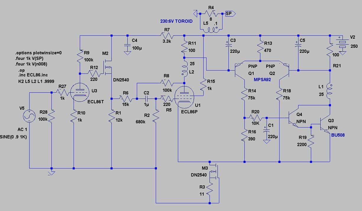

Ken,
Obviously some increased complexity here, but this is closed loop current balance versus open loop. Either way, some attention to thermal effects is needed. Either the MPSA92s have to track or the dual cathode Mosfet CCSs have to track.
A tracking current mirror in the cathode CCS, as used before, has some theoretical attraction, but may well be even more tricky to get the thermal tracking right.
Ken,

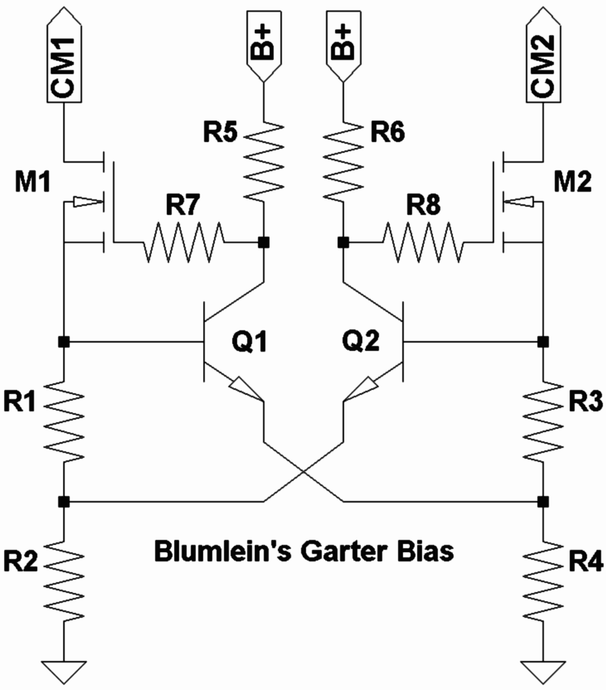

Well, I have always proposed garter bias for balancing the split tail CCS.
Shoog's bridge keeps the caps polarized with a bleeder, I don't see that
as a problem, or you can bias a single electrolytic with DCV offset as I did.
What issue here did we fix??? Only screen current error at the cathode???
We have fixed it only for DC balance, not for anti-triode AC response to it.
I think we need go back to shunt regulated CCS for that.
I guess you need yet another actively matched CCS for the other screen,
even if there isn't Pentode that side, to keep it all in balance? Same circuit
for cathodes turned upside down, could do for screens.
