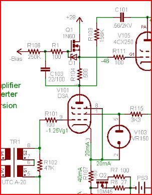

Regarding pentode as input tube: Any screen currents are felt by cathode resistor NFB
(necessarily unbypassed for maximum plate resistance). But they do not exist as seen
by the driven load. So the impedance into the Schade network may be high, but there
is a screen current NFB error.
I remind a few posts back I showed a hybrid input stage with Triode handling the input.
And a MOSFET in cascode above the plate, to provide the high impedance. This setup
had no such screen current leakage path to mess with NFB at the cathode. Thus the
current sent into the Schade network might be more truthful to the input grid's voltage.
Hybrid cascode might also be a very practical input stage setup for a Spud.

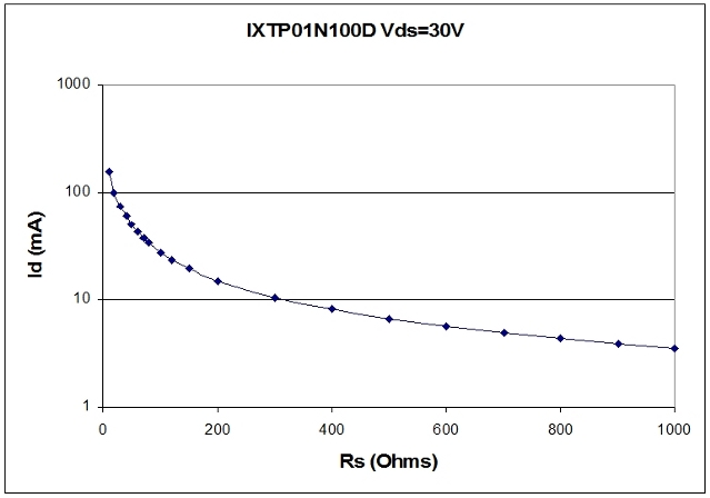

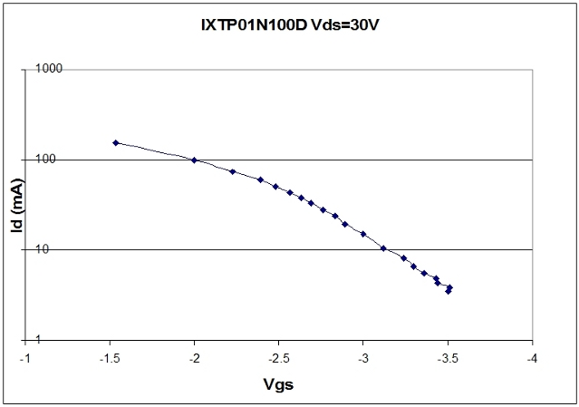

IXTP01N100D data
Here are some data which may be useful. The case temperature is about 25C (30C at higher currents), Vds about 30V, one random sample.
Looks like an excellent top-of-cascode device with low Coss, high Vgs at reasonable currents.
Vgs(off) is -2.5 min, -5V max. I haven't hooked one up on the bench yet, but from the spec it's in the ballpark of a 10M45 (which is listed as "Vg"= -5V min and operates at -2.5 or so at lower currents).
High Vgs(off) is IMO a great attribute for CCS use because it provides for higher Vds on the bottom device in a simple cascode connection (less capacitance, higher current potential).
It's the low capacitance that makes me most happylooks to me like an excellent part for cascode anode loads on driver tubes. The capacitance is about as good as the FQP150/160 parts.

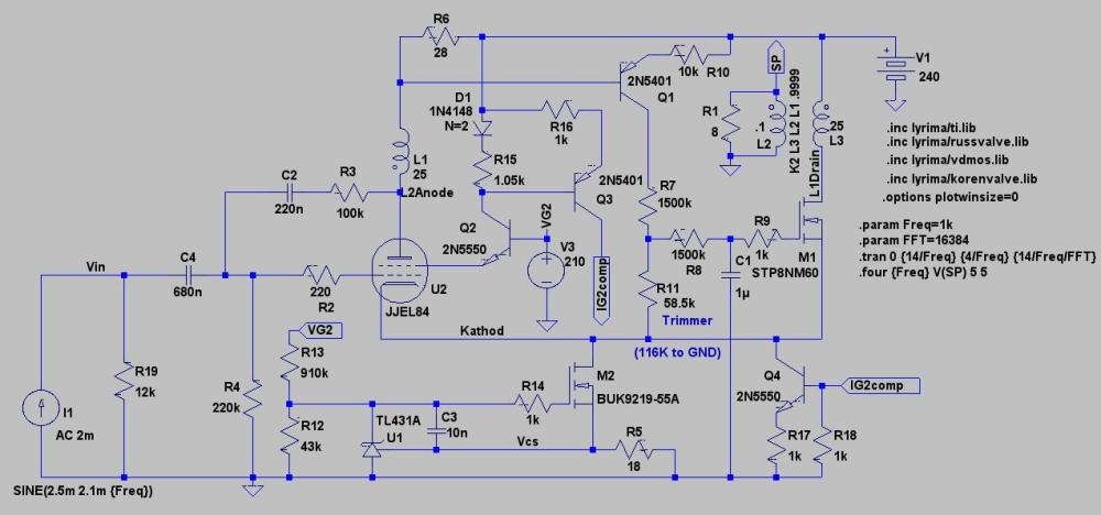

I'm still away from my bench but I have been busy with this circuit still (because I like this one!!)
I warmed up LTSPICE & got the updated valve models from:
LTspice : LTspice/SwitcherCAD III
and have had fun modelling the circuit. I am really surprised how close the simulation comes to the real measurements of the one I built, so I have been encouraged to model some upgrades before building them.
One thing I am very pleased with is the new G2-current compensation circuit. It's in the schematic as Q2-Q3-Q4. First, the screen voltage is dropped to 210V and regulated to give high performance and dc stability. Q3 senses the actual screen current, and Q4's circuit turns this from a source to a sink current. This current is then subtracted from the cathode circuit to give exact compensation. The 2 series diodes (D1, N=2) correct the offset due to the Vbes. The simulation shows the action to be almost perfect, no phase effects etc. We shall see!
The distortion is low at 6.6W output:

Distortion rises to about 4% (dominated by 3rd) at 9W output, which doesn't seem bad for an EL84 and only 240V supply.

Don,
In all the top-sensed versions of the circuit, the dc balance in the trafo is independent of screen current, as it's not measured.
The new circuit attempts to sense the value of dynamic screen current, which does not flow in the valve side of the trafo, but if uncompensated, would flow in the MOS side. By taking an equal current out at the cathode, the aim is to have an exact mirror of the anode current flowing in the MOS side (unless I'm missing something)!
If the simulation is anywhere near right (it's been doing well up to now!) there's only about 1% distortion at 6.6W (see data above - demonstrating the value of the Schade network)). Even if that translates into 1% dc imbalance (about 0.5mA) I think we'll still have room to move in a toroid... may be best to set the dc balance trimmer while the amp is working at rated power though... adjust for best bass handling or symmetrical clipping perhaps.Hmm.., the collector to UL tap approach might fix another problem too. As Michael pointed out some time ago, the "triode" side dynamically unbalances the OT DC balance at high signal level due to distortion components (3/2 power current growth for loaded triode, 2nd harmonic mainly). With the UL tap, the "plate" current effectively starts using less xfmr winding turns as the screen current component increases at large signal.
Hey Rod,
This amp has moved a little to far from the original, simple approach😉. I have designed a new driver, with a common pentode and some sand, that takes use of distortion-cancellation to match the EL84.
Have also found another way to compensate for distortion between driver and output device.
Will start a new thread later today where we can develop it further.
Do you have a *.asc of the screen-compensation version?

Lars, It's a little less simple, but the added parts are all easy and low cost. It's also low voltage & mostly protects itself from many possible fault conditions. And it appears to offer very high performance for such a cheap build.
OK, it may wind up needing a PCB, but I'll be happy to do that.
Here's the LTspice schematic. If you use the TL431 (& I recommend it!) the TL431A model (Hartmut's) is far more appropriate for dynamic conditions than the other models (TI and IEEE).
