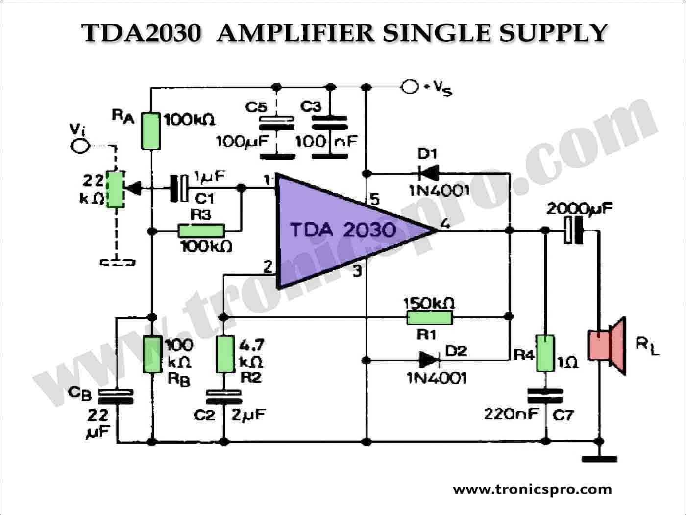

I have it wired up but it just chirps at a regular interval of around one-per-half-second; banging the springs makes it go underwater, and the 5w resistor gets real hot real quick. I have the + of the TDA2030al chip wired to +15v and pin3 is going to 0v/ground on the circuit (in the PDF linked here it has schematics showing pin 3 going to both 'ground' on one circuit and '-v' on another circuit and i tried both, but when I check voltages they just bounce all over the place. When I double check my power supply by itself it is solid +/-15v. I chopped off the legs of pins 1, 2 and 3 on the first opamp and wired their abandoned leads over to the power amp chip. I'm just going thru the circuit line-by-line now trying to find the fault, but ideas for troubleshooting are always welcome, of course

As for the circuit you used beware that the TDA2030 is a powerfull and oversized driver, using a symetrical supply
is risky because in case of failure the spring could be fed by a continuous 15V voltage destroying it, indeed even if this amp work there is surely an output DC offset that eventually could saturate the spring s input transformer with a relatively high current, it would be eventually more cautious to use it with an assymetric 15V supply like in the schematic below and a 100-330uF output coupling capacitor, this schematic is also in the datasheet PDF you linked.

So, am I cool to run this from the +15v and 0v (ground) of my dual supply, with the 5w resistor and the big cap in series?

If the tank is indeed a lot lower impedance than what most people are used to (esp. tube builders), then you do need a chip amp. It likely still doesn’t need a lot of POWER, so a 12 volt chip is probably enough. LM386 doesn’t really like 8 ohm loads. Drives 16-45 ohm just fine but struggles with a “real” speaker. LM380 ought to work, if you don’t need or want to use current drive. But I didn’t think they were even making those anymore. Went away with 80’s boom boxes.
thanks for the input, wg_ski. so are you saying this TDA2030 isn't the right choice / can't be made to work in my reverb labor camp?

A 470uF output cap is more than enough here, and on a 15V single supply a TDA2030 has barely 3W/8R power at 10% distorsion,
so a 8-10R resistance in serial would bring down the max power driving the spring to something like 0.7W, in principle that should be enough without risking endangering the device, this way the serial resistance doesnt need to be that big, a 2W one is sufficent, you can eventually test a higher value in a 15-22R range to check if it s enough.
This is of course assuming that the spring has a 8R impedance, wich is the usual value in most Accutronics devices.
