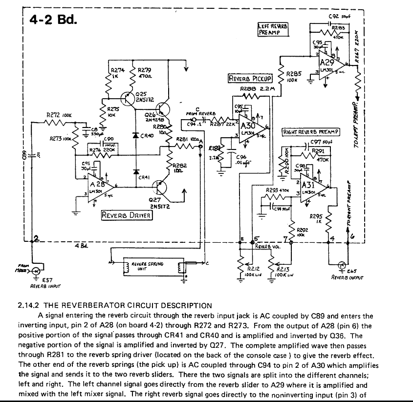

Fully agree.In contrast to your first posting it appears you've got an 8 Ω input impedance reverb tank. No opamp ever will suffice to drive it alone. You definitively need a more powerful drive circuit (add a »power« stage, consisting of a complementary transistor pair etc.). No use to mess with the recovery.
Best regards!
Forget the OpAmp drive, instead drive the tank "as if it were a small speaker" replacing drive OpAmp with a TDA2030 or LM1875 chipamp, fed from, say, +/-15V rails.
Add a 10-15 ohm 2W resistor in series with input coil, leave the rest of the reverb circuit as-is.
If not clear, will add a simple hand drawn schematic if you need to.
Now I understand why you found such a weak reverb result.

I know that 2nd link (care and feeding of reverb tanks) which is where I got the top part of the circuit from. In reading that first link just now I see where he's saying "low impedance (about 8 Ohms) input transducers are well suited to being driven with a small power amp IC". So i might be heading in that direction if this doesn't pan out!

LM386 isn’t powerful enough. It’s really only good for loads of about 20 ohms up. Ive had trouble with BA4506’s - they are finicky and like to oscillate. Doing something funky with the feedback is risky. With the built in resistors, the maximum Zout and gain are limited, but probably close enough to current drive. If it’s stable that way.

Post 38 “the updated schematic” showed it transconductance strapped, so I assumed that’s what Gonecat wanted to do. Whether you really want to depends on the tank. This one is apparently lower impedance than most, and if a 5532 won’t drive it adequately there’s no hope of TL07x. TDA2003 ought to drive anything, assuming 11 volts peak to peak is enough.
