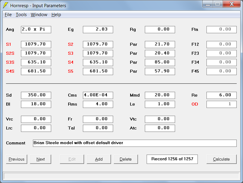

I've seen this particular layout from time to time while browsing around the Internet. Would anyone be interested in a BOXPLAN for it? Seems like a curious mix between vented and TL. The 45 degree "braces" in some of the corners are a bit superfluous, so I might leave them out of the schematic ...
Yes please, I'd like to play around with models of it - have seen similar boxes referred to as "mini scoops", and would be interested to sim them with a considered approachWould anyone be interested in a BOXPLAN for it? Seems like a curious mix between vented and TL.
Good point. It's close - the expansion changes in the first and last segments. I think I'll just modify BOXPLAN-TL1 to allow different segment expansions rather than just model a "straight" TL. That way it can be used to model both types of designs.Brian isn't it practically the same as the Boxplan TL1?

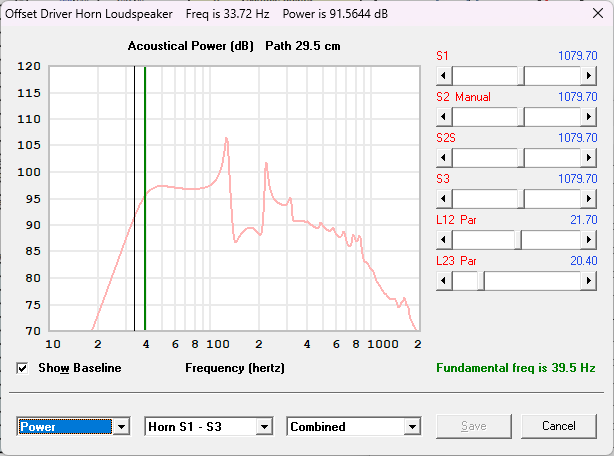

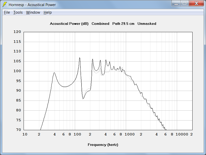

I managed to put together something, but I'm not sure if I'll develop it any further. I suspect that the actual Fb might be slightly higher than predicted due to trying to describe the entire design with four segments with two discrete steps:
Resulting model:
The predicted response looks like this:
A properly-designed ODTL would provide a much smoother response between Fb and 200 Hz, but slightly less gain across the passband.
I probably wouldn't build this.

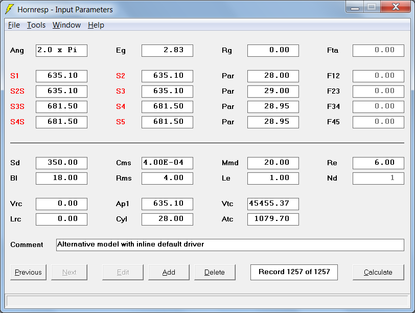

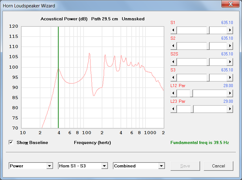

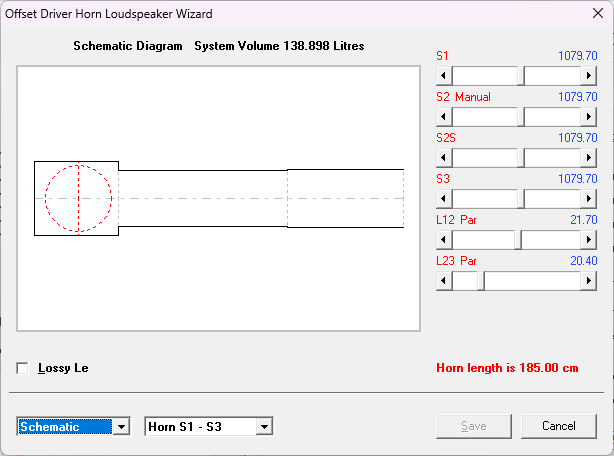

Possible alternative model which would enable the port tube / transmission line to be described using up to five segments (throat adaptor included). The driver is inline rather than being offset but the difference in results should not be significant - the fundamental frequency remains the same. The default driver has been used in the two test examples, with the black trace on the comparison chart showing the alternative model results.
Original offset driver model:
Alternative inline driver model:
Results comparison:
That is an interesting alternative approach. It should allow for better description of the S1-S5 path too. However, I don't think I'm going to do much more development of this project, as that 100 Hz - 200 Hz response is pretty horrible.

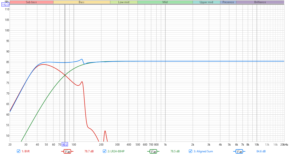

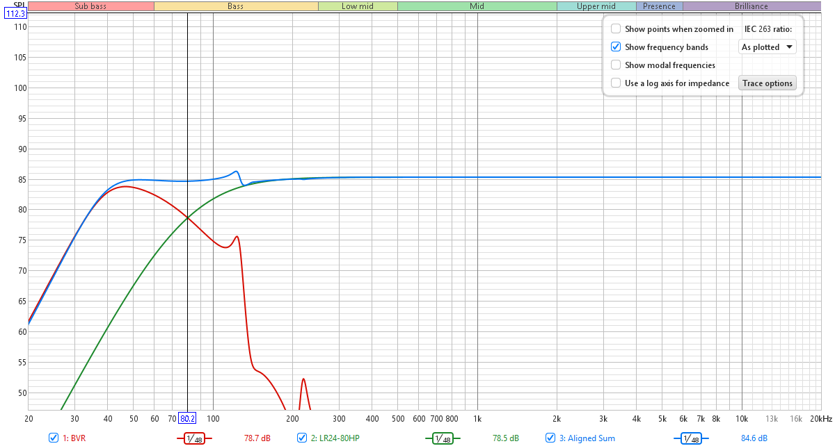

Here's a sim of the BOXPLAN mini-scoop loaded with a B&C 15BG100 LP'd @ 80 Hz LR 24dB/octave, combined with a theoretical speaker HP LR 24dB/octave at the same frequency. With a little time-delay on the top, the overall response is pretty flat.
No, I said "some" of my words, because it seems a bit "wasteful" to LP a 40 Hz bass bin @ 80 Hz. 40~100 would be the minimum I'd aim for.
The next step now is to "validate" the sim. But I really don't want to build one of these - I need to find someone who's done so to see if the sim does a good job of predicting its impedance curve and frequency response.

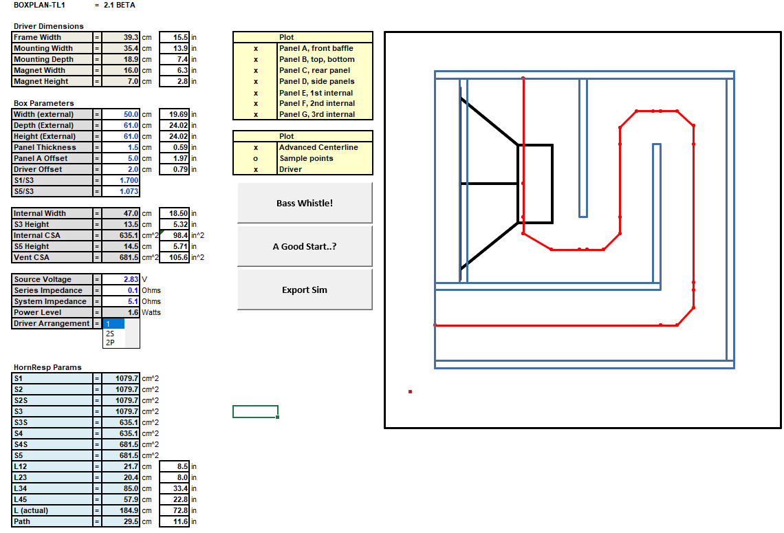

Hi Brian,
I am trying to model one of GM's MLTL ( https://www.diyaudio.com/community/threads/mltl-cabinet-for-416-8b.113177/ ) using Boxplan-MLTL3. The external dimensions of the cabinet are H = 106.66 cm, W = 76.2 cm, D = 51.435 cm, with a divider placed mid point between the front and rear panel. I am not able to get the internal divider panel (Panel F) to be placed correctly. My thought was that increasing the Box Parameters Depth (External), Panel F will be placed correctly. That obviously is not the case. How does one specify "x" for Panel F? Also the panel dimensions seem incorrect or I am missing something? I did increase the graph axis max value.
Simmonds
Simmonds
Oops, missed changing the hornresp params in the general instructions. Will try and that and see.
Simmonds
Simmonds
That design is an offset-driver / offset-vent MLTL. I don't think BOXPLAN-MLTL3 can be used to model it.
