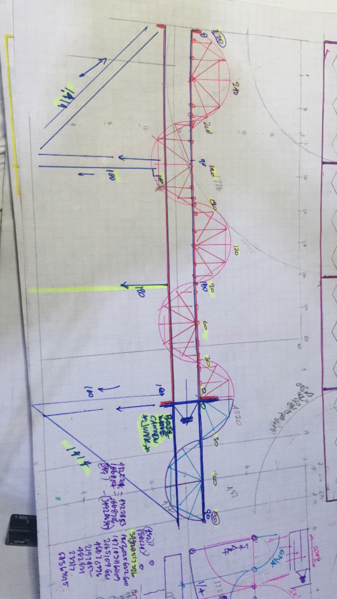

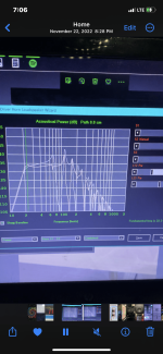

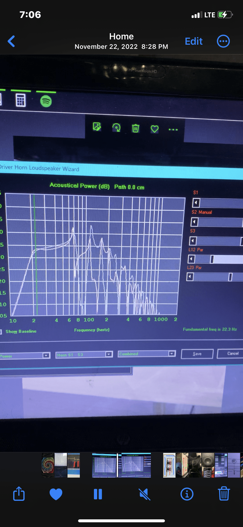

Attach these two open ends together and move the driver to the location in the sim (it splits the 3/4 resonator in half and smooths out the response ‘best’ for some drivers (especially in pairs or opposed pairs /quads)
look at the continuous ‘hypothetical’ Sine wave shape throughout? I thinkthis is what many paraflex models ‘screw up’ by trying to do other weird resonator shapes(too big and too short mated to a long skinny TL, mismatched sizes or choked, pinched throat chamber exits, etc.. ? It’s all messed up trying to do way too much and going crazy in horn response/computer but not actually building anything to realize it’s inevitably acoustically messy??

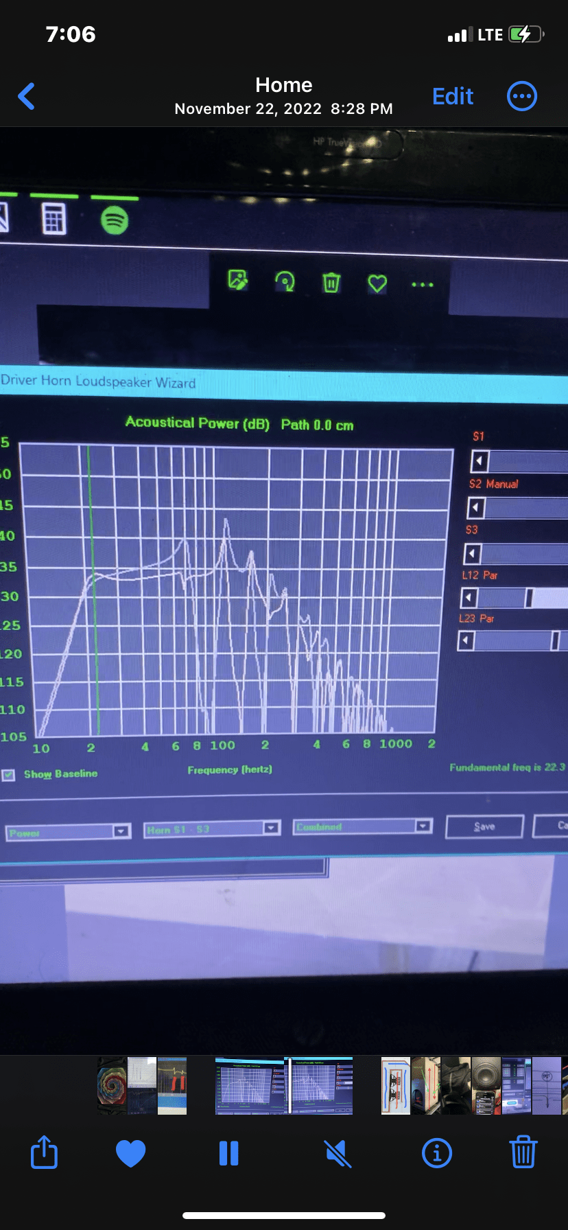

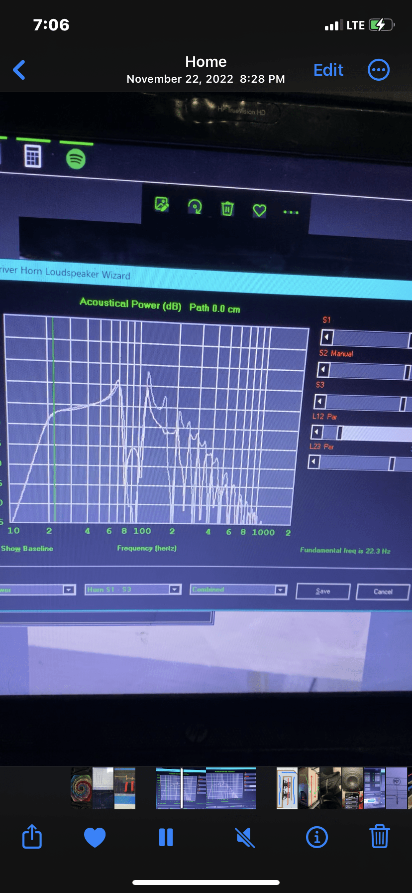

Thinking of doing a series tuned 6th order on this run idk a modeled one out looks like it could be nice. It is what it is tho it’s always a chase no matter how perfect I get it it can always be louder go lower do more so it’s a never ending cycle lol my favorite boxplan so for I will say is the mlt3 I have built plenty of those they end up a little big but no bigger than what a paraflex gets anyway and they get low the response is great and they will flex a woofer you can run a 1500 watt woofer with hardly any power and it’ll be moving like it had 1500 watts. They do take a little playing with, i line the inside of them with rock wool which isn’t the cheapest anymore so they’re not the cheapest box to build but so far they have worked great for me idk 🤷♂️ but there’s just something about the look of a paraflex that’s so appealing lol

but, It’s a transmission-line. it has a bazillion resonances that ring. if you dont address the initial one (after the fundametal) its junk . its in the XO slope or worse 🥲 I think people ignore this or aren’t aware? Then the transmissionline sounds like junk out of the bandwidth interfering with other speakers awkwardly
dsp/xo cannot fix much of that properly (or worsens it?). and it must be looked into acoustically (I think/hear junk otherwise? It’s too hard to describe or discuss, it’s in the sound ?)

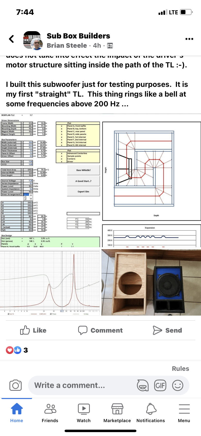

Yeah, but the ringing amplifies any distortion produced by the driver as well.

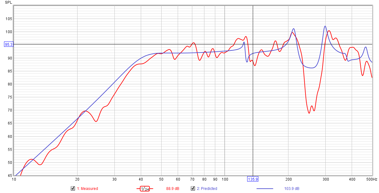

I tried running it undamped today as a woofer in a 2-way system LP'd at 100 Hz 12dB/octave. It was a little too coloured for my liking.
Hopefully that should be cleared up when I apply damping material to the first section of the TL.

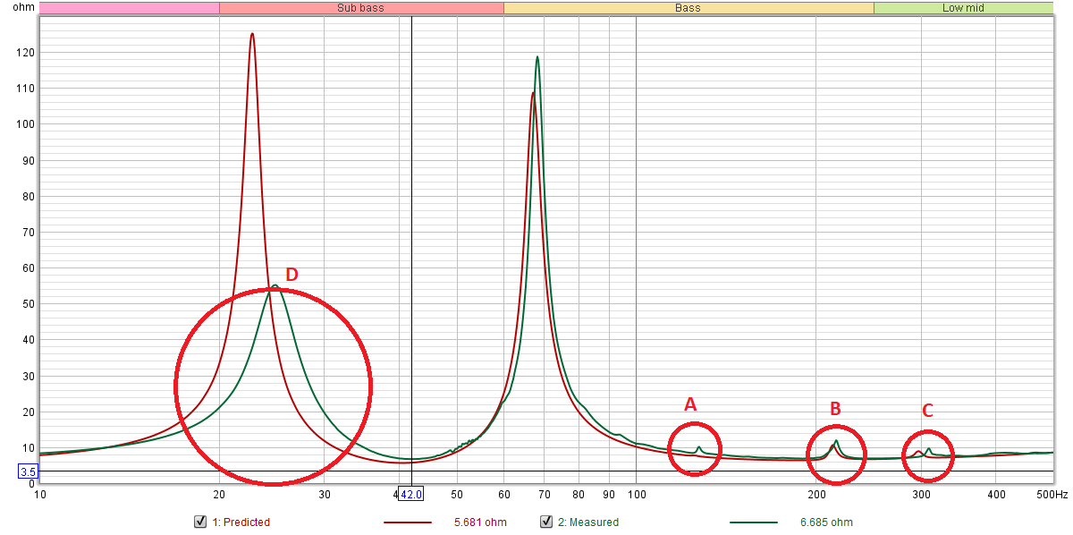

There is no official writeup yet, but I've posted some results in a Facebook group, https://www.facebook.com/groups/subboxbuilders/?multi_permalinks=2153280964859173
The frequency response was was a quick one taken in-room so the room did have some impact, but generally the response is as predicted, up to the big dip between 200~300 Hz, which is much larger than predicted by Hornresp, which is not too surprising.
