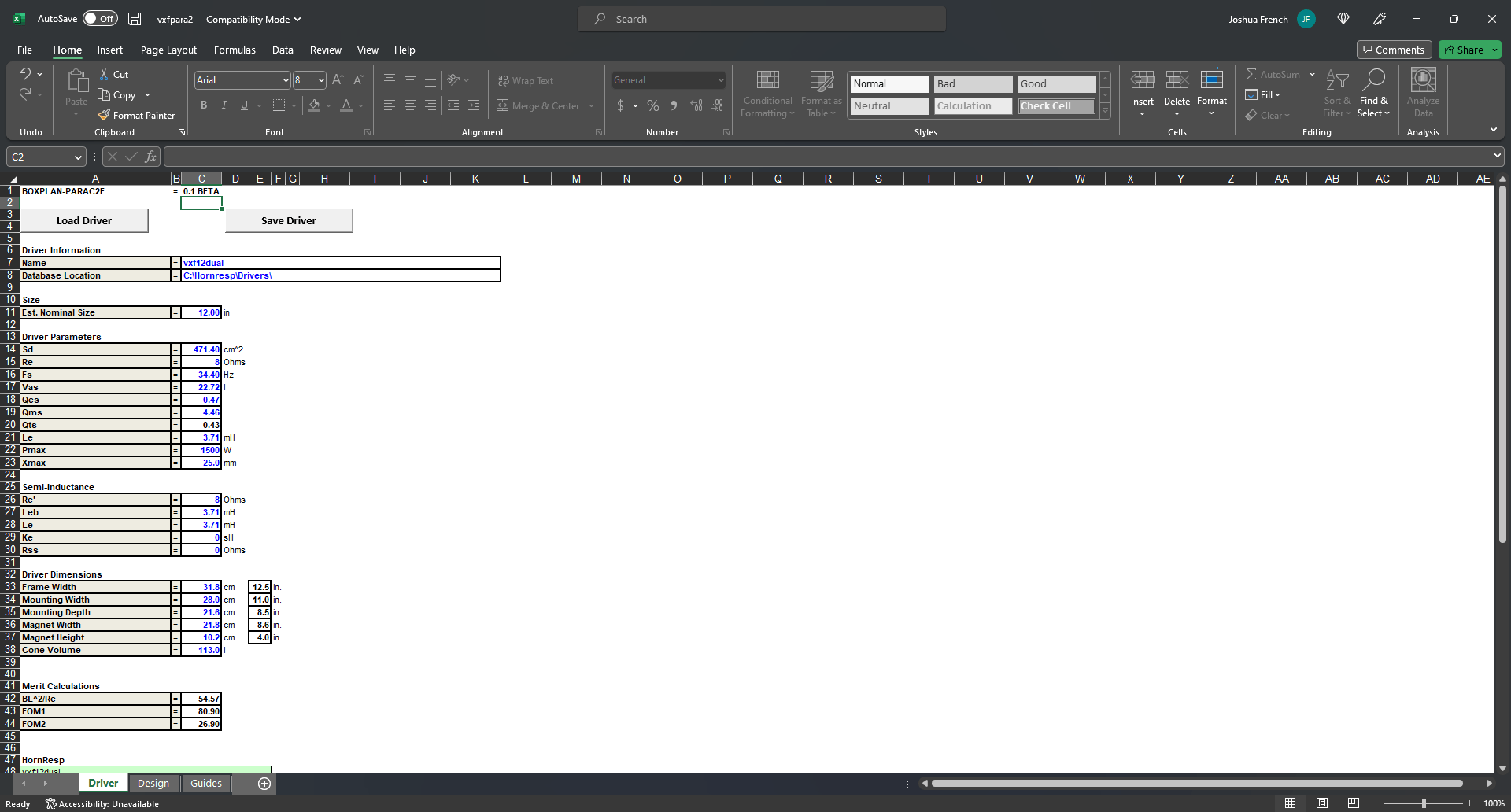

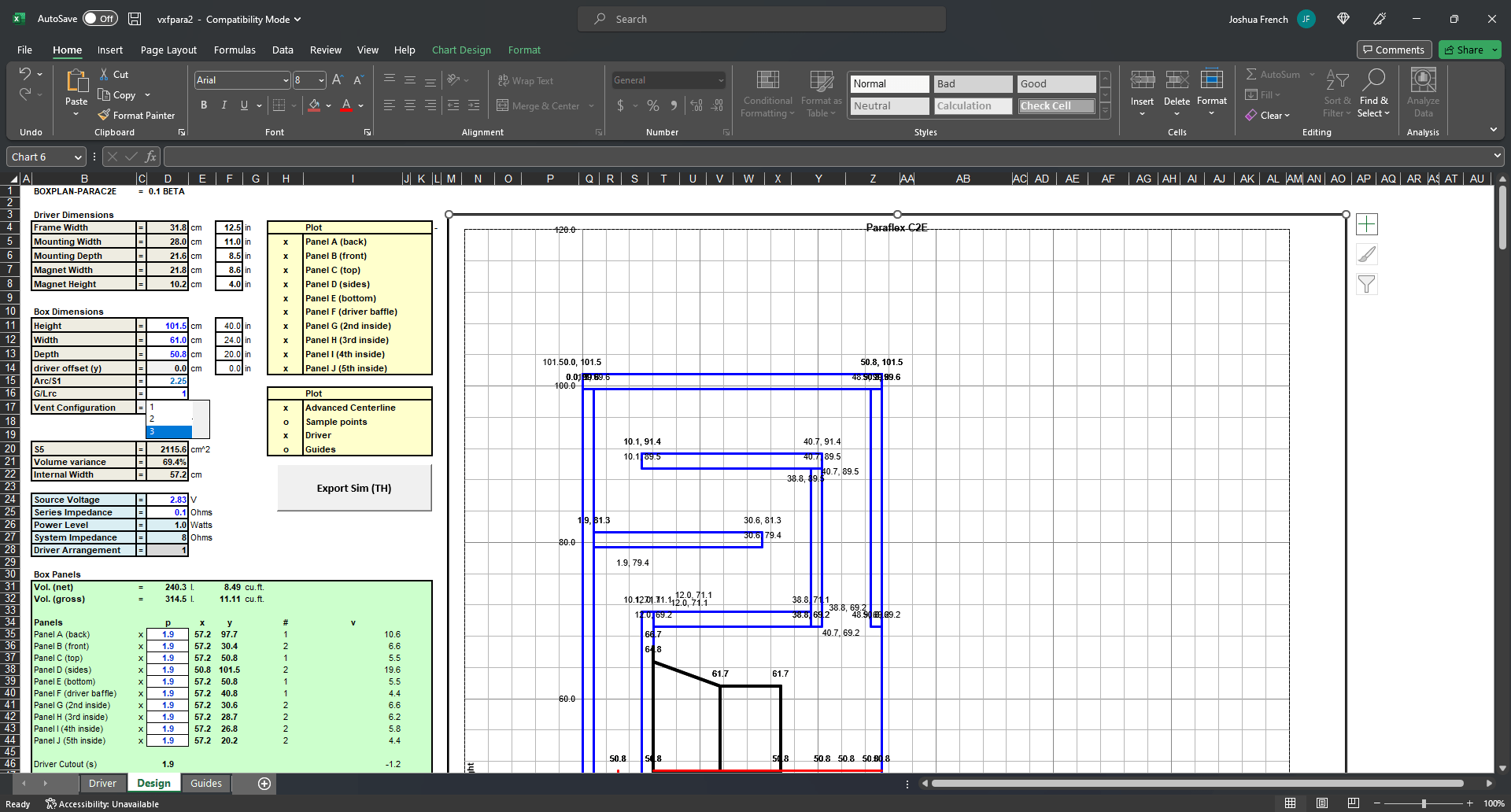

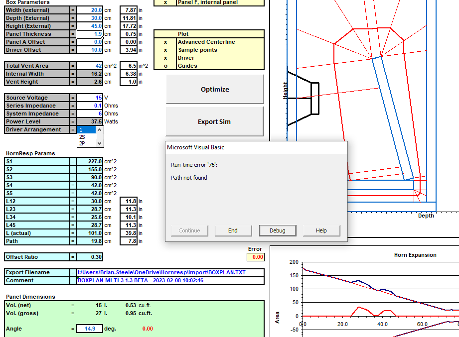

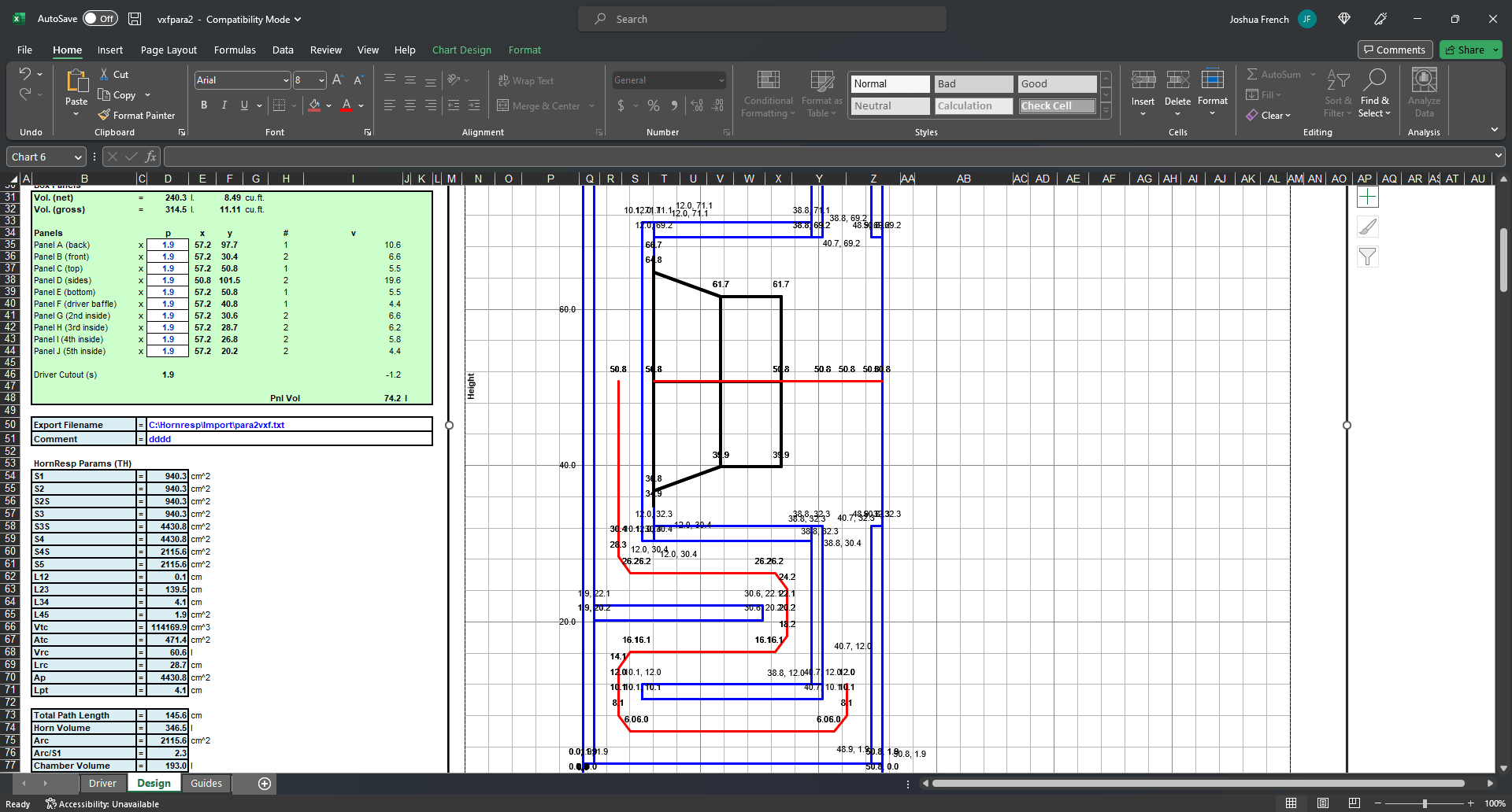

Started to manually design my folded tapered TL, and quickly realized that I need some help! Figured that MLTL3 spreadsheet was closest to what I wanted. Things went along pretty good until I tried to export the sim and got a VB run time error. Let me know if there are more details you need.

That's one of the older workbooks that doesn't check to see if the information that you entered in the "Export Filename" cell is correct. Change it to "C:\Hornresp\Import\BOXPLAN.TXT", which should work if you've got Hornresp installed in the default location on your PC.Started to manually design my folded tapered TL, and quickly realized that I need some help! Figured that MLTL3 spreadsheet was closest to what I wanted. Things went along pretty good until I tried to export the sim and got a VB run time error. Let me know if there are more details you need.
Thanks Brian - of course the solution was right in front of me!
Works fine now, imported into HR for confirmation and more tweaking.

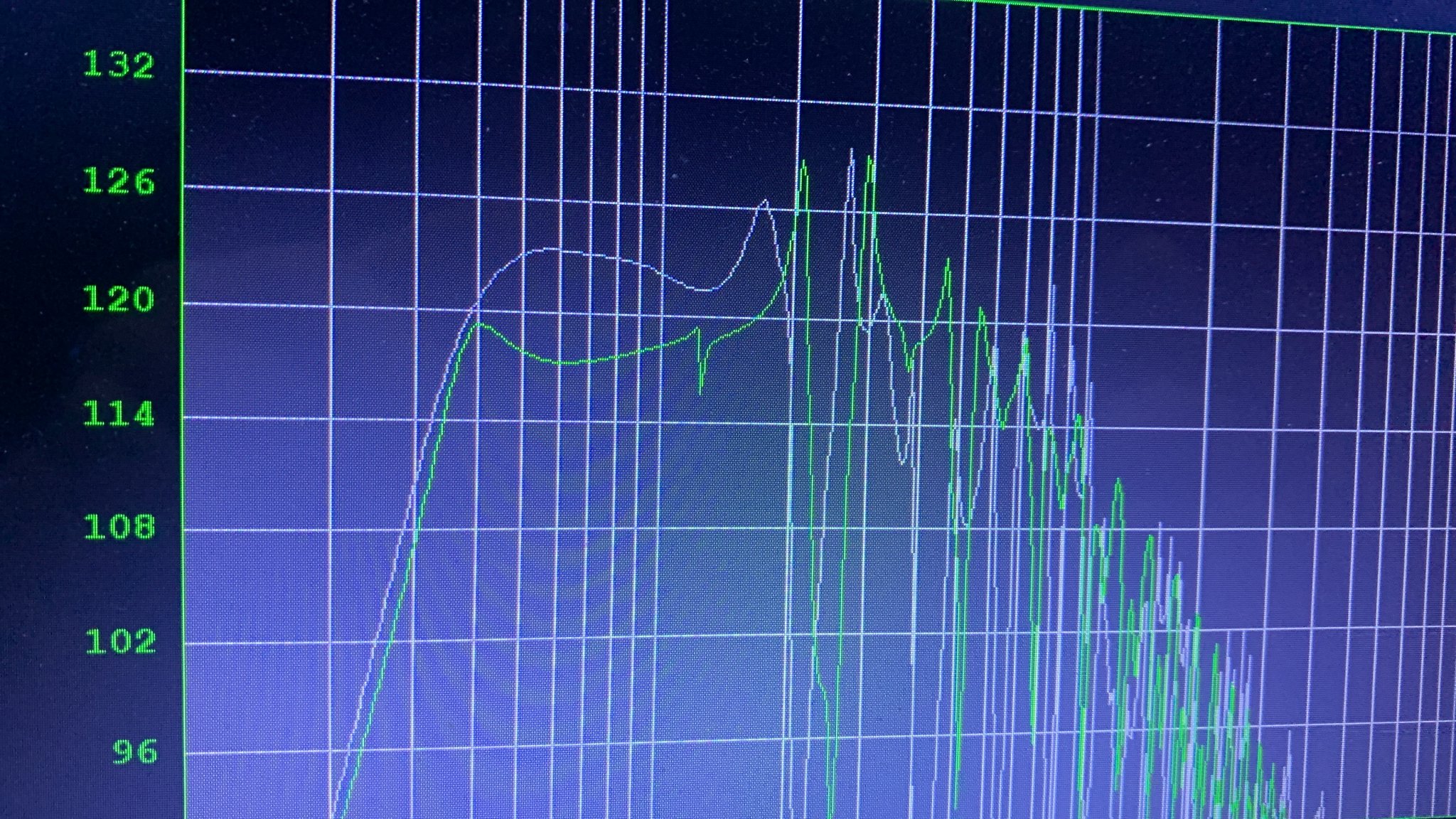

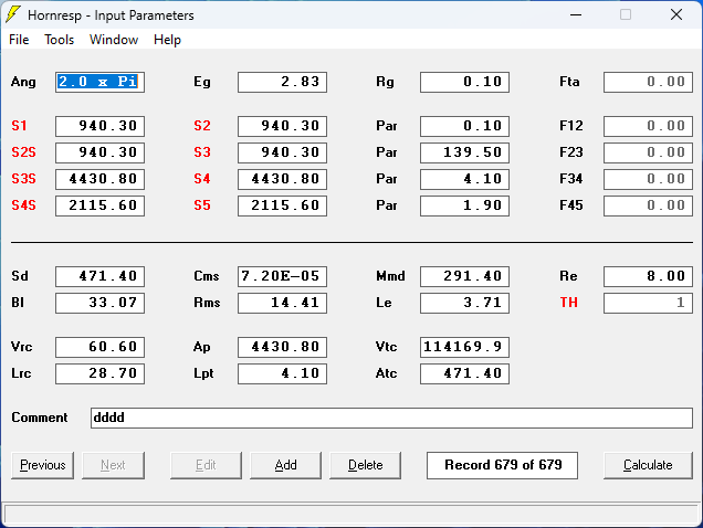

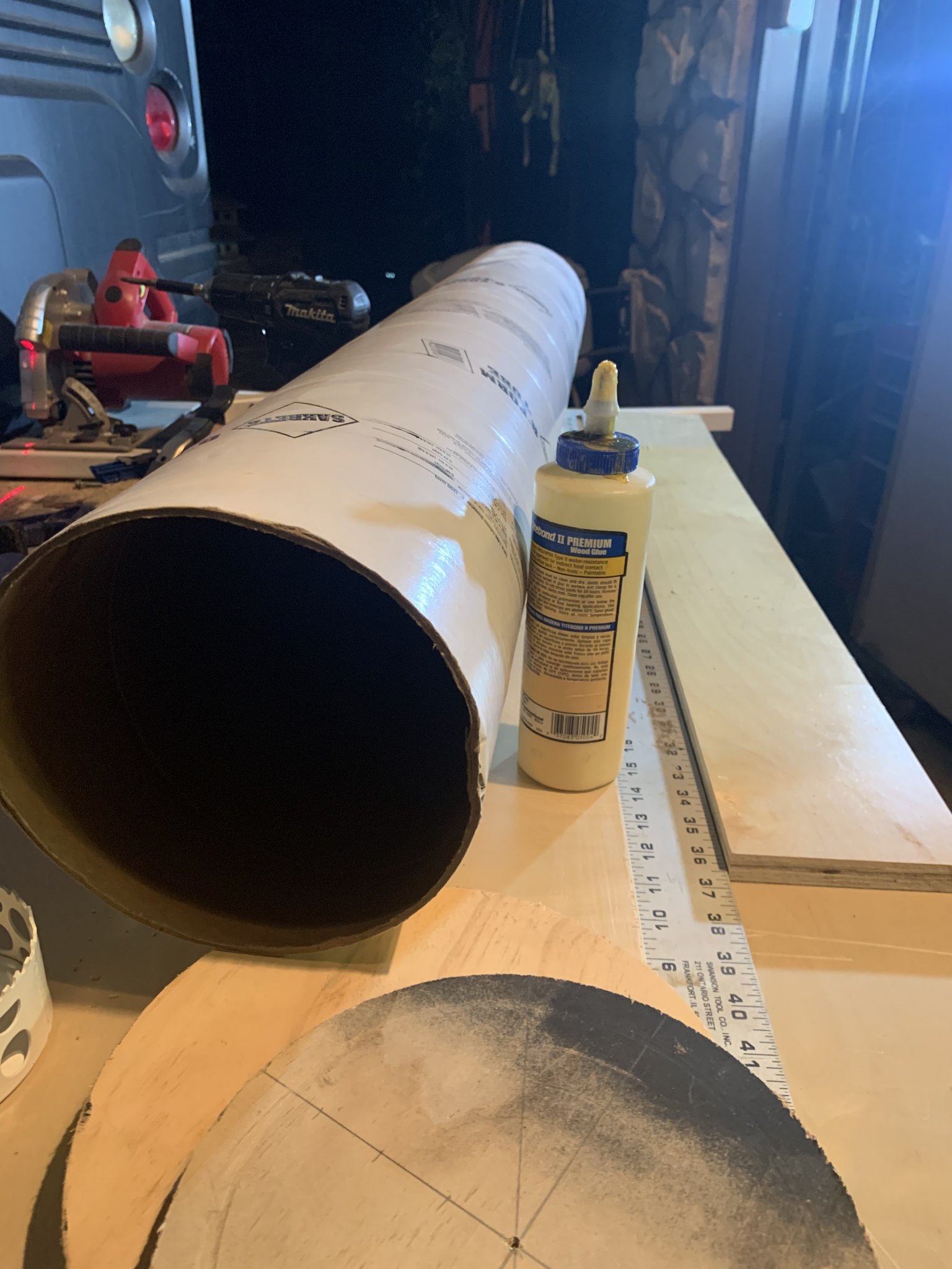

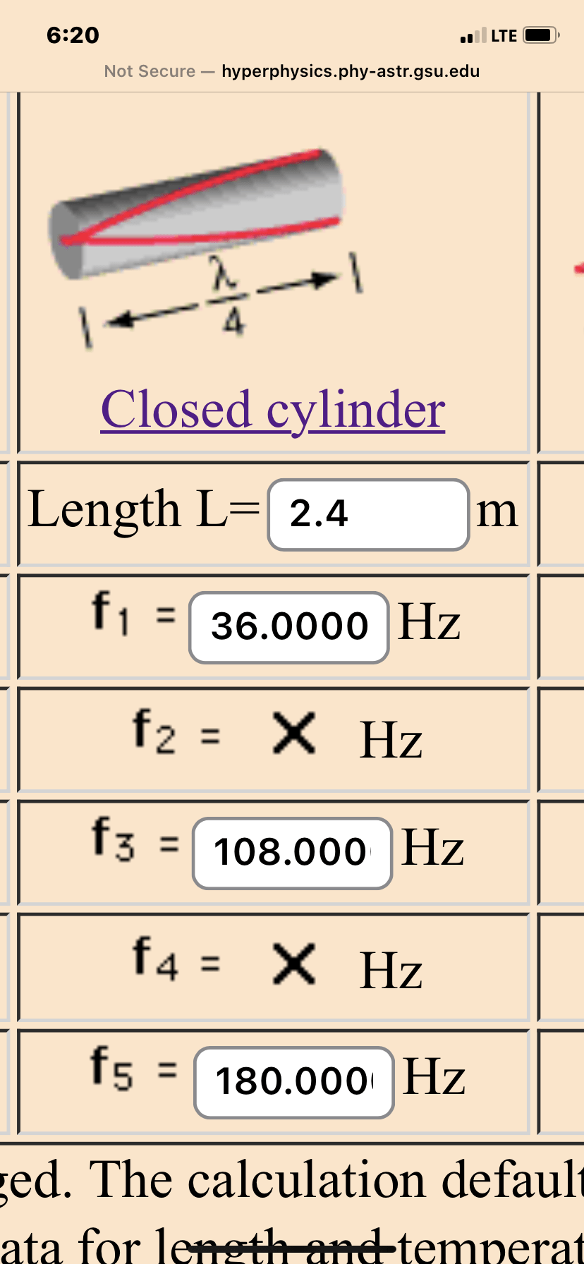

So i built this enclosure which sounds great however i 45d the corners to maintain the same dimensions throughout the entire enclosure and used some dowel rod for bracing throughout it. My thing is my frequency response is the not what hornresp showed i would get. If you shifted the graph up 10hz then that would be what i got it. I am trying to figure out how my results didnt come out as planned. I was thinking maybe it was due to a loss of volume when 45ing the corners and with the bracing but im not sure how that could be because if i make the dimensions smaller for the enclosure in boxplan and then move to hornresp it shows me getting an even lower frequency response than what i was going to get with this size. Some how i lost alot of the low low end I was really wanting. Any ideas?
Yeah, don't use 45s in corners - that cuts down the volume of the box, which in turn will reduce its efficiency at low frequencies. Using 45s in the corners will also shorten the path length and raise the box's Fb.
Use of dowels shouldn't make much of a difference, unless you used a LOT of them in your build,
To do a decent comparison between the sim and the build, take an impedance curve of the completed system and compare it to what Hornresp predicts. What you're looking for is that the peaks and dips are in the same locations as predicted by Hornresp.
Finally, that Hornresp model doesn't include the effect of losses, so the output might roll off a bit earlier than suggested by the sim. The better the box is built, the less output will be lost due to losses.

Maybe I’m dumb but how do I take the impedance curve because I’ve just been building these boxes and going off of ear and using burp tones to know what it hits and gets out of it. 🤷♂️ I’ve tried to do research but I’d rather just know from a correct source than to just google some ****. As far as losses it’s a great build it’s my 3rd one and the first one that sounds wonderful, I just under estimated the bracing needed in these style of boxes on the first couple along with some other learning aspects lol
Use DATS, or Room EQ Wizard with an impedance-measuring jig. A Google search on both should provide more details.

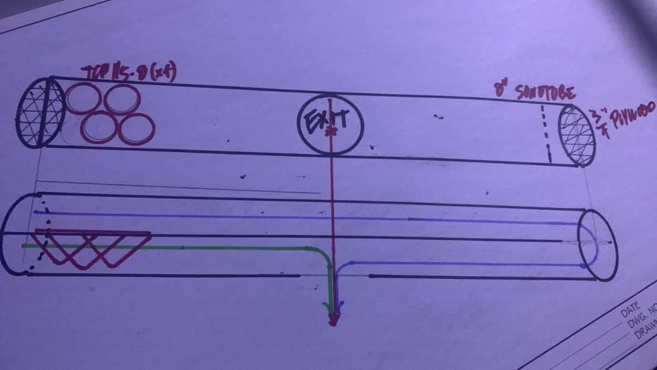

Hey Frenche95, did you try using 1 of the PH functions in HR? Your design looks like a paraflex enclosure, which looks like a BP6S but acts like a BP6P due to the 3 exits being so close together.
