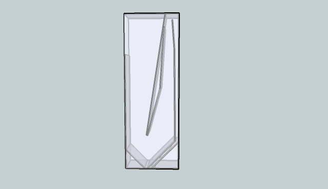

Maybe in your copious free time you could try this fold. I did this quite a few years ago. Works well for seriously long horns and even for shorter horns. If the driver needs a larger volume behind the woofer you can couple the wasted corner on the left easily enough.

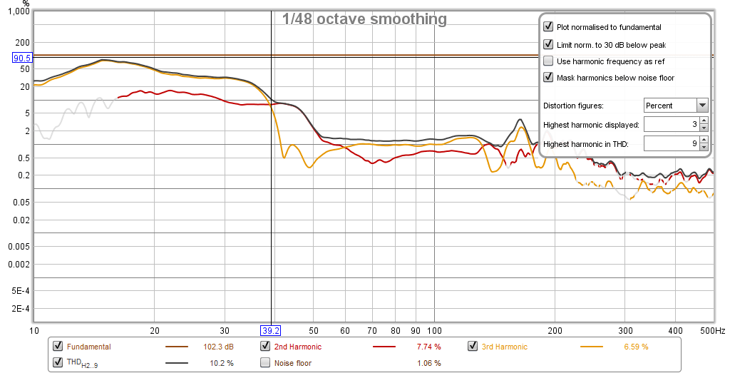

What I am referring to as a resonance, is a spurious addition to the initial signal input. A bandpass enclosure as well as a tapped horn do exactly this. Harmonics generated at a differential frequency between the tuning of the upper and lower peaks are what is generated.
If that was indeed what was happening, a THD plot of the output of a bandpass alignment would show high THD.
That's been entirely the opposite of my experience when measuring my BP builds, where THD remained low, sometimes VERY low, down to the frequency where the low-pass filtering feature of the design was no longer effective, e.g. a bandpass design with an upper cutoff point of 100 Hz was very good at filtering distortion at 50 Hz and higher, but not so good at filtering HD below that level.
Example - the picture below is from my "Enigma" build, driven at a voltage level high enough to cause the driver to exceed Xmax. Notice the flat THD profile from 50 Hz up? We're talking ~1% THD - at 70W, the point where Hornresp predicted that the driver would start to exceed Xmax. This particular BP design has an upper acoustic cutoff point just above 100 Hz. And that blip around 150 Hz? Caused by the circuit board rattling in the box, subsequently fixed 🙂
FWIW, I use the THD response to determine the best HP filtering for the build. For this one, filtering out everything below 30~40 Hz proved to be effective.
Oh, and all bass horns are effectively bandpass designs 🙂
