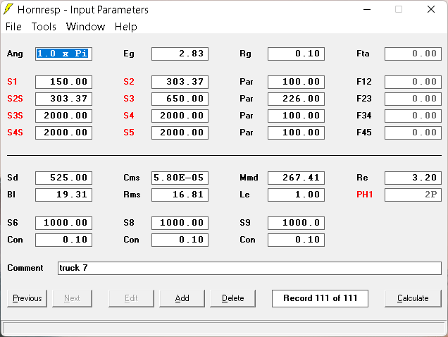

Hi, please post the Design input screen, thanks. It should like the screen capture below...

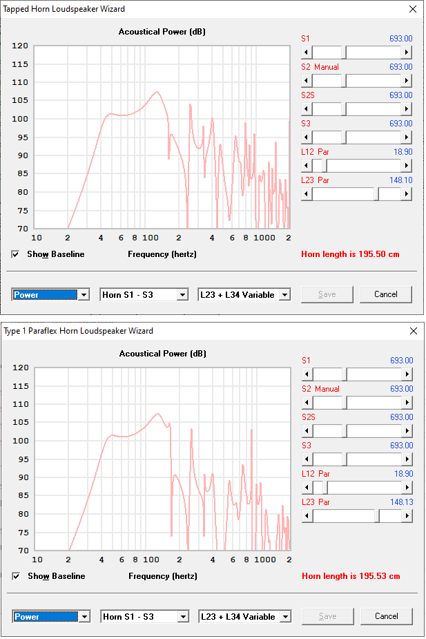

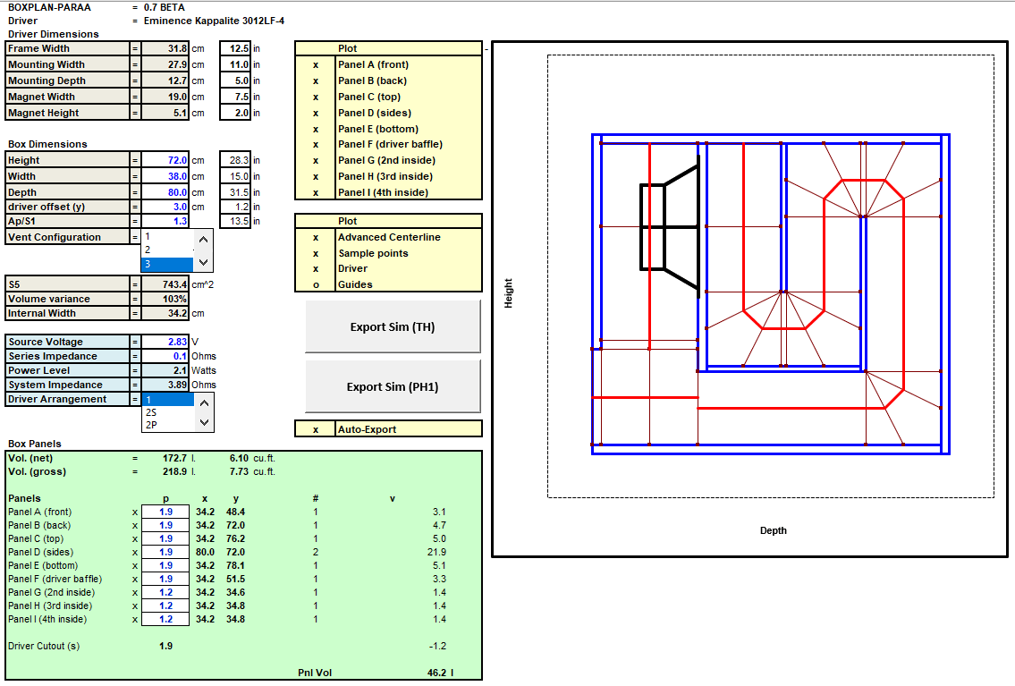

I used your input values for the box dimensions and I got this:
Basically identical at lower frequencies. Note that the version of the workbook I used is 0.8 though. I suggest trying again with the latest version of the workbook from the website, to see if you run into the same issue again.

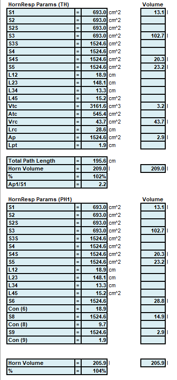

I got the same exact results as before, I even went and deleted all my saved files and the original para download, I deleted all my files form hornresp import folder just to make sure something wasn’t getting crossed. I’m so confused lol how did u get different results than what I did? …..I just need to learn the hornresp program better where I don’t need a boxplan, I just need to be able to wrap my mind around what I can manually input in hornresp, and honestly I’m almost there it’s just hard because I don’t fully understand what is considered s5,s6 etc. if I just knew what measurements went where I could do it on my own but I don’t and there’s no where to learn it. I just keep hitting these dead ends and it’s frustrating but I guess that’s why it’s diy lol I appreciate ur help I’m just at a stand still I need to be able to pay someone for a class! Lol
I think the issue that you ran into is fixed in the latest version of the BOXPLAN-PARAA workbook, version 0.8
Here's what that part of the spreadsheet looks like in the new version
Check the difference in predicted volumes for the horn. The version of the workbook that you used shows the horn volume for the TH model as over 300 L, and significantly higher than the horn volume predicted by the PH1 model. With the newer version, the Horn Volumes of both models differs only by 3.1 liters.
Hi Brian,
From a Hornresp perspective it is reassuring to see that your boxplan-paraa.xls system can be modelled as either a paraflex horn or a tapped horn, without there being a great difference in the results.
To avoid ongoing confusion however, it could perhaps be worth considering removing the TH export option from the spreadsheet 🙂.
Just a thought...
Kind regards,
David

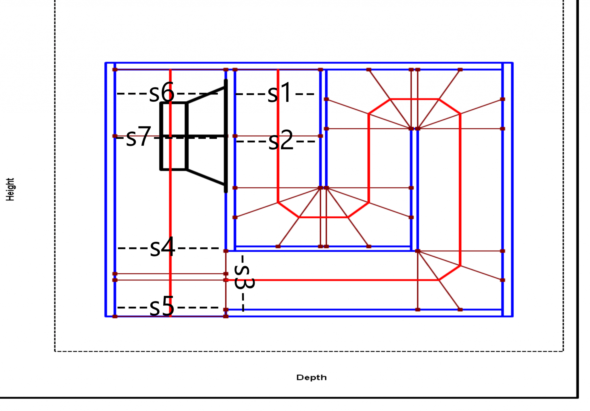

from this picture if i did the arrangement how i wanted with the vent coming out of the side of the box, (how do i explain this? basically what you have labeled as s8 and s9) if i used the side on the enclosure directly across from them, how would i label the box at that point?
Just a thought...

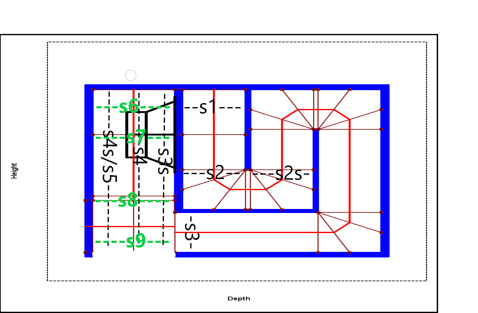

Another question and this is just me trying to figure things out, not saying this would work just another day of many hours banging my head on the wall lol jp not really just doing what i love but anyway
using these numbers
i tried to draw out in a very rough form lol what i could make this look like
ignore the s labeling that was from something different. However, in theory would this layout be correct with using the given number from the hr pic? the parts filled completely in with blue are just nothing they would be just unused space inside the enclosure.

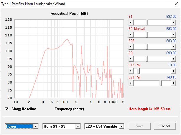

David introduced the ability to define the path along along a horn in a series of abrupt steps rather than an expansion from step to step. "S2" and "S2S" is how the abrupt increase in CSA is defined in the Hornresp model. For example, consider one section with a CSA of 100cm^2 (S1-S2) and another that's 200 cm^2 that are joined together at S2. In that example, S2 would be 100 cm^2 and S2S would be 200 cm^2.
So s2s is basically telling me how large it needs to be after the joining of s1and s2, before you would move on to where s2 and s3 would meet?
S2 is at the driver's axis. S2S works out to be the same as S2. It's only from S3 onwards would you see sudden changes defined by S3-S3S etc, depending on which configuration you select for the mouth. The challenge with this particular workbook was to come up with one "model" that could be used to describe all three mouth options.
Ya I got that s2s was the same given the specific numbers That I was working with, i just labeled it like that trying to show that would be were s2s would have been found if I didn’t have the same numbers for both. Well if that picture is labeled correctly then I am stoked! I feel like that was a huge step foward in understanding taking numbers from HR and turning it into an enclosure design. I appreciate all your help, and I’m sure I’ll have more questions soon enough.
