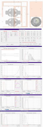

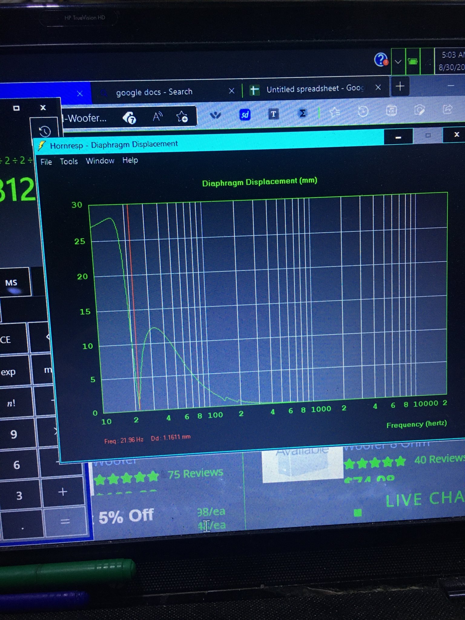

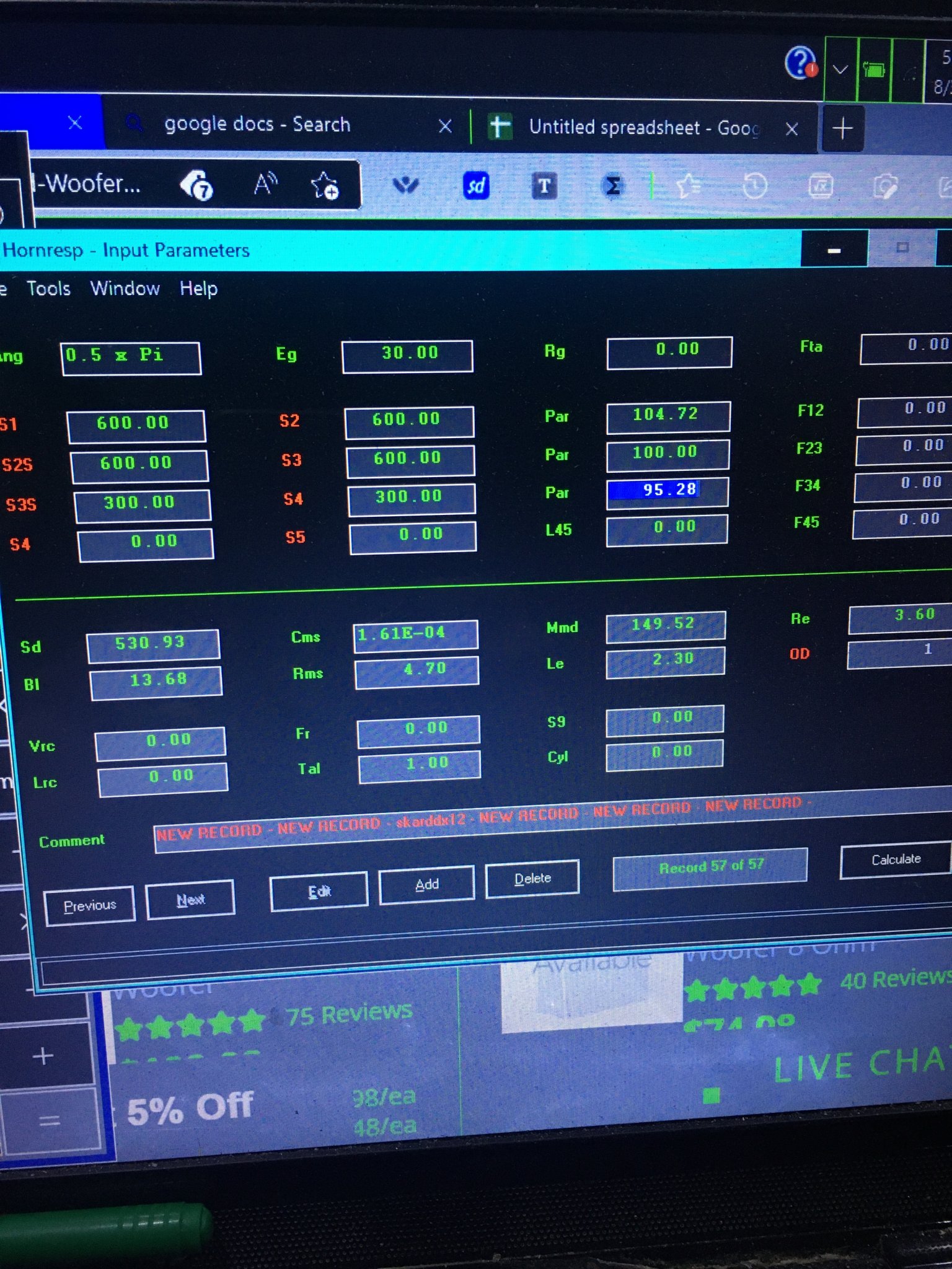

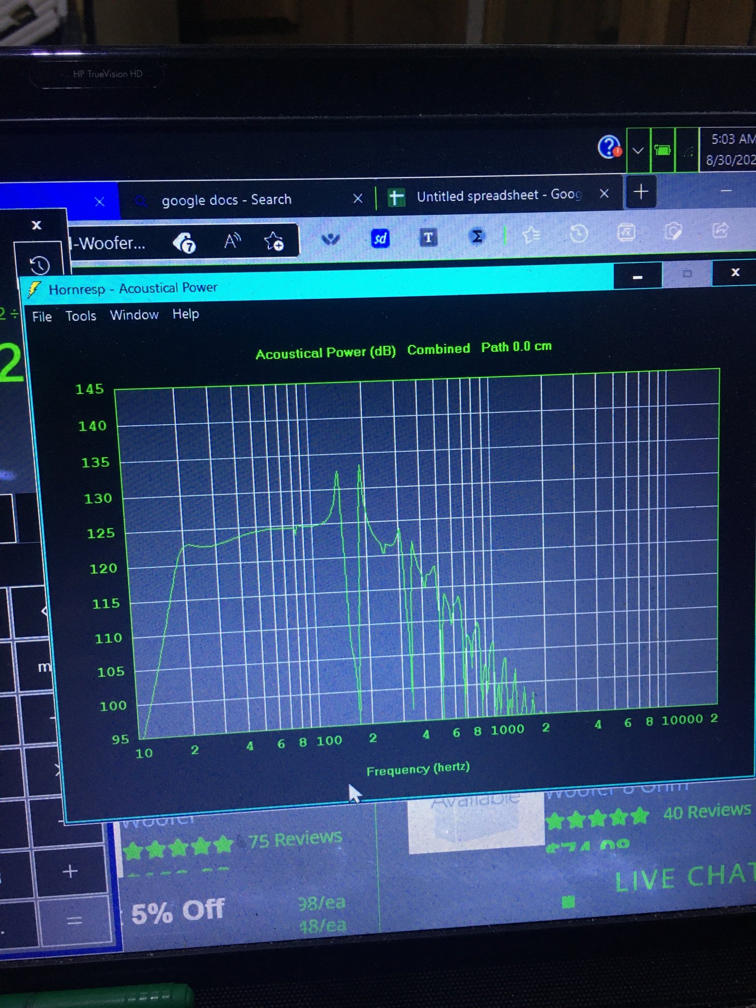

I am helping a friend with a Tapped Horn design. I promised him something simple to build. Could you please add this design to our spreadsheets?
Another friend wants help simulating a backloaded horn. I found this interesting paper by King, containing two simple to build compact back loaded horns. Please consider including them in box plans. http://quarter-wave.com/Horns/BLH_Design_Article.pdf
