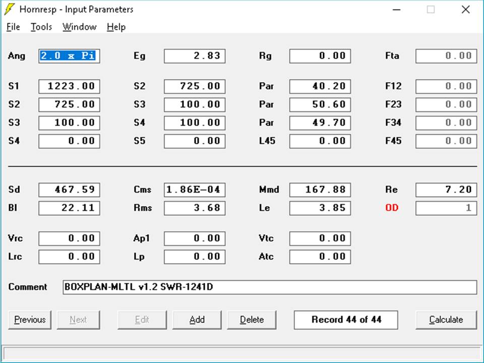

Hi Brian,
Many thanks for this. I double clicked the ENG field in Hornresp and adjusted the ohms down to 4 which dropped the volts and the SPL.
The parameter you want to adjust is the Eg parameter, which is the input voltage. It should be set to 2.83 V, as it should be in the workbook's "Design" page as well. It should only be increased if you're looking to see how SPL changes with input voltage, or trying to find what input voltage is required to exceed the driver's Xmax.
The "Ang" parameter should also be set to 2xPI, for comparison against other box-design programs.
I wonder then, what am I getting with an MLTL over a regular BR?

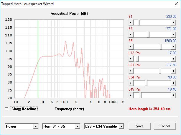

The newest addition to the design workbooks is one that can be used to design a TH that's folded like the "Microwrecker" (see attached image).

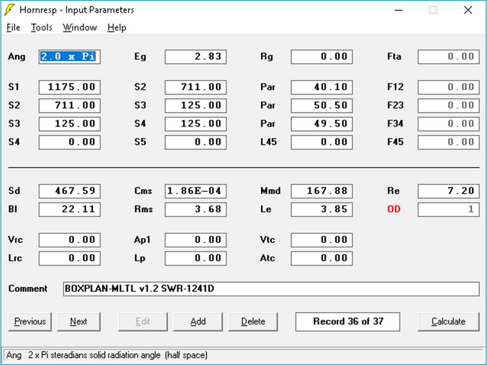

MLTL - SWR-1241D
Hi Brian,

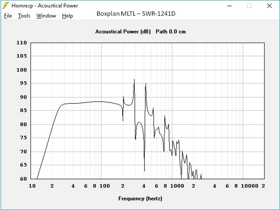

I managed to pick up two Alpine SWR-1241D's for the cost of a carton of beer and hoped you might eyeball my MLTL design before I buy wood and waste a lot of time! 😉
I had to bring the S3 down to 100cm2 to get a nice flat response like this. That makes the "slot port" about 3.5cm tall which with a HPF@20hz I think this should be fine? i.e. no noticeable chuffing. I raise this as you made specific comment about this in your nice Boom Box POC write up.
Am I missing anything here?
Thanks heaps, your time is very much appreciated!
Hi Brian,
Hi Brian,
I managed to pick up two Alpine SWR-1241D's ...
I suggest measuring the semi-inductance parameters for those drivers before proceeding with a build for them. Their varying inductance across the passband is going to impact the frequency response curve.
100 cm^2 vents are a little small for those drivers, considering their Xmax capability. Flaring or rounding off the vent a little might help.

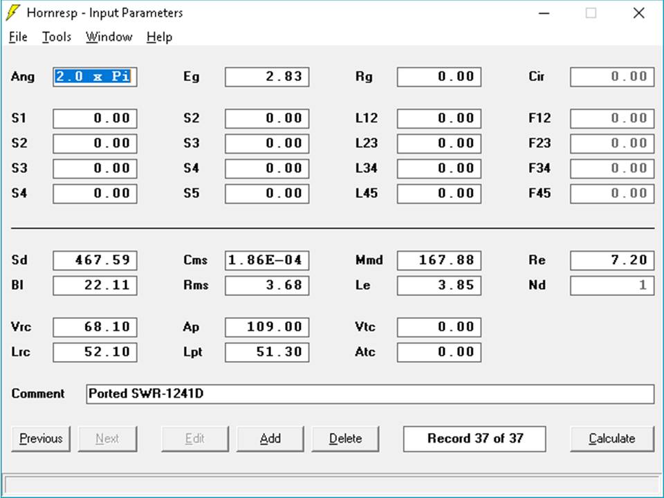

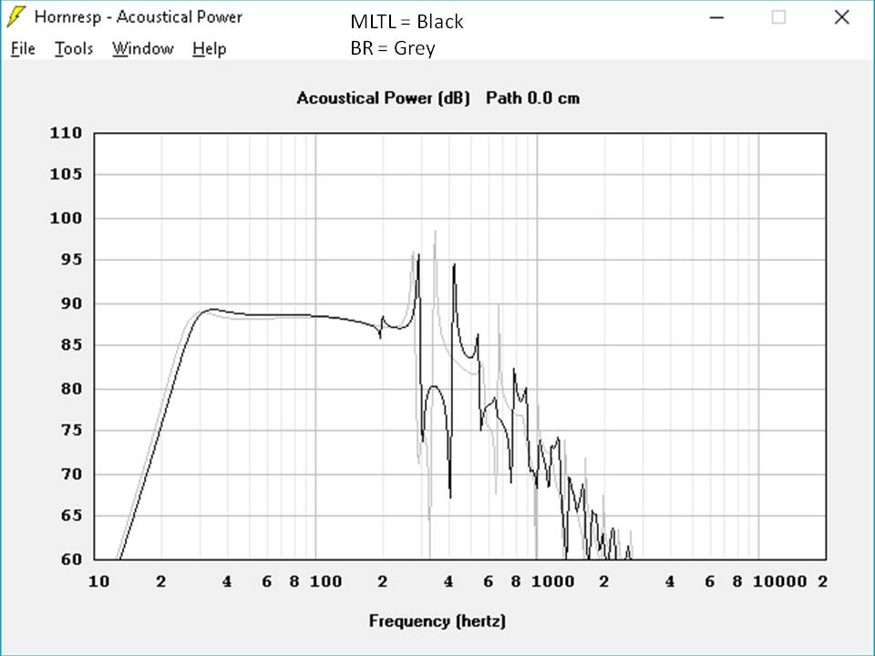

MLTL vs BR
Hi Brian,
After re-reading your great diysubwoofers.org I learned how to model BR in Hornresp!
Thank you!
So, I figured I'd model the SWR-1241D in Hornresp in nearly identical sized boxes with very nearly identical slot ports in both MLTL and BR configurations.
When I look at the similarity of the modeled response between the MLTL and BR I'm wondering what advantage I get from the added build complexity of the MLTL? I'm sure I'm missing something!
Hi Brian,
Thank you!
With an MLTL, you can opt for larger vent sizes and manage the effect of the pipe resonances. Plus, converting the box into one big folded vent makes for a sturdier box 🙂

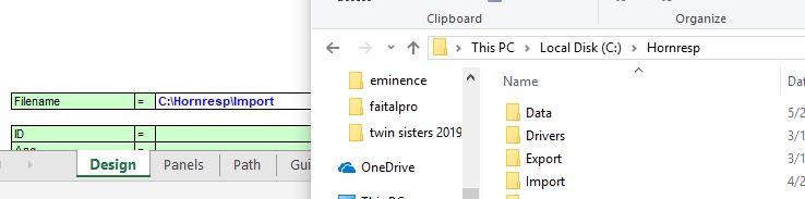

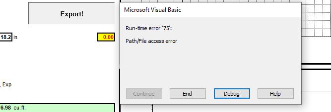

run-time error
Hi Brian,
Thanks for the spreadsheet.
Single Sheet style fold.
When I Export the error come up what I am doing wrong?
Am using W10.
Thanks,
Hi Brian,
Am using W10.
Thanks,
