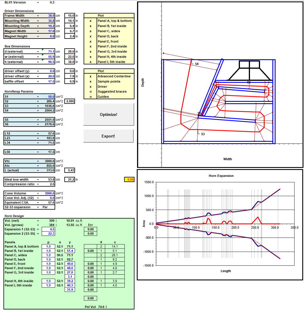

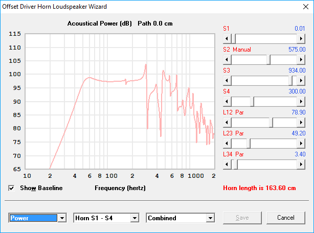

An offset rear-loaded horn...

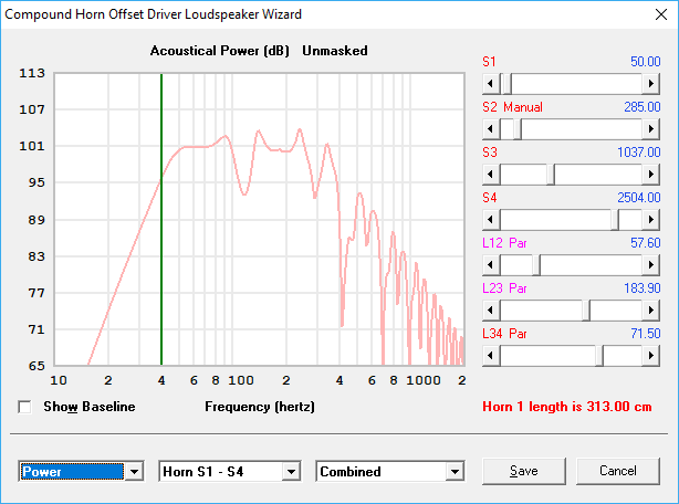

This was an attempt to deal with the "notch" in the rear-loaded horn's response by offsetting the driver a bit. Obviously it's failed (at least this particular configuration), but maybe I can re-jig this workbook to do something else. Any FLHs that have a similar folding pattern?

Generally when I design a back-loaded horn I make the cabinet about 45 to 48 inches high.

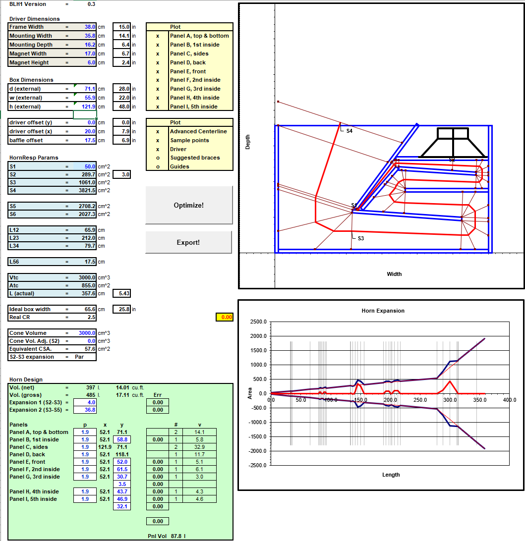

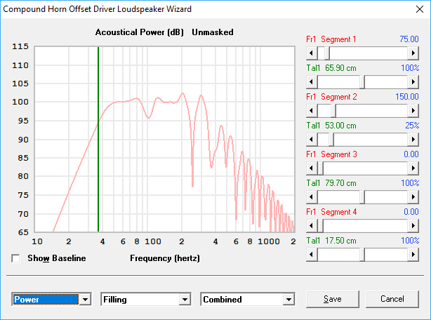

It looks like for an RLH, you've gotta go big or go home. I increased the height to 48 inches, and the "notch" in the sim is now about 3dB (once the region from S1 to just past the driver is properly damped). Fb is around 38 Hz though, which seems to work well for this particular driver (a 15" PA driver).

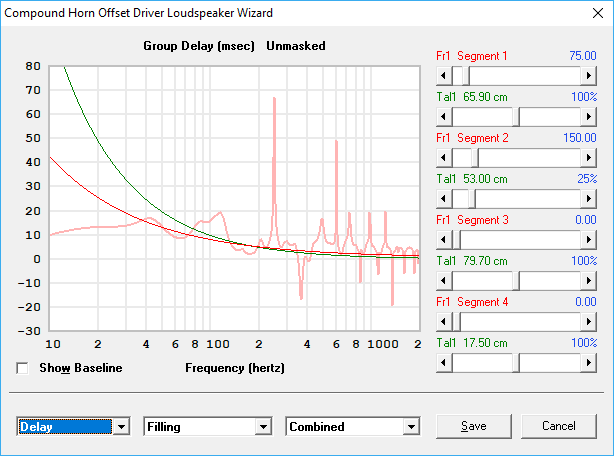

I can see though why these things (bass RLHs) are referred to music producers rather than music reproducers. The GD between 70 Hz to about 150 Hz is not the best.
What purpose does the compression chamber in a RLH really serve? Most of the RLH layouts I've seen have the throat at one end of the compression chamber, rather than the center, which means that the offset of the driver in the compression chamber isn't taken into consideration in the sim. I was therefore trying to avoid using one.
This is basically acting as a capacitor in a crossover for a woofer. It's a low pass filter done mechanically. It has a large benefit if done correctly in keeping out the midrange coming out of the horn mouth. Group delay is a bit over stated in it's audibility. Actually a lot over stated in it's audibility. In normal music program material it is pretty much not noticeable. I have built very long front loaded horns that exhibited large group delay and it was never noticeable in actual use. It was measurable but not audible.
With FLHs, the situation is a bit different - all of the output is from the horn. With the RLH, there's output from both the horn and the driver. I tend to look at the change in GD over the passband, to get an idea of what impact it might have. The GD for this RLH rises to almost 20ms at around 115 Hz, before it drops back down to below 10ms at 65 Hz, and then rises back up again.

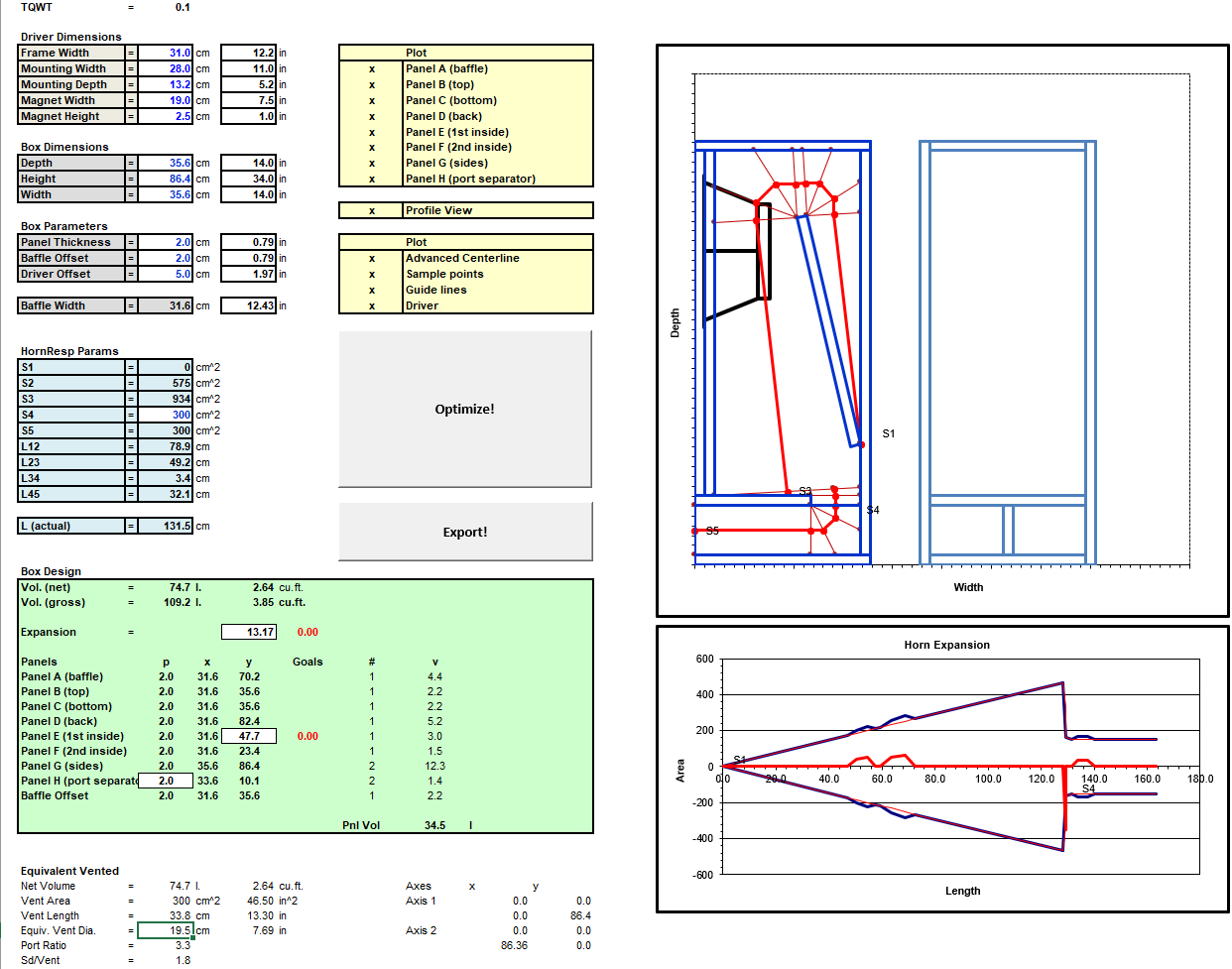

Another addition to the list - a workbook that can be used to design mass-loaded tapered quarter-wave tubes (TWQTs). I've found that this particular layout works well for getting the driver in the correct offset location to null out the first resonance.
