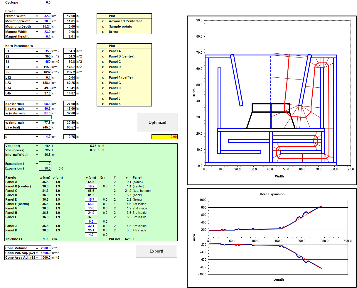

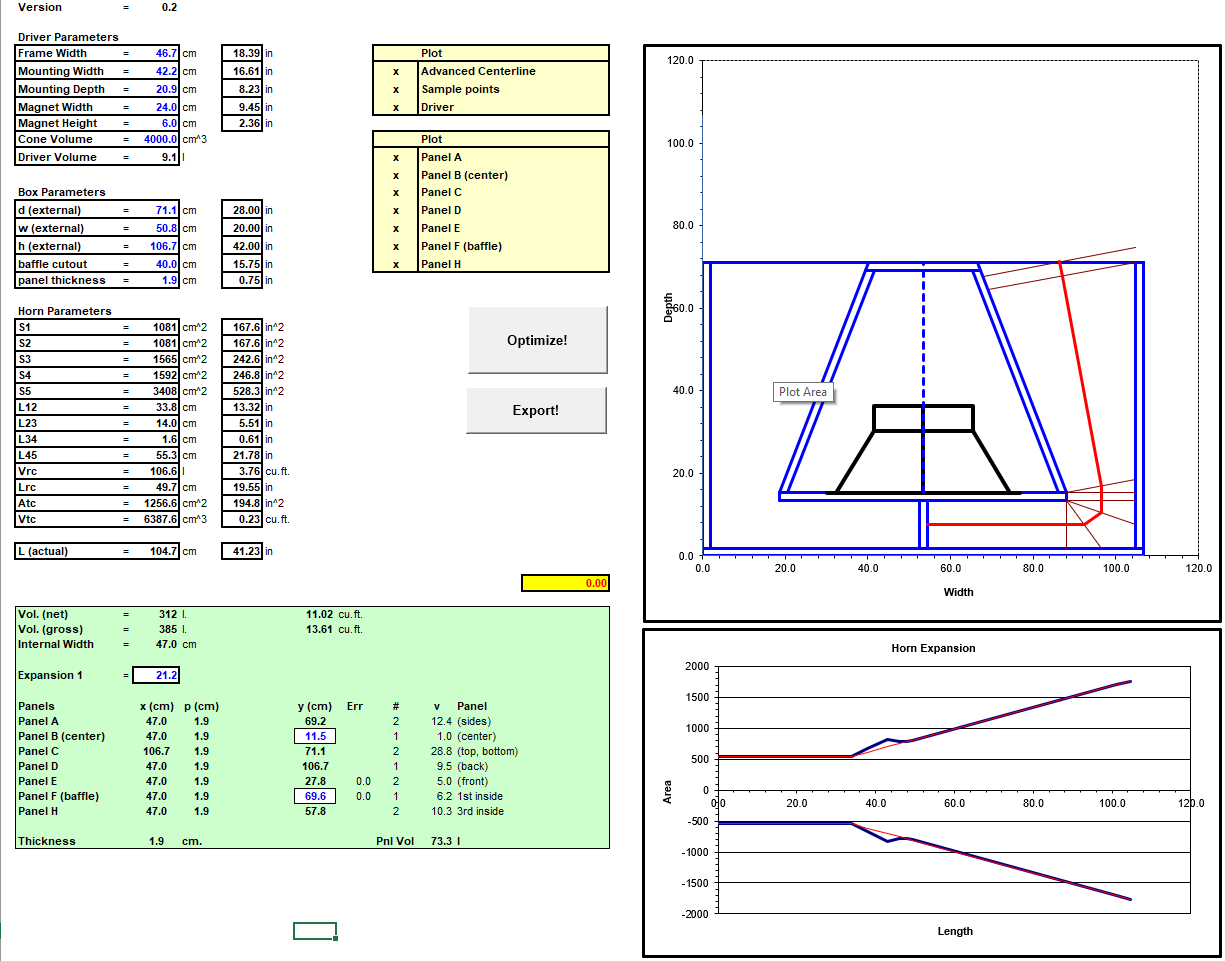

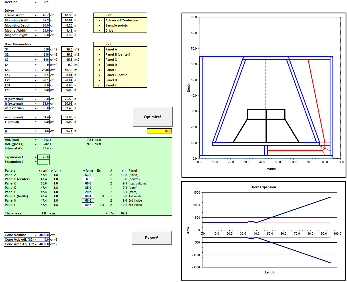

I thought for my first (and perhaps only) foray in to FLHs I'd try to put together a design workbook for the "W-Bin" type fold. A simple fold that's turning out to be a bit more complex than I thought to map out.

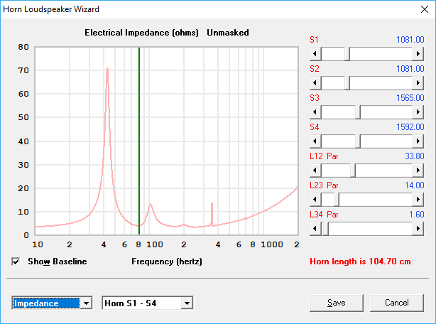

Anyway, here's what the workbook looks like at the moment. It's nowhere near finished - I might be able to complete it by tomorrow night - got too much else to do this weekend! I'm thinking about slot-venting it, and that will eventually be built into the workbook. Right now I'm working with an 18" driver in mind, but if you have any particular drivers that you want me to concentrate on for the first sim, let me know...

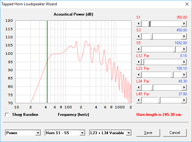

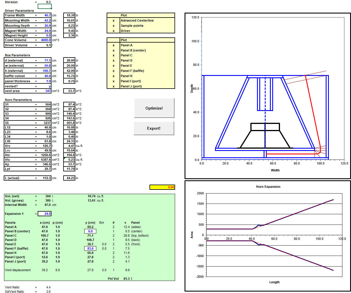

Looks like it's coming along well. Up to v0.3 now. I'm going to work on adding the venting to the chamber tonight. Some interesting things are coming out of the analysis, like this definitely looks like kickbin-type stuff.
Note that I didn't bother to continue the horn's taper right down to the throat of the horn. Simulating the impact of doing this in Hornresp didn't produce results that were any better than just adjusting the distance of the chamber from the back wall of the enclosure.

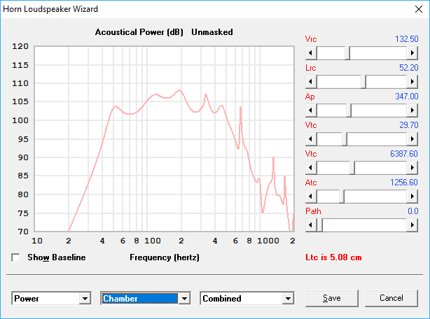

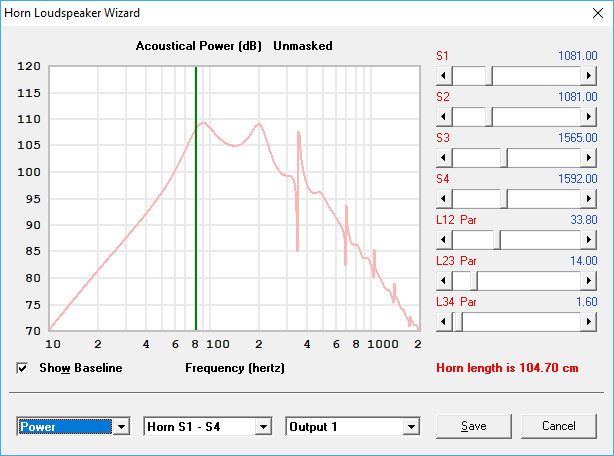

OMG, now I know why the vented version of the W-Bin was so popular as a bass horn - these things are LOUDER THAN BOMBS. Check the sim'd results of one that's vented to 42 Hz using one of the popular 18" drivers, in a box that's 42" high, 20" wide and 28" deep. Put it in a corner and the passband is at 115dB/2.83V/1M from 40 Hz to 200 Hz..! And my cousin has two of the damned things positioned like that in his small club...

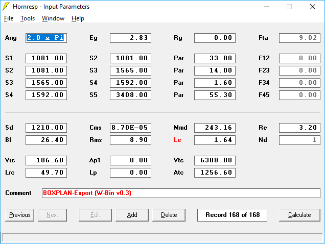

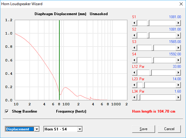

The workbook is virtually finished at this point. However the F6 (refresh) routine in Hornresp to reload the export from the workbook while the Loudspeaker Wizard is open doesn't seem to be working as expected. David, are you listening in?
Hi Brian,
The F6 refresh functionality works just fine with the test BOXPLAN spreadsheets I have. Could you perhaps post a zipped-up .xls version of your latest spreadsheet on the Hornresp thread, so that I can investigate further? Many thanks.
Incidentally, your recent "OD1 S3 Auto" request has now been implemented in Hornresp .
Kind regards,
David
Kind regards,
David

Hi Brian,
Kind regards,
David

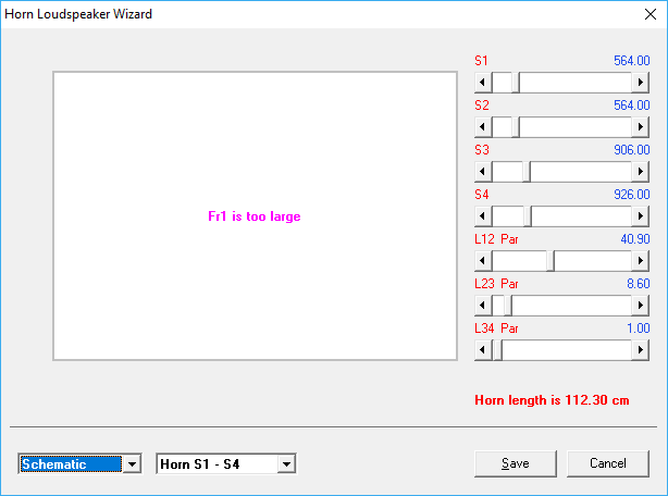

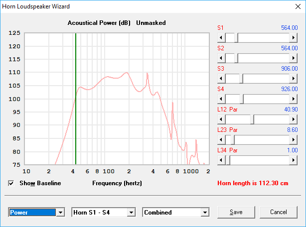

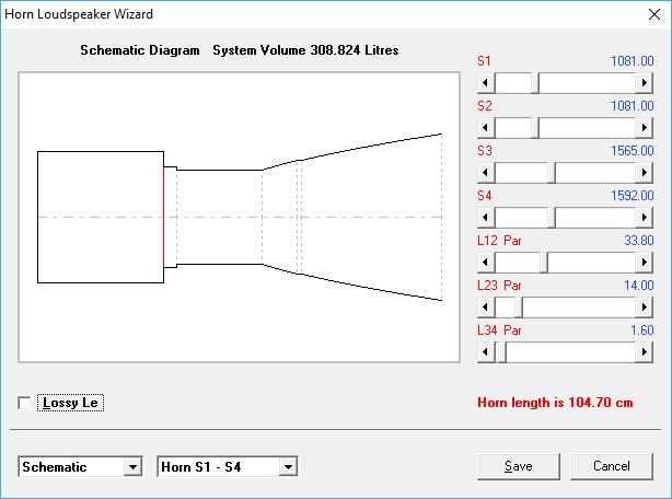

Hi David, see current version of the spreadsheet attached.
Three things I noticed...

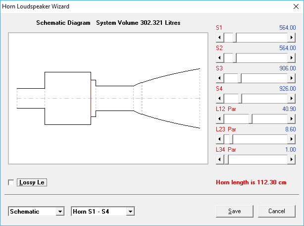

1. The "lossy Le" option is automatically selected. This is happening with all of the spreadsheets though, so I suspect it was introduced with a recent version of Hornresp.
2. If the Loudspeaker Wizard is on the "Schematic" option and you do an F6 "refresh", the schematic is replaced with an "Fr1 is too large" error, even when no changes are made to the import file before the refresh
3. If the value for Ap, is changed in the import file, this change is not reflected during an F6 "refresh" under Loudspeaker Wizard.
4. In Loudspeaker Wizard, "Vtc" is listed twice. It looks like the Ltc label was replaced by Vtc. I suspect that it does not change either during a refresh.
Thanks for the updates - I will have a play with them later today...
