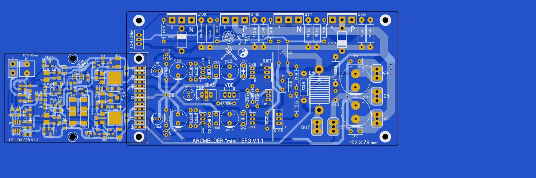

OK, "spookyamp.zip" is complete with BOM.
Next is the "mini" OPS. Familiar standard parts here...
OS
OS

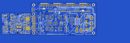

Patience , I'm taking my time to make sure of best parts and exact spacing's.
OK , Hell it will be .... I almost have the Mini done.
Yes , Hellraiser will be the "mini" stereo pair to run my Mission 8" 2 ways. It's a "masterpiece".
I'm choosing - TOSHIBA !! -
https://www.mouser.com/ProductDetail/Toshiba/HN1B01F-GRTE85LF?qs=iCzJi/IZBF6L5tumBXghYQ==
But even as the pinout is the same EBC , the P/N is reversed from the BCxxx (my original choice). Layout is correct if
you reverse the chip , that's all. I might flip the screen printing on the Gerber ... so there is NO mistake.
OS
OS

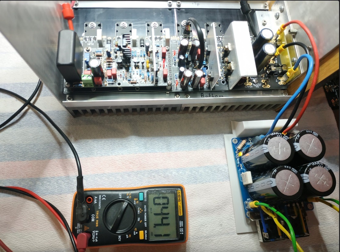

I could make separate L/R OPS boards. Luck ? No luck involved here - 100's of Wolverines are fine.
"Mini" can be at right angle to the HS. IPS's can then be right angled to the OPS. 3 different mounting options.
Builder (below) measured just about 1C (difference) with a "flipped" around L/R. Total Dissipation is the same but I bet the
bottom O/P's are the ones 1C cooler. "Consensuses" are typically subjective.
OS
OS
Please Pete,look at the bom that you have posted
I think that you have some errors.
Q3,Q4 can't be 55xx,i see dual package there
It could be confusing ? Regular 5551 is single , but FMBM5551 is a dual - https://www.mouser.com/ProductDetail/onsemi-Fairchild/FMBM5551?qs=VOMQJJE%2BBNnHm/5A44uOUQ== .
Q9,10 is the PNP - the FMBM5401 dual.
OS
OS

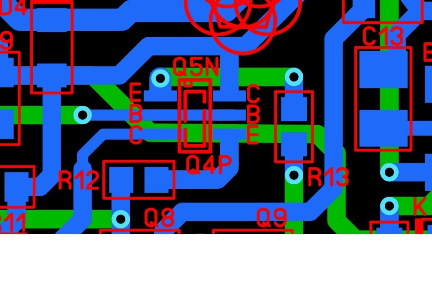

Hellraiser in red , as it should be ! If you use that Toshiba dual on your Hellraiser , note the P-N designationToday arrived.
on diamond buffer Q4-5. BCxxx dual is correct , Toshiba dual is reverse P-N. Toshiba is the better dual , I will use it
in the BOM and reverse the screen print around. Layout is correct either way.
PS - on the spooky (Q5-6,Q7-8) , the Toshiba's are a perfect match. On either you can use the BCxxx duals ,as well.
OS
