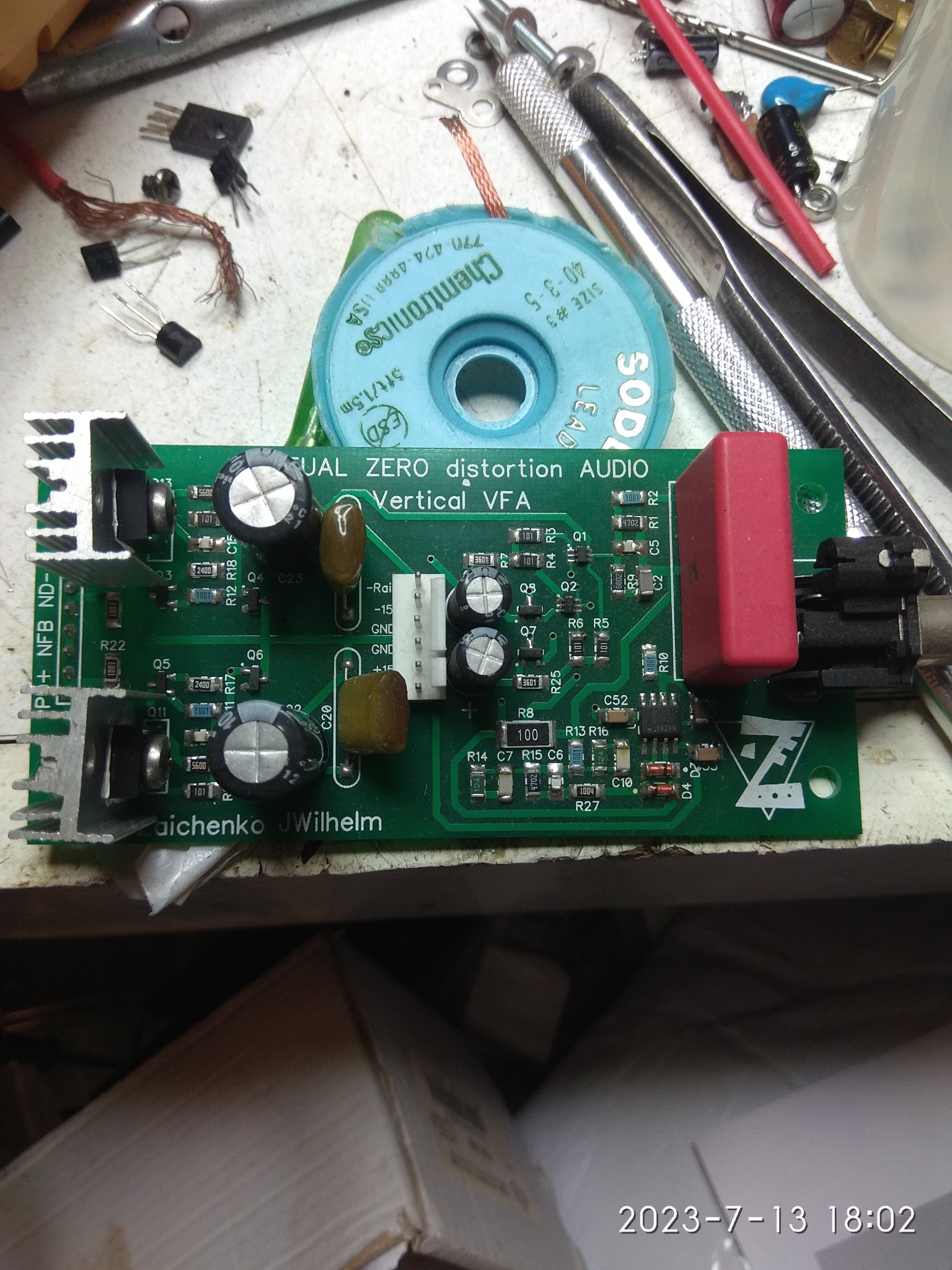

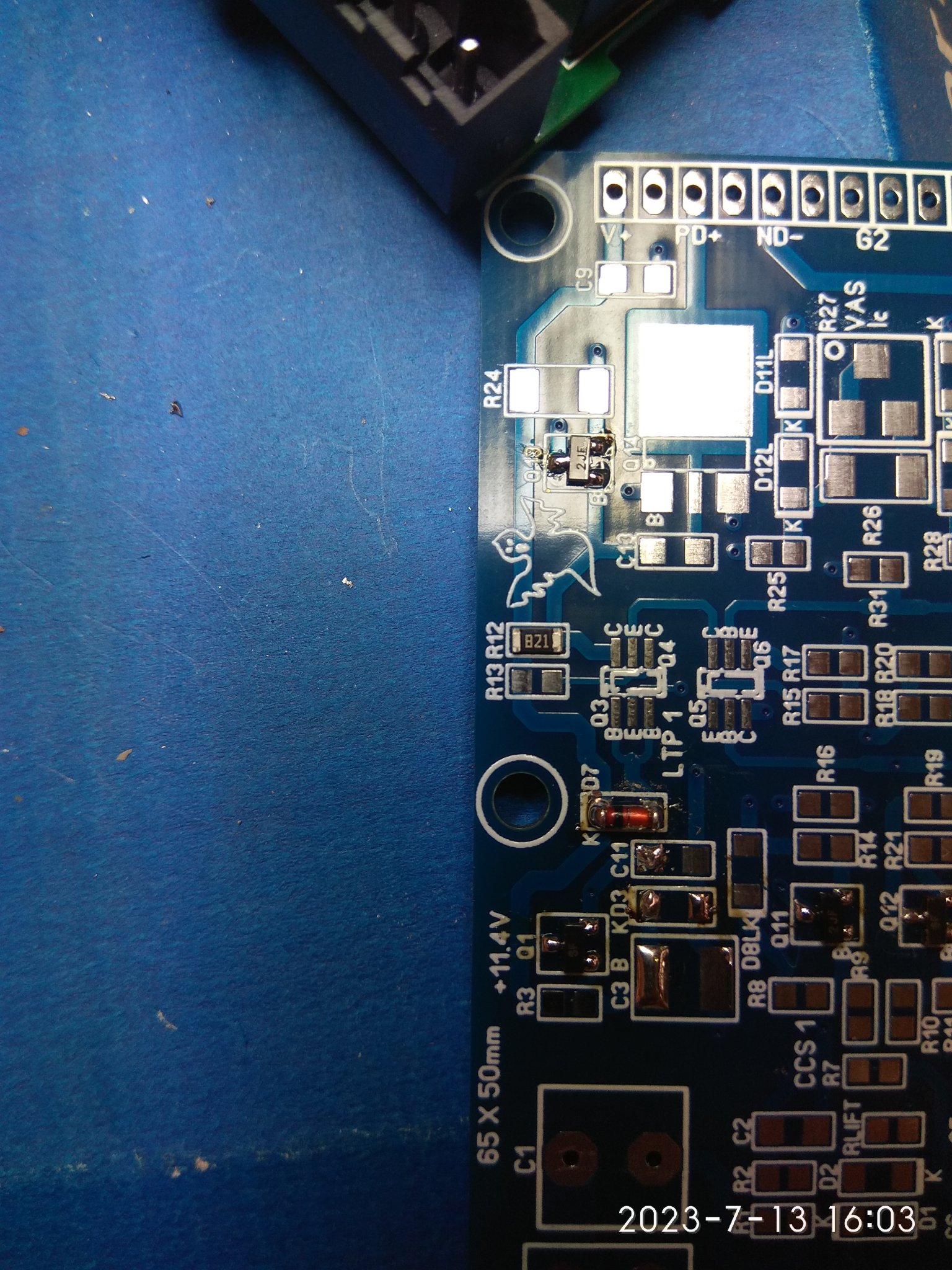

Lousy footprint for that "821" component, perfect layout my a$$, tell the designer to solder his own up first and figure out his mistakes before making others figure it out for him. Footprints for hand and wave soldering should have larger pad areas and extend well past the terminations so that the hot iron tip does not need to be in contact with the terminations which we all know is what damages them. Also a proper fillet is created.
It is wrong guys..
Hand soldering is impossible 😭
We don't speaking for solder paste not hot air gun.
Hand soldering need larger pads or smaller parts.

Yes, there is a learning curve for successful SMT soldering no matter what technique you choose. But there are techniques the designer needs to incorporate in the layout to facilitate the DIY'er in successfully assembling an SMT project. I fully agree with the layout tips and tricks that Rsavas points out. The only way to "get it right" is to learn from the mistakes and design the next layout better. IMO, this is a very aggressive project to take on for a first time SMT layout. The circuits might be well vetted but not the layouts of these boards, I hope the bugs get worked out because I would like to build this amp. 😉
Those input boards look familiar! Yes for hand soldering extended pads are necessary. I did a custom library for the boards I layed out. Paste can be used with a conventional iron too though, allowing you to work with pads like this.

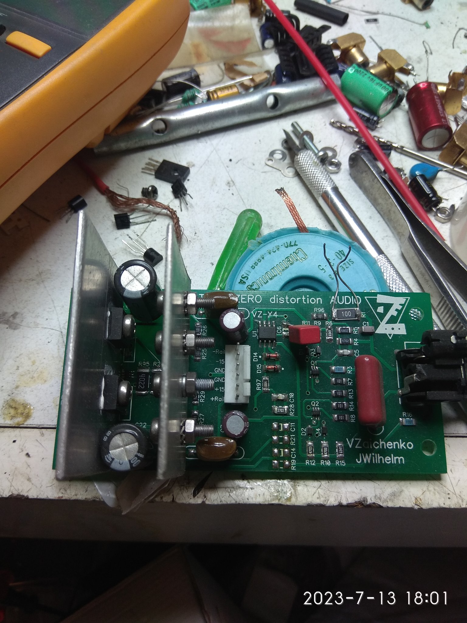

thimios ... sprint layout and BOM said 0805 resistor.Unfortunately,bad knews.
Wrong side pads.
Have a look at this 820R resistor.
It is impossible to solder.
Pads is completely under resistor ,no room for solder tip.
If that was a resistor I sent you it would have been 1206. I hardly ever used 0805. I went straight to 0603 for compact designs.
Kinda helps if you use the right size 🙂 get your calipers out and measure. I thought you are building with parts from BOM which is how one verifies the design and documentation
EIA 1206 is metric 3216
^ Also kinda helps if you actually open and review the files provided by the designer before making comments about their design work...
If I could edit my comments I would, now knowing that folks are not checking if they are using the right parts and me assuming that it is the wrong part footprint, so I apologize for making a wrong assumption, carry on

It's probably true that the layout design could've been a lot more DIY friendly, but it is definitely possible to hand soldering/rework. In tight areas and hidden pads where a soldering iron tip can't access the pads directly but the component has plated ends, pre-tin the pads, pile up the flux, use TWO soldering irons and heat the component ends at the same time, and you'll be amazed. Again, use a good flux and pile it up, there is no such thing as using too much flux. Do NOT use lead-free solder. Use 63/37 leaded solder. Set the tip temperature at 325C.It is impossible to solder.
