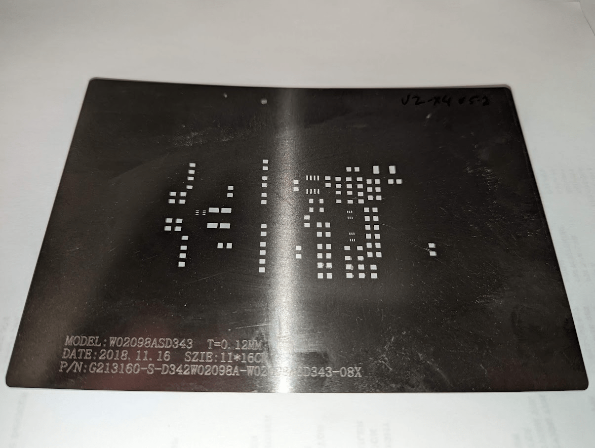

Here's what the stencils look like. You just spread solder paste across it with something with an edge like a credit card. The thickness of the stencil controls the amount of paste being placed on the board. After the solder is spread, remove the stencil, drop the parts on and bake.
One usually uses tooling or other mechanical holes for alignment of a stencil. So those holes need to be present in the Gerber data for them to be part of the stencil.

How do you make those stencils?Here's what the stencils look like. You just spread solder paste across it with something with an edge like a credit card. The thickness of the stencil controls the amount of paste being placed on the board. After the solder is spread, remove the stencil, drop the parts on and bake.

I wonder if JLC pcb has something like that. Probably should.My board house laser cuts the stencils when I order boards.
I tried applying the paste solder with small flat head screwdriver, but it is just too messy.
Yes, JLCPCB has the option to make a stencil when you're ordering the pcb.
