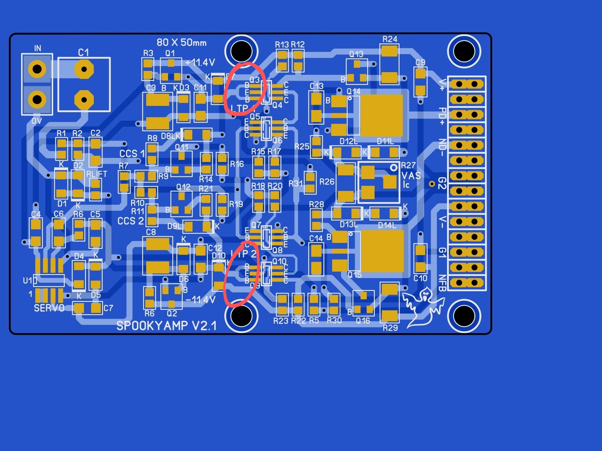

That looks nice ! Not a big problem , C13/14 might creep a little beyond the pad for a standard 33pF silver mica.
I could not find any SM packages (2mm X 3.2 mm) most are 2.5 X 3.2mm.
A better ceramic can be used here , https://www.vishay.com/docs/45258/vjhifreqseries.pdf
Many package sizes , use any 200V and up.
Here is one that will fit perfect - "exceptional HF + stability under harsh conditions" - https://www.mouser.com/ProductDetail/KEMET/C0805C330JCGACAUTO?qs=xZ/P%2Ba9zWqa07XbrwyUyaw==
2mm X1.5mm ....
Most of these IPS pads will accept multiple packages,
I have fined tuned the compensation cap pads on all the artwork to now accept that 3,2mm SM cap.
But , they are pretty expensive ( 4+$ apiece !! )

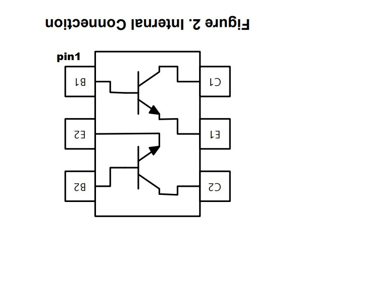

What errors ? (below) I know the fmbm5551(5401) pinout is strange ....Hi OS, I think there are two small errors on Spooky silkscreen.
pin1 = B1 , pins 1-6 = B1-E2-B2-C2-E1-C1 .... weird ? Fairchild even makes it harder
with it's BS representation.
I chose these as they are common and among the only low Cob/high Vce dual.
They spec better than the old 2N5551/5401.
The most common SOT6 pinout is like the BC817/807 with E1-B1-C2-E2-B2-C1.

PS - I've gone over the cascode/ltp "chain" a dozen times because of those weird pinouts. Even searched
for a better device that fit spec and was common - nope.
