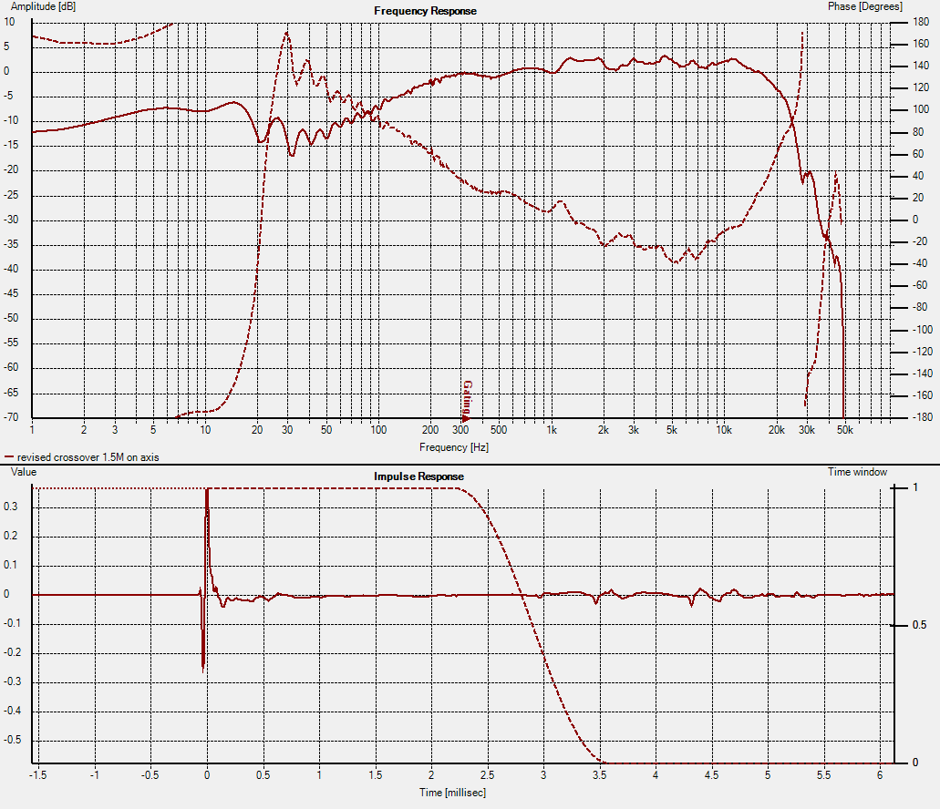

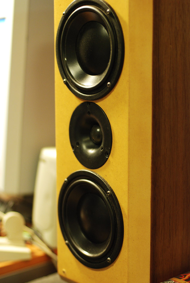

The midbass'/tweeter should be time aligned. This particular combo when mounted as I have them is supposed to be (Terry who posted earlier has done a paper on Time Alignment and used this driver combo in this configuration for his tests).... The measurement attached was taken last year at 1.5M with Holm zero locked after autodetecting on the tweeter measurement (I was using causal impulse for the initial time zero detection, which I've now read may not be the best).
This would indicate a path difference of around 22mm between the tweeter and the woofers (if I'm doing my sums correctly) Note that acording to this the tweeter is 22mm behind the woofers... (more in a minute)
I've taken speed of sound as 343M/sec and the difference between the tweeter and the woofer to be .065ms
Now the measurement was taken on axis with the tweeter at 1.5M distance (for both the tweeter and the woofers, they are in an MTM config). So there will be a difference due to the woofers being slightly off axis (centre to centre is 120mm)
Using Pythagoras I get a difference of only 4.7mm so I'm still about 17mm out... hmmm.
So either my measurements are out, my maths are out, or my speakers aren't really time aligned!
1st attachment is zoom on the impulse on the positive peak, I used the bandpass option in the holm documentation to be able to compare the two impulses on equal footing. 2nd attachment is the same measurement, zoomed out a little on the impulse, but with the tweeter measurement inverted... I'm actually not sure which way it should go... if inverted is correct then it is actually in front of the midbass drivers which is more what you would expect.. however looking at the baffles (these are semi horn loaded tweeters) you would think that they are in fact a lot closer to time aligned than 22mm! (3rd pic)... Man this post has turned into a novel!
Tony.

Keep in mind that HOLM is making a long time measurement and is capturing data prior to the first arrival from the drivers, so there will be data that is, I believe, simply background noise and any test system noise. Time zero as you see it is relative.
Tony.
I'm a little confused. Your tweeter has more depth than most but I still can't imagine it being acoustically behind the woofer. Think in terms of the voice coil planes. That is approx. where the acoustic center is.
I've forgotten what the bandpass part of Holm does but won't it modify/dominate the phase response? What do the unfiltered impulses look like?
As a general design principle your objective is not to allign impulses, rather to get phase curves to line up through the crossover region. That likely will not line up the impulses. The impulses tell more about the energy arrival in the center of the respective bands. Energy arrivals at the overlapping band edges are the key.
Finally, note that inverting the impulse shifts phase 180 degrees but has no impact on arrival time.

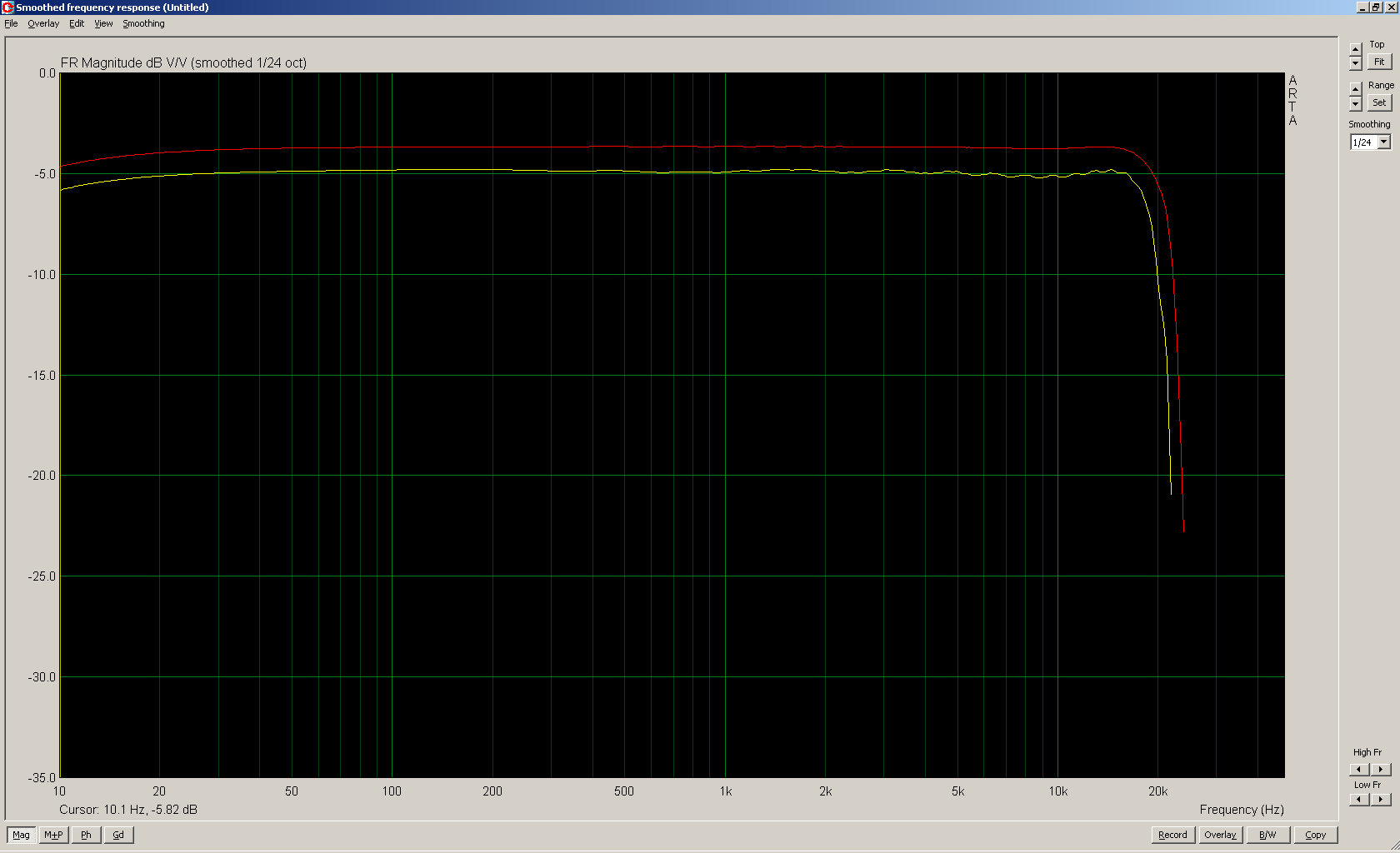

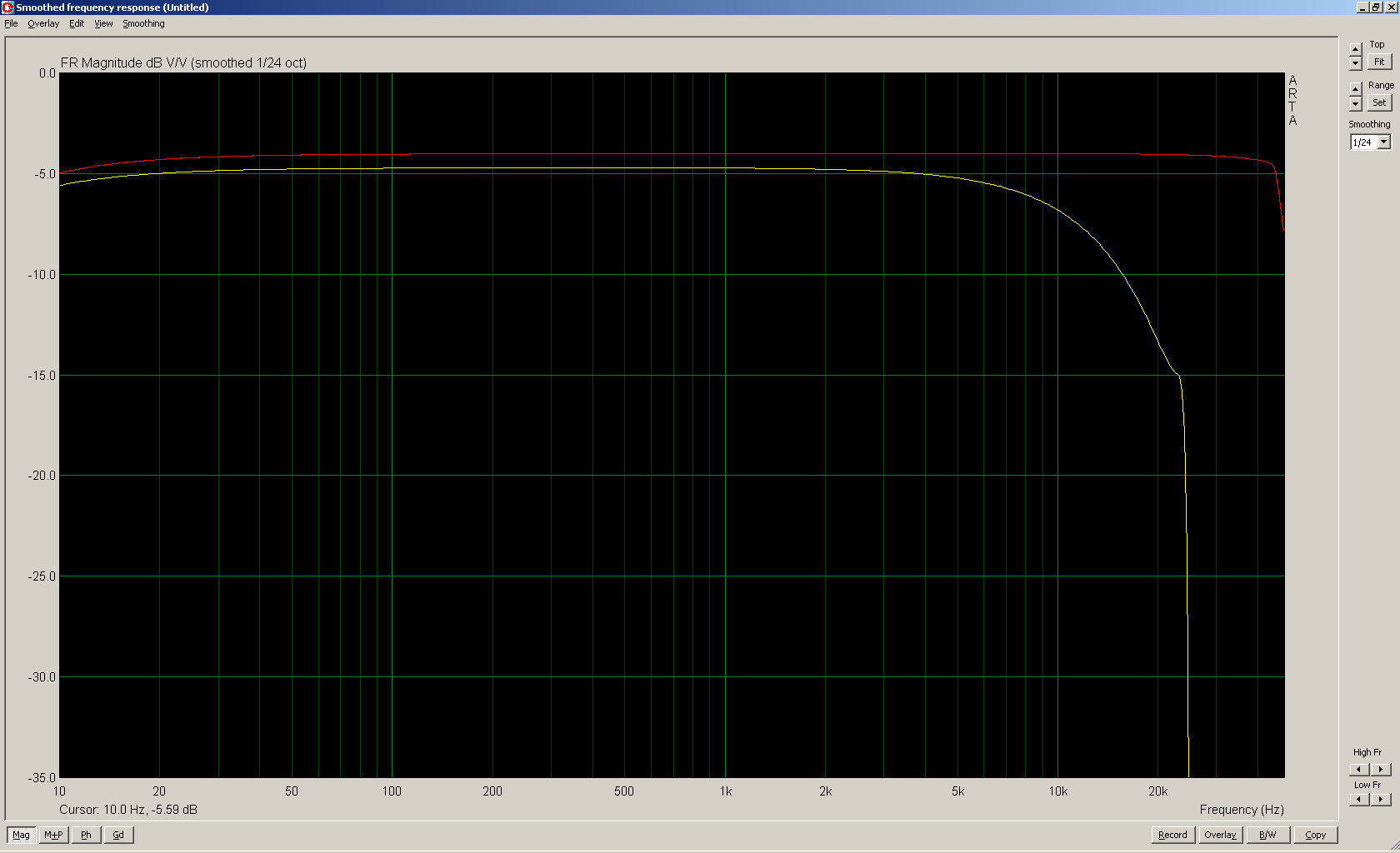

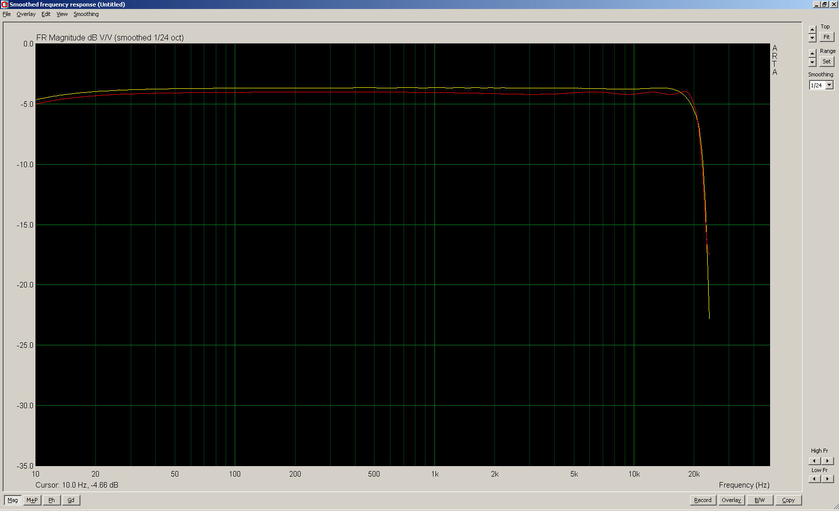

Here's a couple of FR sweeps that show just how wrong things can go...
The first screen shot is at 96Khz 24 bit - the red line is the correct response flat to nearly 45Khz obtained with ARTA as the only sound using application open, the yellow response is the same measurement taken with the same settings in ARTA simply with iTunes launched in the background, not even playing. The roll off beginning below 10Khz is obvious and shows the card has reverted to 48Khz resampling mode with an excessive low pass filter.
The second screen shot shows the difference between 48Khz at 16 bit, (the yellow line) and 48Khz at 24 bit - in theory this shouldn't cause a problem, but there is some weird kind of resampling going on here too causing ripple in the treble. Moral - don't accidentally use 24 bit together with 48Khz mode. (Easy to forget to change both together in ARTA)
The third screen shot shows the difference between 48Khz 16 bit (red) and 44.1Khz 16 bit. (yellow) Fluctuations are visible across the spectrum but especially above 1Khz. (I probably should have zoomed the vertical axis a bit more) What's not shown by a straight FR measurement is that there is a large amount of aliasing going on in the treble. Definitely to be avoided.
Note that in all cases there are also differences in the relative analogue signal levels in the different sample modes, I haven't introduced a level change for clarity of the graphs - so taking the same measurement in different sample rates/bit depths and expecting the levels to be identical is an exercise in futility - either stick with the same sample and bit rate all the time or check the level calibration when switching modes... 🙂

I think your units are fairly well time alligned in that they track with a constant phase shift of about 60 degrees apart. Slope of the phase curves are the same and that means that delay time is the same. The constant phase shift between the two is not indicative of delay. This does not mean that you will have an easy time of getting linear phase blending.
You had asked about the addition of time alligned units (perhaps as judged by the impulses). The way to think of it is that a multiway system is always the sum of bandpass elements or elements with roll offs at both ends. Frequently you will see articles where people add theoretical sections or electrical filters with no relative delay and infer what ideal crossovers are. Usually these simulations have little practical relevance because most real systems have interunit delay, but in your case the interunit delays are minimal and you will be close to the idealized filter summations.
With bandpasses with no excess delay you will always have phase near 0 in the middle of a bandpass, with rising (+) phase for low frequencies below the corner and falling (minus) phase at and above the high frequency corner. The phase curve of the woofer and the phase curve of the tweeter may look similar (but shifted in frequency) meaning they might match at the middle of the bands but they will deviate from each other at the crossover frequency. (Woofer phase will be drooping down while the tweeter phase will be rising up away from their band centers). What you must do to get the system to blend is to have enough droop on one and upswing on the other for them to come around into phase again. For this you play with two variables: corner rolloff slope and driver polarity. For the tweeter adding a crossover or increasing the order of a crossover will swing the phase up. Likewise, adding a crossover or increasing the crossover order of the woofer will swing its phase down. The right network orders will get the phases to overlap. Alternatively you can get them to track 180 degrees apart and flip the polarity of either unit to achieve phase overlap.
That your units are about 60 degrees apart and that the mid phase is above means that a minimal crossover slope can get then to pull together. If you need more than first order for power handling reasons then you probably need to go higher, say 2nd and 2nd and flip the tweeter polarity.

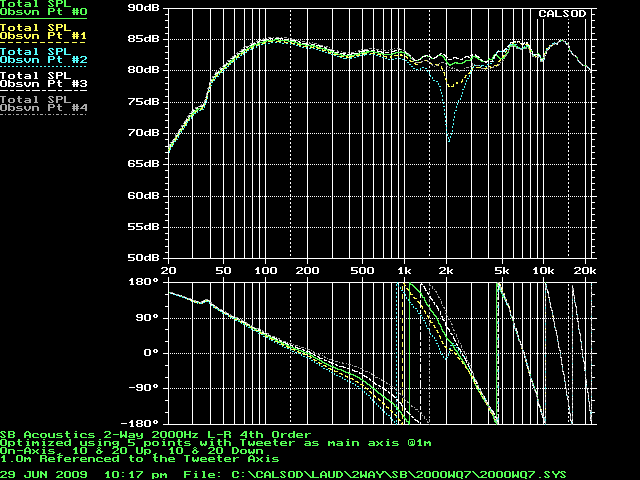

Of course these do not account for diffraction changes (some do provide driver diameter entry), but it does allow one to investigate the impact of the crossover with driver separation.
Dave
I'm not familiar with Calsod but I used to do a lot of XOpt and then transitioned over to LEAP crossover shop. I don't know why either approach would require Hilbert transform derived phase. Obviously if your Hilbert transform is accurate (and your driver is minimum phase, generally the case) then the phase curves will be the same.
One slight distinction is that if you fix the air path delay (say for the shallower tweeter) then you will measure phase as if the source were on the center point of the woofer but on the plane of the baffle. The Hilbert transform gives you phase relative to the acoustic center depth which you must derive by inspection or via your itterative procedure.
Even with multiple listening axis calculations the geometries will be so close as to give the same curves.
David S.
They will be the same with the exception that one will include the excess-phase between the acoustic center and the mic. That excess-phase will be different between drivers in most cases where measurements are based on the tweeter axis.
Yes, this is the issue. The only points in space for which the non-HBT setup provides accurate results will be on an arc with radius equal to the mic distance and the plane it defines orthogonal to the line that passes through the acoustic center of both drivers. In essence, for a typical 2-way with top-mounted tweeter that arc will have a downward tilt. This arc is the only area where the excess-phase of both drivers will remain constant.
I've not made any detailed study of the variability, but much will depend on the driver depth(s), the vertical spacing and the crossover Fc as well as the design point. Two-ways with large midwoofers and subsequently larger separation leave more room for error. The difference may be insignificant. Or not.
I suggest doing this because 1) it's really not that difficult and 2)I suspect it's likely that with the option in software such as the PCD it will be very tempting to check out various locations. Why not remove as much possibility for error as one can?

thanks guys, I was going to post the sim I did this morning with the old measurements... the phase was matching exactly between tweeter and midbass' from about 1000 to 3000 hz was pretty stoked about that.. but speakerworkshop is dying when trying to open the file.. typical!!
One problem I have with PCD is that it doesn't support adding the series resistance for coils in the "additional" crossover components part. Since the bass section of my crossover is mostly (this latest sim did have an added series coil) affected by Notch filters, the PCD doesn't give anywhere near accurate results due to it assuming that the inductors are perfect 🙁 Speaker workshop does allow me to put in the series resistance of the inductors and it gives a much better correlation... PCD allows me to find a starting point for the notches, but it needs to be tweaked in SW to get something that approaches reality...
I think I missed something earlier, will have to read up on Hilbert Transforms.
One more small question. Is it sensible to move the crossover frequency either apart or overlapping somewhat if it results in the phase matching better? It is something I was playing with in PCD for the active crossover that the nearfield measurements were required for.... ie rather than having the slopes for each driver being at say -6db at 300Hz have them at say 280Hz and 320Hz (either appart or overlapping depending on which way improves the phase match)... Obviously the question stands for either active or passive 🙂
