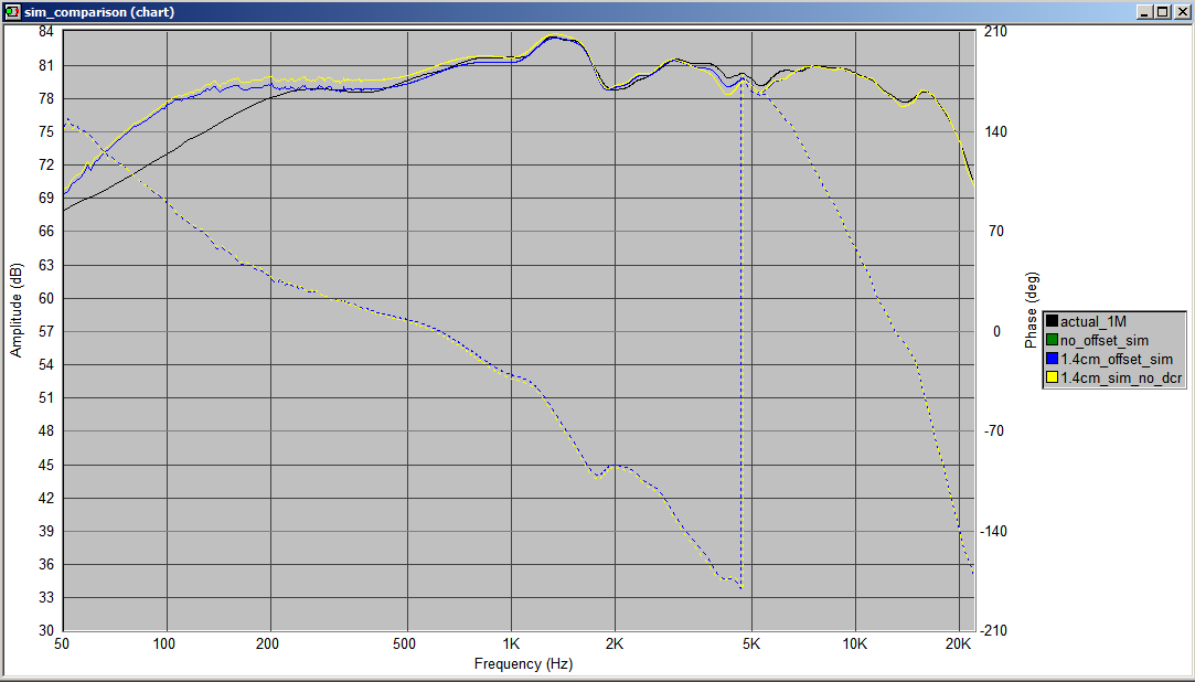

Thanks Dave,

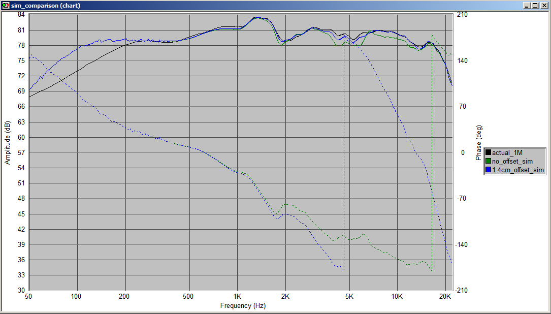

I've had a play in Speaker workshop today with the non-ideal measurements I made recently. The three measurements I have were all taken with the same exact mic position with respect to the speaker (on axis with the tweeter). They are woofers running full range. tweeter running full range. speaker running with crossover in place.
The sim did not line up that well when I put in the current crossover components. However putting in a -ve offset of 1.4cm for the tweeter made a big difference (note I think that this offset is more to do with the fact I didn't zero lock my measurements, than a real offset).
This is using the phase as it came out of holm impulse, I didn't do a hilbert transform to derive the phase from the spl trace.
whilst there are some small errors I think the correlation is excellent (for this particular measurement set). I did have to fudge it a bit as the pad R on the tweeter I had to increase by 0.8 ohms over actual to get the sim to agree with the real measurement..
I've also attached a second comparison which is that between actual, sim with offset, and same sim with no DCR in the notch inductor... the error isn't severe but it is noticable! I have to try the same thing in PCD to see how it behaves and compare to the actual and SW sims too.
Note that the woofers curve in the sim is the one with the nearfiled spliced in so that is why the rolloff is different. The error between 1K and 500Hz with the sims is interesting, but as I said I'm using spliced nearfield data so that could well be the cause of that... But it looks like I now have a new way to adjust my sims to get them closer to actual measured results! When using good measurements hopefully the adjustment required will be minimal.
Tony.

Hi John,
Yes, I've only occasionally considered this and suspect that the larger (deeper) the driver, the more it will vary in this aspect. It surely does complicate the issue. Since the AC is dependent on the radiation from all points on a driver and their inherently different delays, it's the integrated response that matters.
The way I've thought about it is that as one moves off-axis, cones (and domes, though with less impact) have increasingly occluded areas and possibly more time-delayed reflected energy (with cones from occluded reflecting back from non-occluded) and diffracted energy depending on frequency and axis. All of that results in each point in the source having a different excess-delay for its contribution to the whole.
I do suspect, however, that within some reasonably narrow arc the change will be minimal. The off-axis changes due to driver directionality alone may be more consequential in this regard. As Speaker Dave pointed out, the change in delay due to the increased rolloff in the off-axis may have a fairly large impact on the summed response. In that case, you may have the additional attenuation due to rolloff as well as the delay change affecting the relative
AC offset. I don't think I've ever seen anyone make a study of the amount of change with axis. That would be interesting to see.
To me it comes down to there being more variability in a 2-way vs. a 3-way, just one of the compromises that one has to accept. A 3-way should have much less impact simply due to the frequencies involved and the dimensions of adjacent drivers at a crossover point.
I still think that ensuring a reasonably accurate on-axis model is likely the best way to ensure that the resultant polar response is as close to desired as possible.
Then there's the change due to diffraction to add in, so it does get more complicated quickly. It does point to the usefulness of having actual measurements on-axis and off-axis.
But then this raises another issue. Even with CALSOD that can use up to five direct measurements simultaneously when optimizing and with user-controlled weighting for each one if desired, the emphasis of which area to pay most attention to is added in. Does one optimize the on-axis primarily? The on-axis may have more significant diffraction related non-linearity in the response. How much weighting does one give to each specific off-axis area? The change in diffraction with axis can be rather large even for small angles as you know, so the choice of axis for optimization may be significant. Then we can get into window averages and other schemes.
So in the end I suppose the main question may still devolve to how much importance is there in the accuracy of the model on-axis with respect to the relative acoustic offset. I can't say that I have an answer for that, so I simply go for as much accuracy on-axis as I can get.
Dave

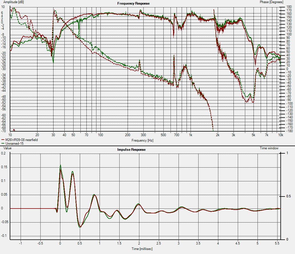

Hi Acosticraft, as it turns out the answer is NO. Whilst I managed to create a simulation (increasing the leakage of the cabinet) that gave a VERY close correlation to the measured response, it was an excercise in futility!
You may have seen me mention that my mic took a fall nose first onto the concrete tiles on the balcony.. This had definitely affected the High frequency response, and I've started to use a new mic capsule. As it turns out, the old mic also had a problem at low frequencies, This may have always been the case and could have been due to me damaging it whilst doing the linkwitz mod.
Attached below is the comparison of two nearfield measurements (driver only, port responses not yet merged) red is with the new mic, green with the old one....
So the problem was that I assumed that the mic was giving me accurate results, and then used simulation to try and replicate what I was seeing, leading me to a completely false conclusion!
The "distortions" in the impedance measurement you refered to are therefore more than likely to be caused by internal reflections, port resonances, and panel resonances in the box... it is after all a very poorly constructed box 🙂
I will now have to put the lining back in and measure again, as the box without it is rather horrid as you can see from the attached plot 😉

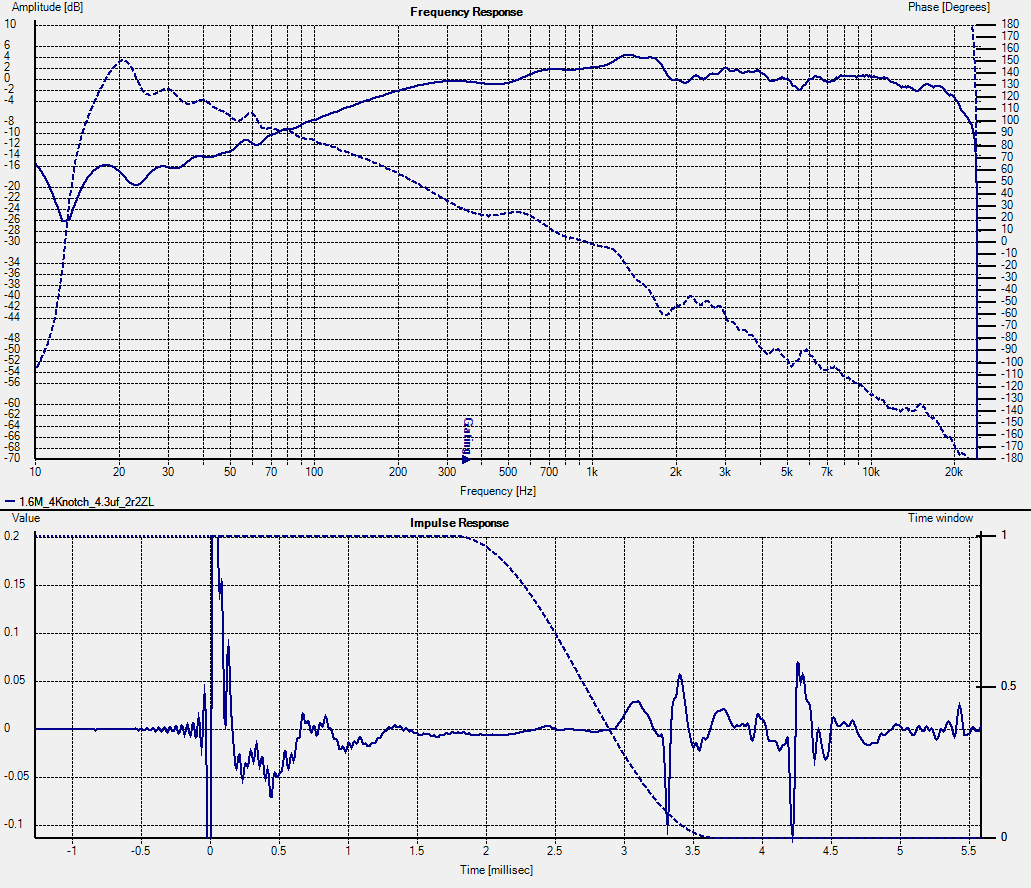

I initially used the mic input with a cheap computer mic with Speaker Workshop just to see what I could get...
Me too, I was using the Mic input of the card for a long time, perhaps naively, first with a cheap computer type mic (waste of time that was 😀 ) then later with the ECM8000 with a balanced to unbalanced transformer and phantom power box I made up. Luckily for me the Mic input of the Audigy 2 ZS is actually very flat, with most sound cards that is not the case. It is quite noisy compared to the line input though.
You never know, I tried moving around, things, changing the position of the mic and speakers till I found something that worked reasonably well (not being parallel to any walls seems to help) I just tried to find the position that gave me the longest time before the first reflection, if you have a low ceiling or very small room though then it could be a losing battle....
I think it's a losing battle where I'm staying at the moment. It's been about 3 years since I was last measuring speakers, at the time I had an open plan living room/kitchen that was 4 metres wide and 8 metres long (!) so I was able to get well away from the walls, and the delay time from the back of the room to the listening position 3 metres from the speaker end was so long it could be heard as a discrete echo 😀 (not so good for actual listening though...)
I was able to get quite good measurements from 200Hz up in that room even with swept sine measurement. Since then I've moved house twice and country once, and until money allows I'm in a relatively small apartment where the biggest room is the living room, at only 3.2m x 4.7m.
No matter what I do in this room or what type of windowing I apply I get horrendous looking frequency response curves that deviate +/- 10dB even though it's the same speakers that sound well balanced and that measured much flatter in the much larger room. If I change measurement location/distance in the room I get completely different results.
I'm quite puzzled that I can't even get a flat(ish) measured response in the treble with a short window, but then again, I didn't have ARTA back when I had the large measuring room, so maybe I'm just not using it properly.
I think the room is just too small with too many objects that I can't get rid of during a measurement. So I'm just biding my time collecting and tinkering with the necessary software and hardware I'll need to make good measurements when I can see my way into a different living environment!
Recently moving outside onto the balcony seems to be even better.... the best part with that is that I can angle so that reflections off nearby walls get bounced out at an angle to open space so I only have to worry about floor and ceiling reflections... I've been thinking lately that if I made a boom I could place the speaker out near the edge with nothing above nothing to the sides, and about 3M to the ground below (via some bushes which should break up reflections anyway)... That may make for some decent measurements down to quite low frequencies 🙂 !

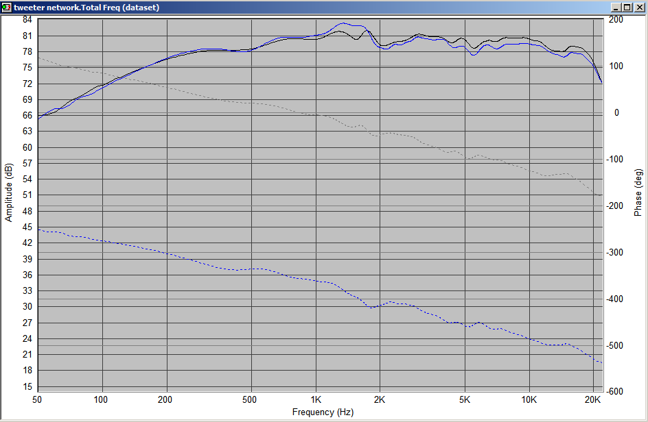

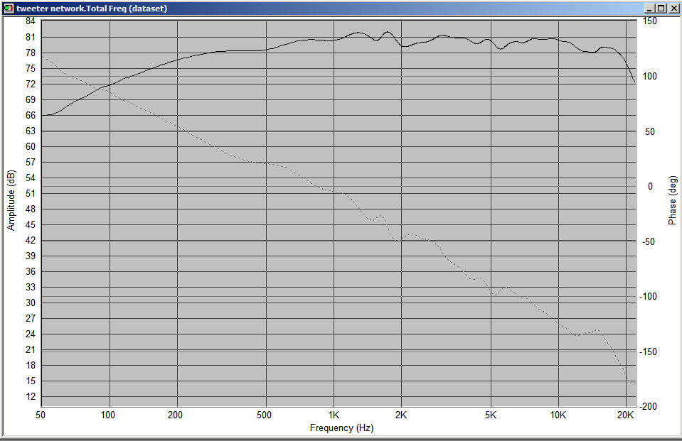

Attached is the result of playing with the crossover sim to try and get something a bit better. Basically I re-did the 1K notch filter I had earlier been using, though I used a different optimisation method and got a somewhat better (simulated) result.
The second plot is the comparison of the actual measured response with the simulation (using individual driver responses taken at the same position) of the current crossover implementation. The blue curve is the actual measured response and black is the sim...

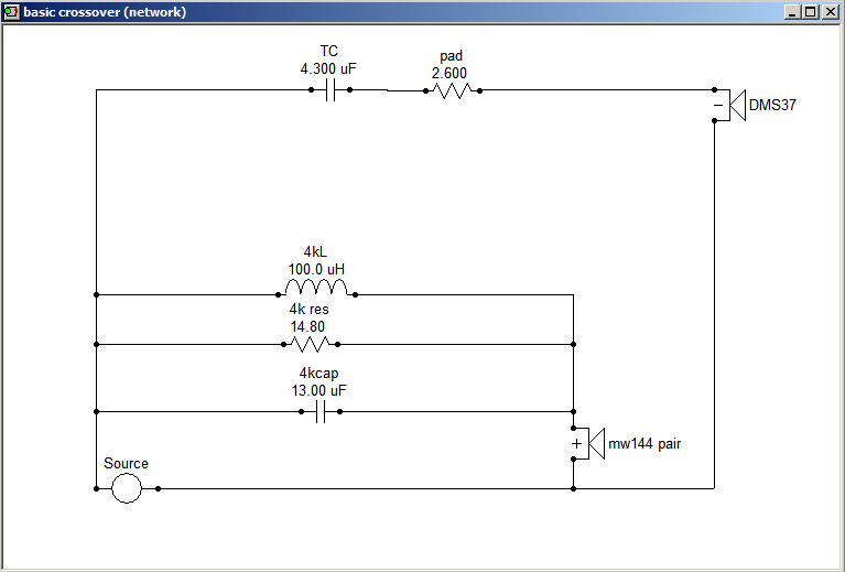

The current crossover schematic is next... as you can see it is rather minimal 😉 I had to up the tweeter pad from the actual of 2.2 to 2.6 to get it to correlate properly, I guess that could be the resistance of the wire leading to it, I didn't use particularly heavy gauge wire...
Probably the flattest implementation of the crossover so far is the one in post 75 of the thread linked above. Note that the tweeter network was basically as it is now, the diagram shows what I was planning... note I actually tried that rlc network (but not the resonant peak filter) and got rid of it 😉 I ended up also getting rid of the 1K notch because it seemed to be causing distortion... perhaps the 100uF bipolar electro was the culprit there... but as you can see that lead to the most unsatisfactory hump between 1 and 2Khz.

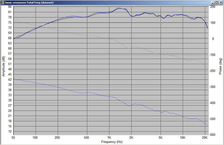

edit: I added a fourth plot, it shows blue, the current actual FR compared to the sim in the first plot...
