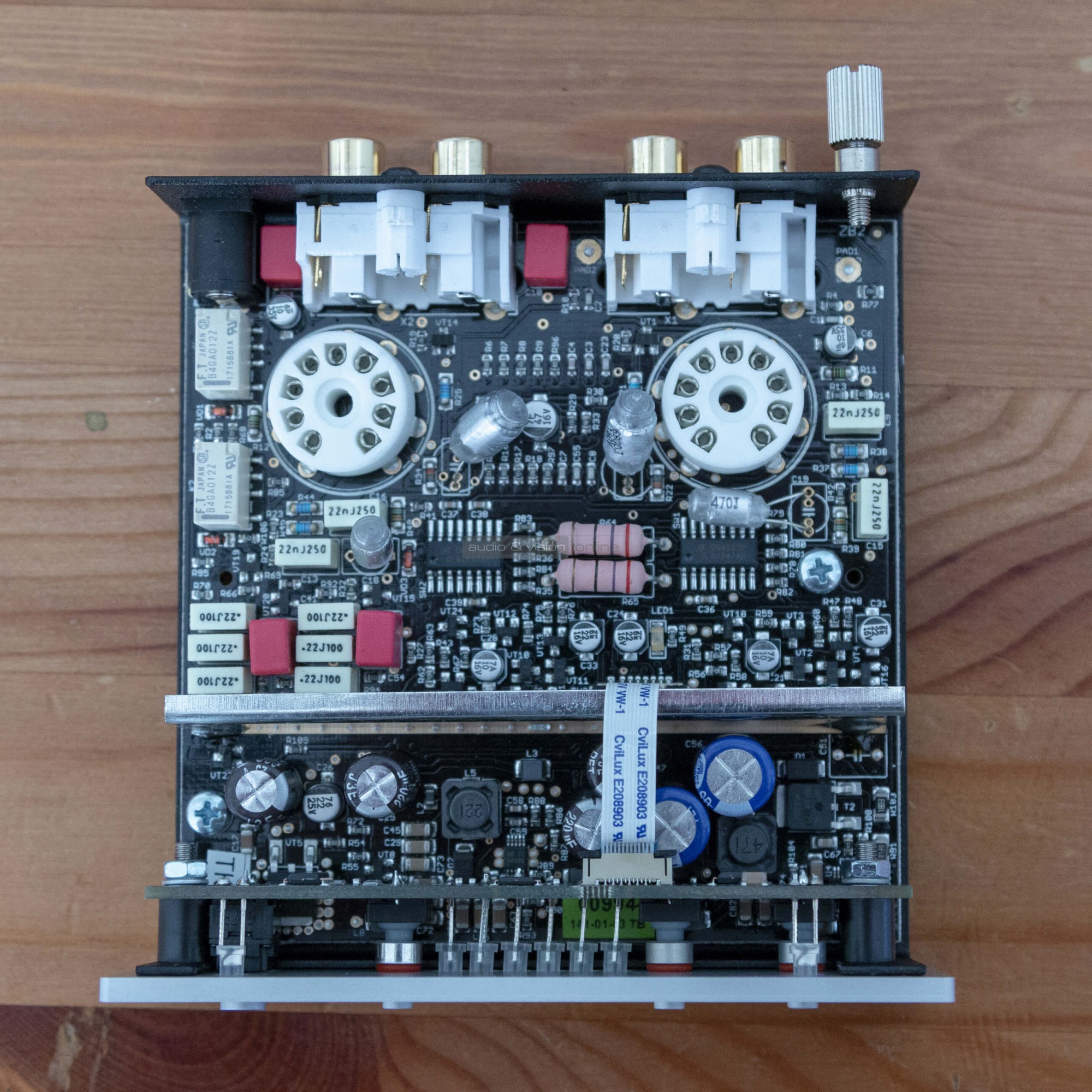

Take a look at the picture. And notice the 2 QUAD 16pins OPAMP´s.I don't know what phono pre you mean, if it's the S2, it doesn't have an Opamp. So no, your opinion is disqualified from start to finish. Sorry.

Aha!Take a look at the picture. And notice the 2 QUAD 16pins OPAMP´s.
That's what I thought. Can you make out #'s?

They are not OPAMP, they are analog switches DG412DYTake a look at the picture. And notice the 2 QUAD 16pins OPAMP´s.

I stand corrected.They are not OPAMP, they are analog switches DG412DY
By enlarging and enhancing the picture, it shows, that you are absolutely correct.The time for editing the post
has expired, so I hereby ask a moderator to delete post #70 for the reason of being false and misleading.
My sincere apology.
