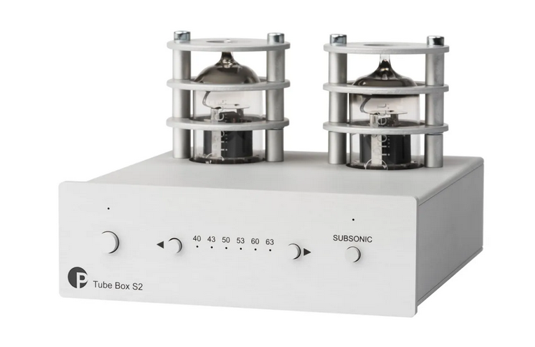

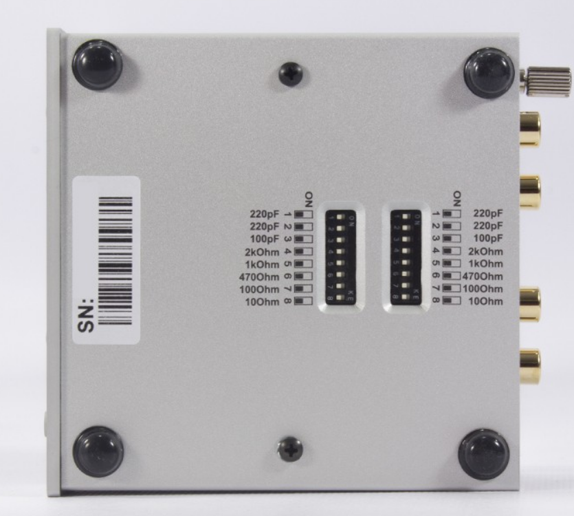

I believe the photo in post #9 and #12 is not Pro-ject Tube Box S2, it is Pro-ject Phono Box S2.Sometimes I wonder, what´s wrong with people. 26 posts, and no one has mentioned this yet except for Mona in post #12.
The Pro-ject Tube Box S2 doesn't has gain setting on the bottom, the gain setting is on the front.

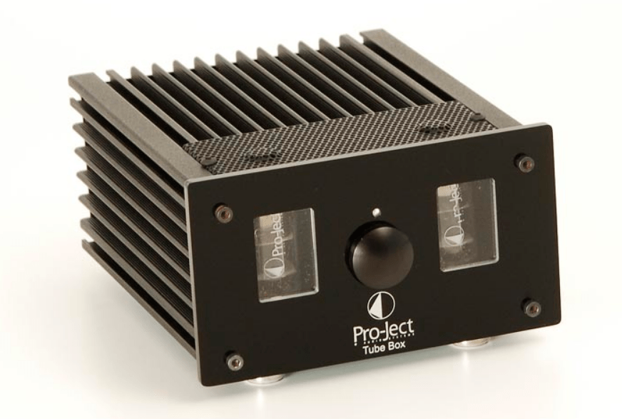

Then what can I see through the windows on the front panel?? Also ventilation mesh on top...That model surely doesn't have cathode follower valves.....judging by the dimensions and heat sinks....
How do you know ? that photo would seem to confirm that there is a need for heat dissipation that would not be justified in a phono preamplifier.
Which would seem to indicate that there is amplification with tubes at the output. ( gain)
Try to find this model in the PJ file. I couldn't, which makes me think that it was one of the first models and was discontinued without remaining at the pinnacle of audiophile favorites.
The heat is from the heaters regardless of the use of the tube. even a cathode follower is going to get hot.How do you know ? that photo would seem to confirm that there is a need for heat dissipation that would not be justified in a phono preamplifier.
Same answer, such dissipation for a dedicated RIAA amplifier, it's not even a preamplifier? I do not understand that.Then what can I see through the windows on the front panel?? Also ventilation mesh on top...

It is a preamplifier, just the gain is from solid state, the tubes are cathode followers. If the tubes were part the the gain circuitry, changing the amplification factor of the tubes would have changed the gain and it didn't.Same answer, such dissipation for a dedicated RIAA amplifier, it's not even a preamplifier? I do not understand that.
You tell me ? 😊The heat is from the heaters regardless of the use of the tube. even a cathode follower is going to get hot.

If the heaters on a tube are powered up, the tube is going to put off some heat, even if nothing else is connected to it. That is why they are called "heaters"...
Seems that with those delicate and sensitive styrene caps, you'd want as cool an environment as feasible.
I'd use whatever method I could to achieve this including heat sinks. To quote 6A3 Summer " just my opinion, ymmv"
Ok, thanks for clearing up my ignorance on this.It is a preamplifier, just the gain is from solid state, the tubes are cathode followers. If the tubes were part the the gain circuitry, changing the amplification factor of the tubes would have changed the gain and it didn't.

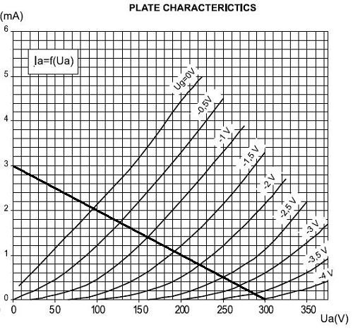

And then what is that of the load line, please explain to me.... 🤔

Did it ever occur to you, that the enclosure was just available for a competitive price at the time, and actually had nothing
to do with dissipating heat??
This was Project´s first "tubed" phono stage, and it didn´t last long, thus being replaced with same electrical construction in far cheaper
enclosures. Why?? Because the heatsinks weren´t neccesary.
The curve traces you show in another post are irrelevant, since there´s no amplification in the tubes. The sole heat dissipation
from the tubes comes from the heaters alone.
As said before..... All Project´s tube Phono´s are SS amplification with cathode followers, who´s sole purpose are to lower
the output impedance and act as a marketing stunt. Could have been done with one trasistor in Class-A pr. channel instead......... period. 🙂

A {working!} cathode follower has dissipation similar to a voltage "gain" stage.irrelevant, since there´s no amplification in the tubes. The sole heat dissipation
Perhaps 1.9 Watts heater and 0.6 Watts through plate-cathode and resistors. So "mostly heater". But the plate circuit dissipation is non-negligible.
