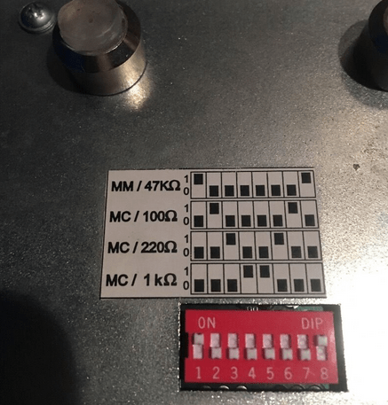

The dip switches are a bit hard to read and have changed on some models, but you do have gain (Db) on the front panel and impedance (Ohms) and sensitivity to adjust to the cartridge on the base. Study it with timees un amplificador Project Tube Se Phono. el de $500. no tengo esquema
You won't get any schematics, not even writing to Pro ject .
But if the pre works, you won't need it.
Heyyy jwagsMine doesnt have that on the bottom. Only loading adjustment,
not gain.
The loading adjustments in your picture are only for low output MC.
If you don´t have the dip-switches in the bottom, you should at least have a switch on the back panel for MM/MC.
Since you cartridge is a high output, the setting needs to be for MM.
Sometimes I wonder, what´s wrong with people. 26 posts, and no one has mentioned this yet exept for Mona in post #12.
Anyway, you need to find the MM/MC selector and put it in the proper position (MM 47Kohm) 🙂

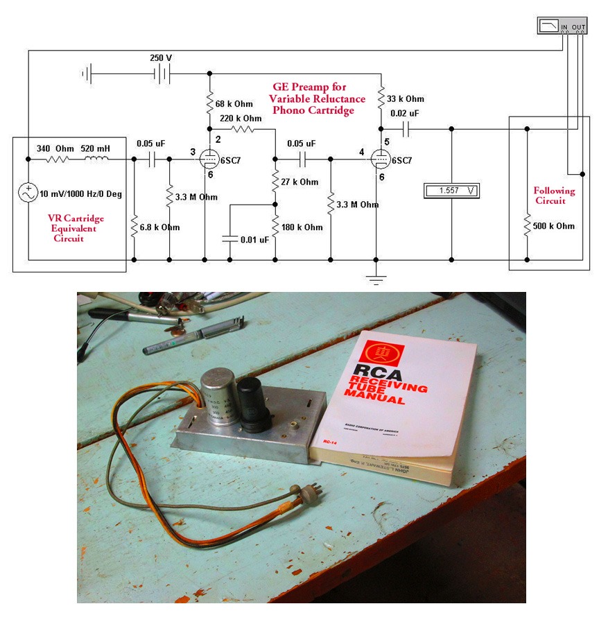

I did a quick schematic with LTSPICE and with same components and 12ax7 and 12au7 come out very similar, gain 16 to 18.
However I don't know how much I trust the LTSPICE models.

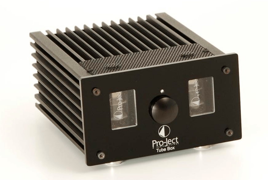

It's not the OP's, it's Project Tube Box SE, (MM) then there's version II, which apparently incorporated MC, (I can't be sure) The official page of Pro Ject had all the models that it manufactured, but in a quick search I did not find it.... Here is to recreate the view and be entertained ............
https://www.google.com/search?rlz=1C1ALOY_esAR969AR969&sxsrf=ALiCzsZ_ap8C21RFkvElQfGCooQ3yzndSQ:1656889788098&source=univ&tbm=isch&q=Project+Tube+Tube+phono+SE&fir=crVg7DBihhqlIM%2C2OZrzdGGJeVGSM%2C_%3ByYo1TDOAMDf-cM%2Cr37cNxOnGLJ5XM%2C_%3B13oasxxC1V4F1M%2Cr37cNxOnGLJ5XM%2C_%3Br61MwdqEAzg70M%2CuvOMcy0o8jbonM%2C_%3BecusOpt5ZnQp_M%2CGbh-e6eBi8VKhM%2C_%3BFhBLxTvSMcJWxM%2CWZI3WL_SZXm1YM%2C_%3BMuvLtLVYUAAdBM%2CDrftA2FSo7ogXM%2C_%3BoiN3839YKT6CtM%2CyUyMhyrrZWQLRM%2C_%3BYVWBW1RfBe6wvM%2CwAukwowuNcLcJM%2C_%3BNlKqMcp46qC9uM%2CAjlnnepYZEjqtM%2C_&usg=AI4_-kQfILQfxqTvhzJc4atz_Tetm-HyNw&sa=X&ved=2ahUKEwiil4G66934AhULu5UCH

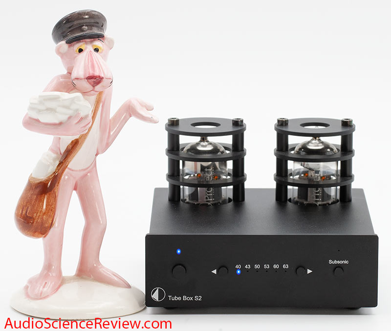

Here is a simple review that helped me decide with the S2, I also read the most technical-with measurements -which is the one that corresponds to the photo of the OP, from the ASR forum
That model surely doesn't have cathode follower valves.....judging by the dimensions and heat sinks....
Find how to search all models manufactured by Pro Ject. On the main page, https://www.project-audio.com/en/archive/ at the bottom, / downloads/ archive.
The nomenclature provided by the OP is incorrect, Tube Box SE does not exist, there is S or SE II.
Diagrams, ha, don't even dream about it.....
