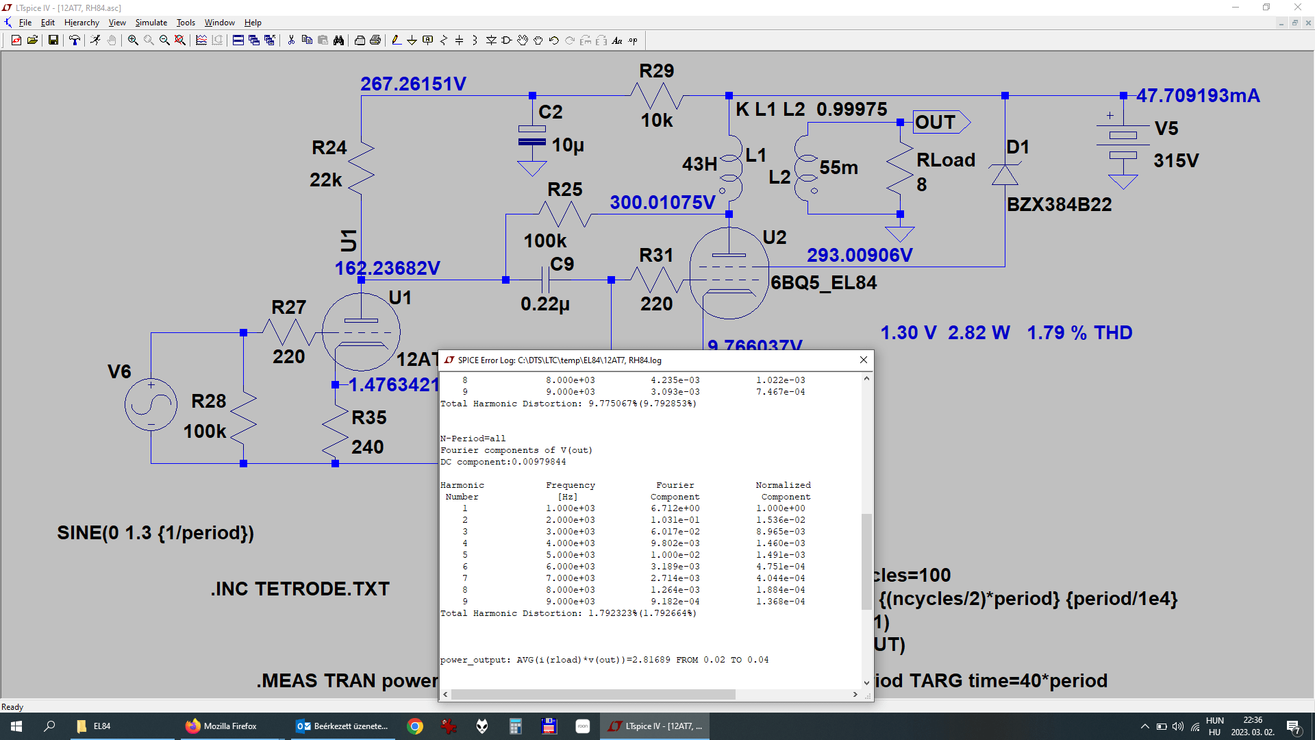

Well I am somewhat satisfied, it ran, however, with the ECC81, distortion went to 18 percent, plus the diode is getting 293V (not the 20V specified), something has corrupted in the file transfer. Glad have it, learned how to adapt a model for the architecture of my file setup and input a .model script (totally intuitive, no instructions needed).

The U1 distortion is 9.77% at this input volume.
The U2 grid2 voltage is : 315V-22V (zener) = 293V.
The output power and distortion is as in #46 schematic.
What's the problem?
The topic is about Spice transformer model. In this sample the model is working perfectly.
If this schematic isn't adequate, must be planned another, with this (or similar) output transformer model.
That is not what the schematic says.

RH84 has Schade feedback, which -among others- reduces distortion, so first stage distortion not significantly influences output THD (which is marked on sample schematic in #46).
First, can you please point out this Schade feedback on the schematic?
Second, the THD on the schematic, as you said, is not accurate, we both found 10 percent. Meaning, seems the schematic needs to be looked over and find the inefficiency(ies), as can get below 0,1THD with other schematics, though 1THD probably be satisfactory.
