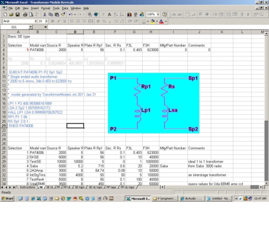

Some time ago I posted a spreadsheet for generating the parameters for a transformer SPICE model. I have received some recent emails asking questions about it, and I have also seen the recent post from pweaudiotech with his spreadsheets. This has jogged my memory and made me remember that I made a much improved version over a year ago.
It generates the SPICE model as well a just the parameters.
It will generate models for single ended, push pull, ultralinear, with or without multiple speaker taps.
Use is simple, instructions are included on the first sheet of the spreadsheet.
Attached is a screen shot showing the simplest case, a SE transformer with a single output. The xls file (zipped) is also attached.
The usual caveats apply :
This is a model, reality will be slightly different.
It does not model core effects ie saturation etc.
The parameters I have listed for various transformers may or may not be accurate, I have taken them from data sheets, from websites, from wherever, and in some cases where information was not available, just guessed. So put whatever numbers you think best in here.
Also, in some cases I have added multiple speaker taps to transformers that dont really have them, just to play around with them.

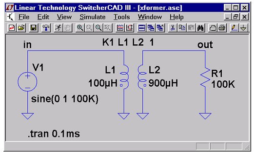

sorry to sound foolish but how does one create the model in LTSpice?
Transformer Models
How do I build a transformer model?
The best way would be to draft a model with coupled inductors
with a mutual inductance statement placed as a SPICE directive
on the schematic. See the section on mutual Inductance for more
information. Inductors participating in a mutual inductance
will be drawn with a phasing dot.
The following example demonstrates a transformer with 1:3 turns
ratio (one to nine inductance ratio) with a sine wave input and
simulates for 0.1ms. The K is set to 1 to model a transformer
with no leakage inductance.
see page 185 of the manual: http://ltspice.linear.com/software/scad3.pdf
