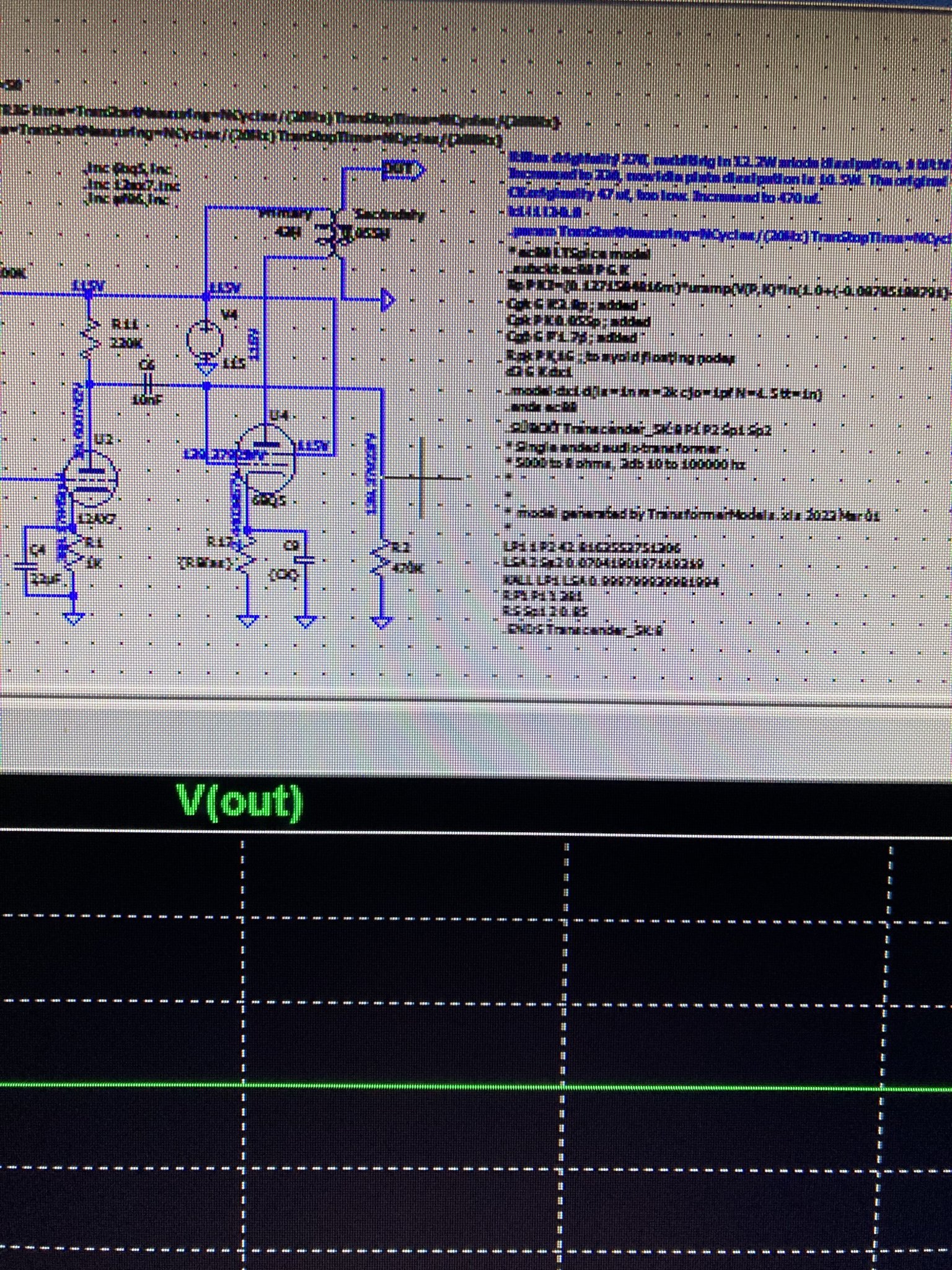

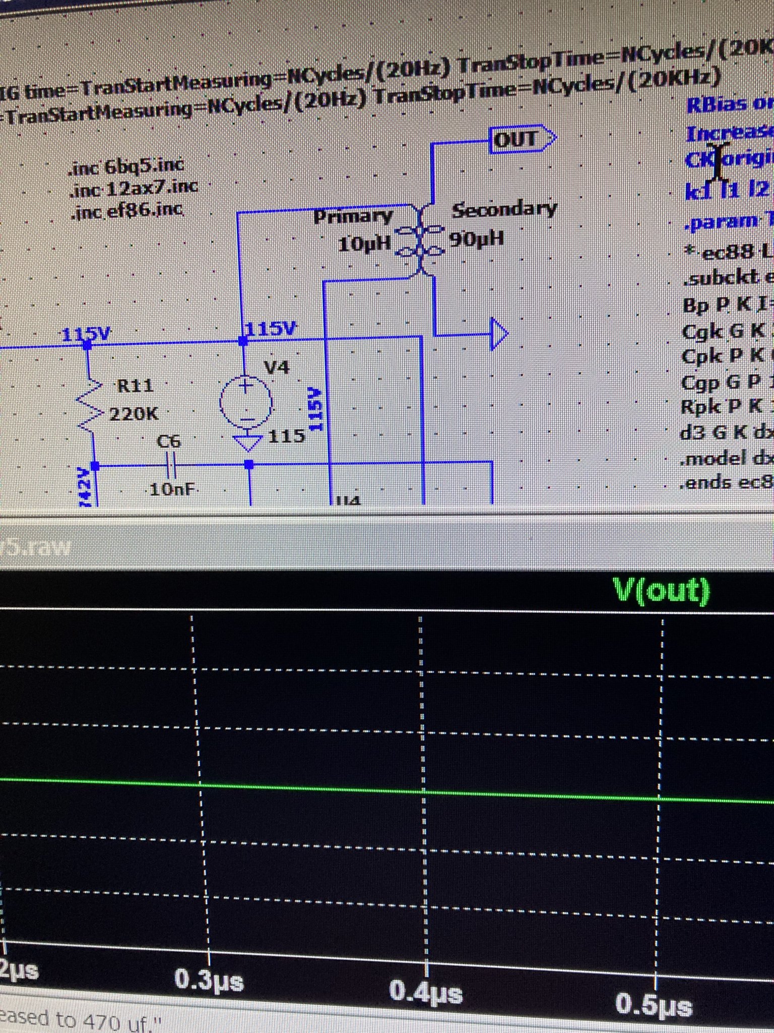

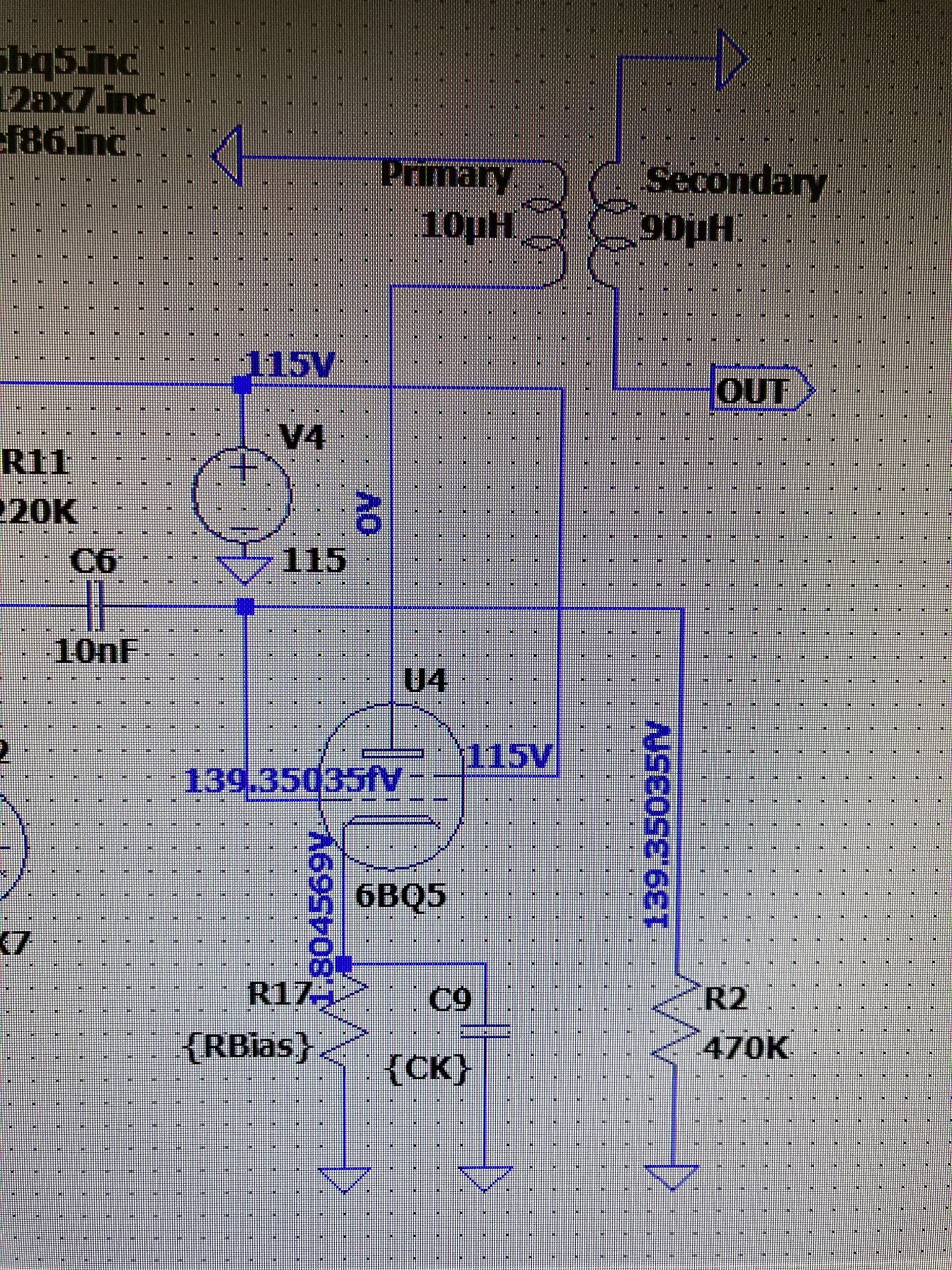

I have a schematic that uses a scavenged phonograph transformer, only know the resistances. I used the second method and getting no voltage out, is there a bug in the program? Did try different ratios and distances between, plus grounding various ways to no avail.

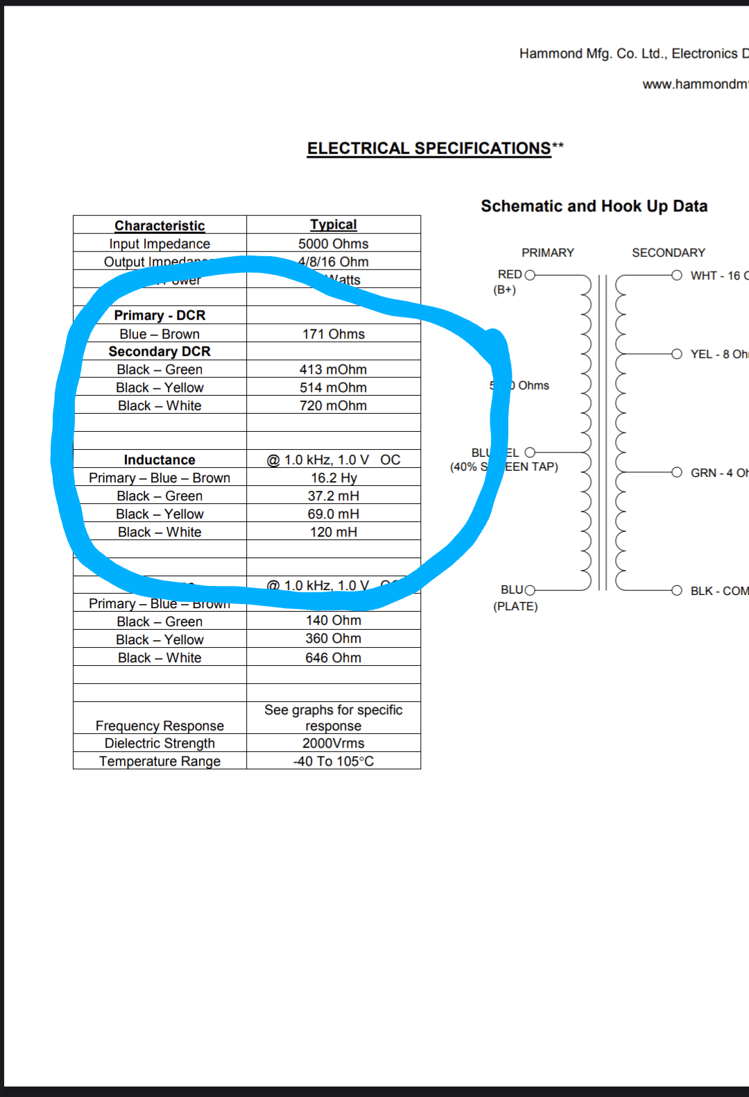

In addition to what euro21 pointed out, the output transformer primary has very little inductance (10uH). Output transformers are used to match the high impedance of a tube with the low impedance of a speaker. Typically an output transformer will have between 10H and 60H.
Below you can see values for a Hammond 1628:

Try this parameters:
Transcendar_5k:8
L1 43H ; primary inductance
R1 381 ; primary resistance
L2 .055H ; secondary inductance
R2 .85 ; secondary resistance
K1 L1 L2 .99975 ; coupling coefficient
C1 5p ; primary side capacitance
C2 20p ; secondary side capacitance
C3 520p ; primary to secondary capacitance
Still does not work. Delete the program and re-install to git rid of the bug?
Interesting the instructions posted in this thread are so wrong, just goes to show not everything on here is accurate.

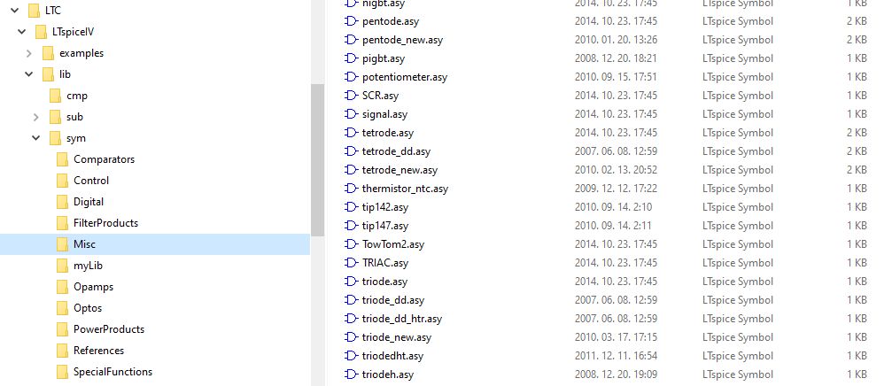

Do you have tetrode.asy?
If not, copy this to empty txt file and save as tetrode.asy.

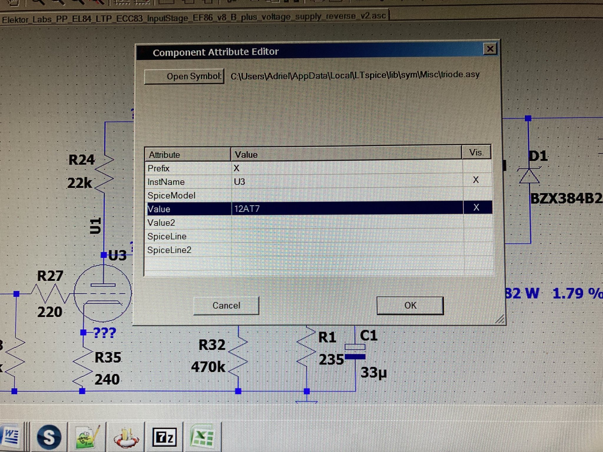

ECC81..83 is triode, so need triode.asy as symbol, as you showed in #55 post.
Tetrode symbol represents four pin tube, as EL84.
I am not understanding what you are getting at... I just checked and it is using triode.asy.
Checked the data sheet and says triode: https://frank.pocnet.net/sheets/010/e/ECC81.pdf.
Edit. Pasted in a known working ECC83, then got unhappy about the EL84, so pasted in a known working EL84, and now upset about the ECC83.

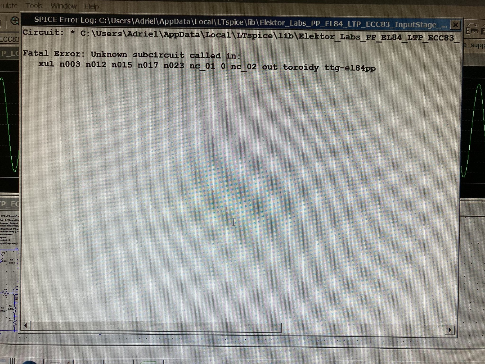

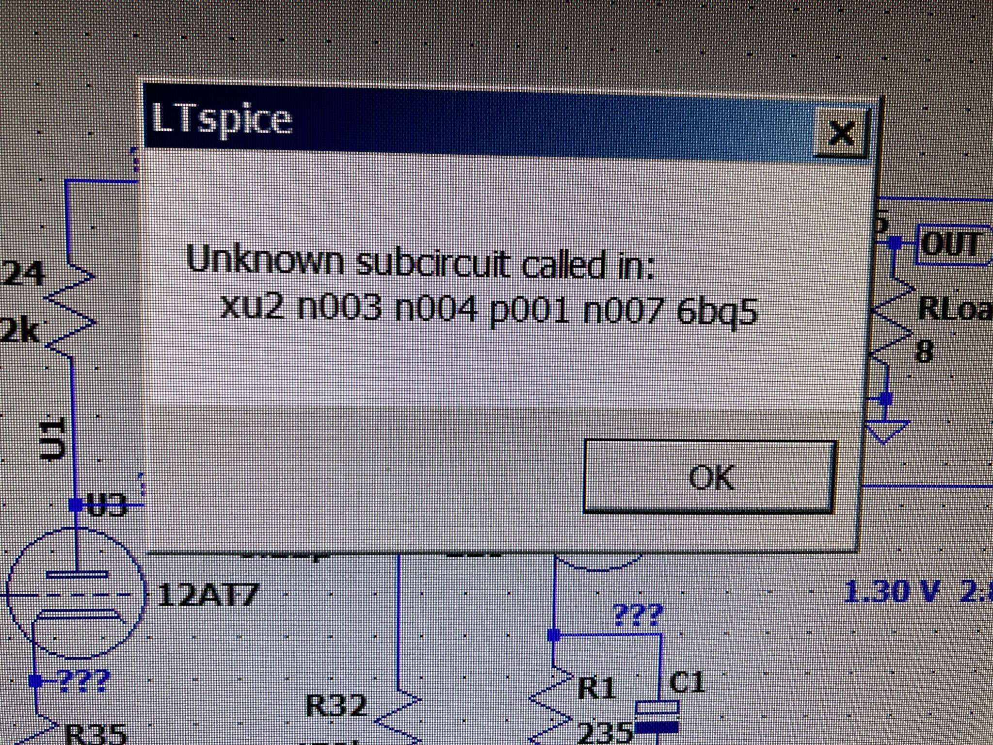

Edit 2. Just hit me while working on a different model yours had the scripts stripped when downloaded and loaded onto the PC. Bet that is it, going to try that.
Edit 3. Now it can't find the diode... I can't win. 😆

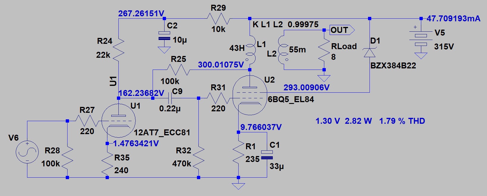

Edit 4. I got it! 😀 Found the .model text, scripted it in, and ran with no errors. Came out to 10 percent THD.
Well I am somewhat satisfied, it ran, however, with the ECC81, distortion went to 18 percent, plus the diode is getting 293V (not the 20V specified), something has corrupted in the file transfer. Glad have it, learned how to adapt a model for the architecture of my file setup and input a .model script (totally intuitive, no instructions needed).
