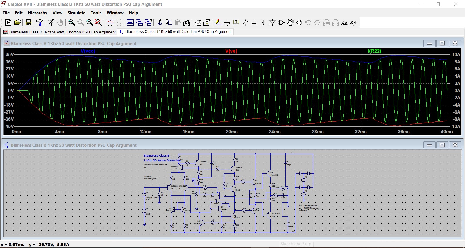

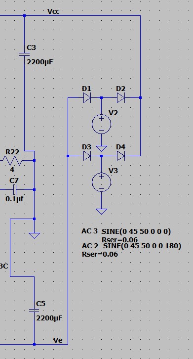

Not sure if this is the right thread, but I've a tip for simulating mains transformer/rectifier/filter cap PSUs bypassing the initial startup.
I was adding a simple diode/filtercap PSU model to an amp model, and the simulation was taking forever to charge up all the capacitors in the circuit (as there were no DC voltage sources any more, the transient simulation initial conditions did not preset any caps as charged).
So I added DC voltage sources, feeding via 100 ohm resistors to the rails - this set the initial state of the filter caps and other amplifier caps nicely, without distorting the emulation of the whole system under load very much. Now a couple cycles of emulated mains is plenty to establish realistic rail ripple waveforms.
That sounds like it could work. There are a 1001 ways to do things in LT (Lol and I know about 1% of that 😉)
I've found this works for me.

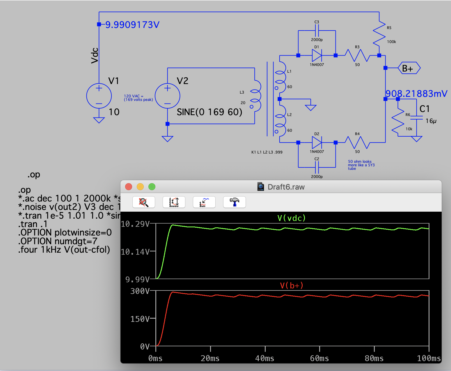

How do I overcome the initial state DC analysis when I use a 'real transformer' instead of a Voltage Source?
It gives me crazy DC points (like DC=-6mV on a DC 350 V supply) and just to check I added a 10V source across a 100K resistor and the DC point is . . . 1V .
> Normally I use a voltage source say 350V and am happy, but here I have the PS of a Fender and I wanted to know how the ripple goes through the amplifier.
So I thought to use the UIC modifier, but having the Mac version of LTSpice I have no pop-up to help me out; and found nothing on the wikis etc. Using .tran 1m 2.1 2 gives the correct flow of the ripple, but not of the DC!
