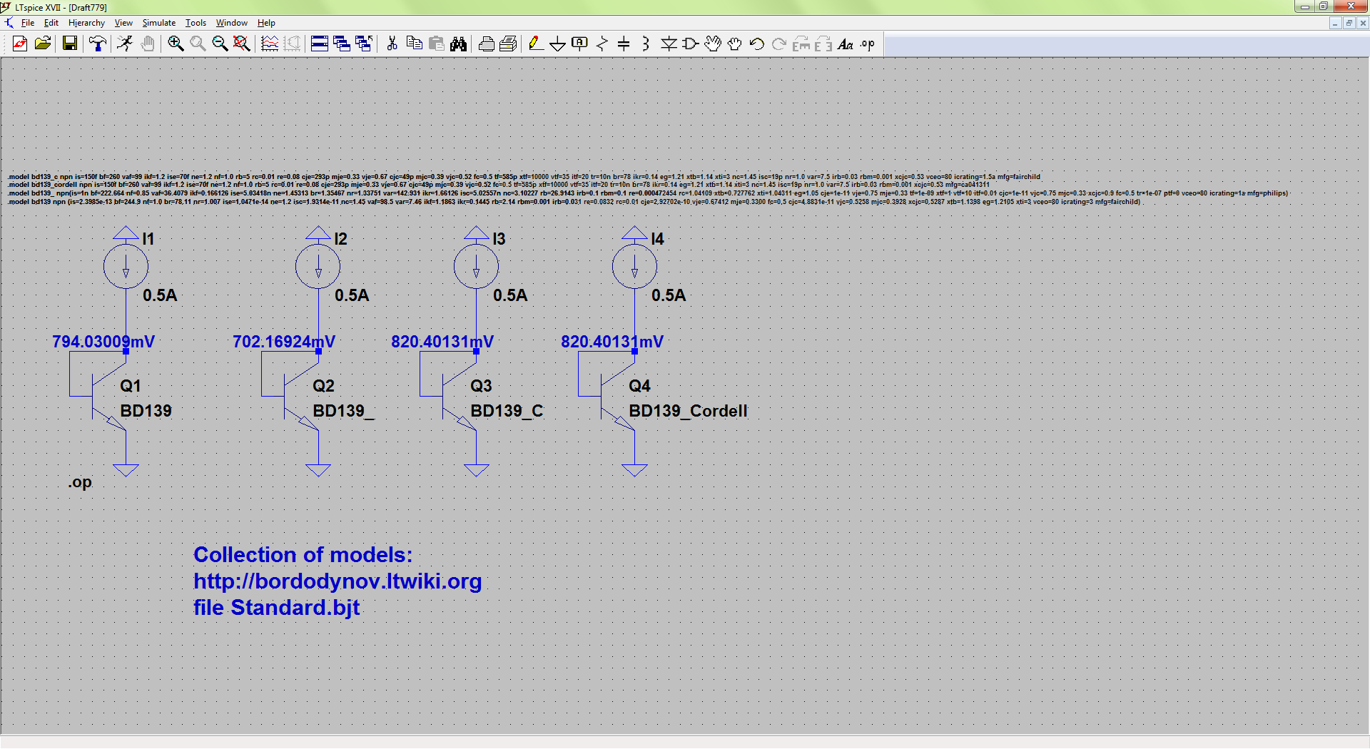

Anybody have good spice models for BD139/BD140?
All models I have found shows Vbe like 0.40 Volt.
According to datasheet Vbe should be something like 0.65 Volt.
I use Multisim
I use Multisim
Is this in circuit, in use, or the model parameter? I'll check the BD139 model I use.
Bob Cordell's site has his BD139/BD140 model.
I suspect you have the MODPEX file in your simulator. That is quite useless IMHO. FOr example IS=somethingE-9, should be E-13 to -14; NF 0.85 nearly all Si transistors have NF=1.0something.
I challenged ON Semi on this. They said their models are to datasheet spec. Well, no-one wants absolute limiting specs, but TYPICAL results for TYPICAL performance!
Don't think they listened.
And ST's SPICE model for BD139 refers to a completely different transistor (when I looked).

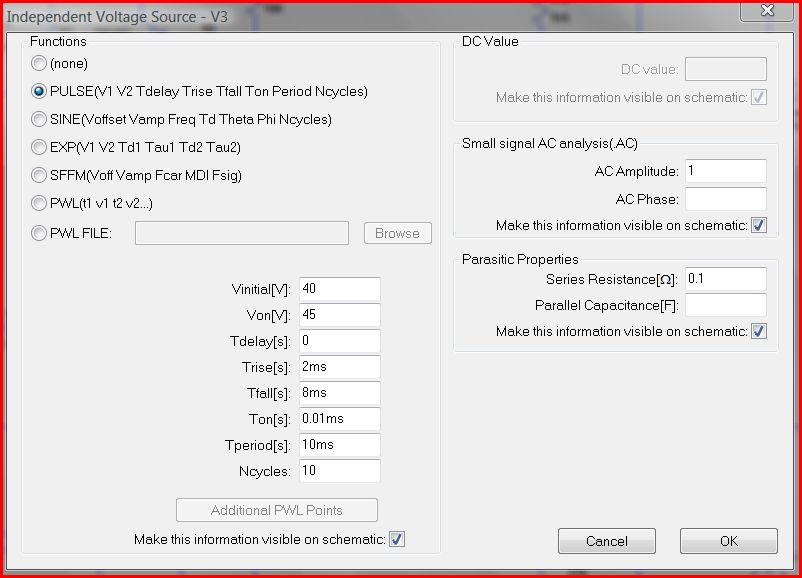

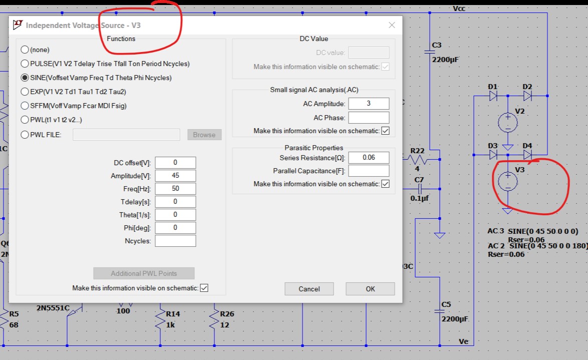

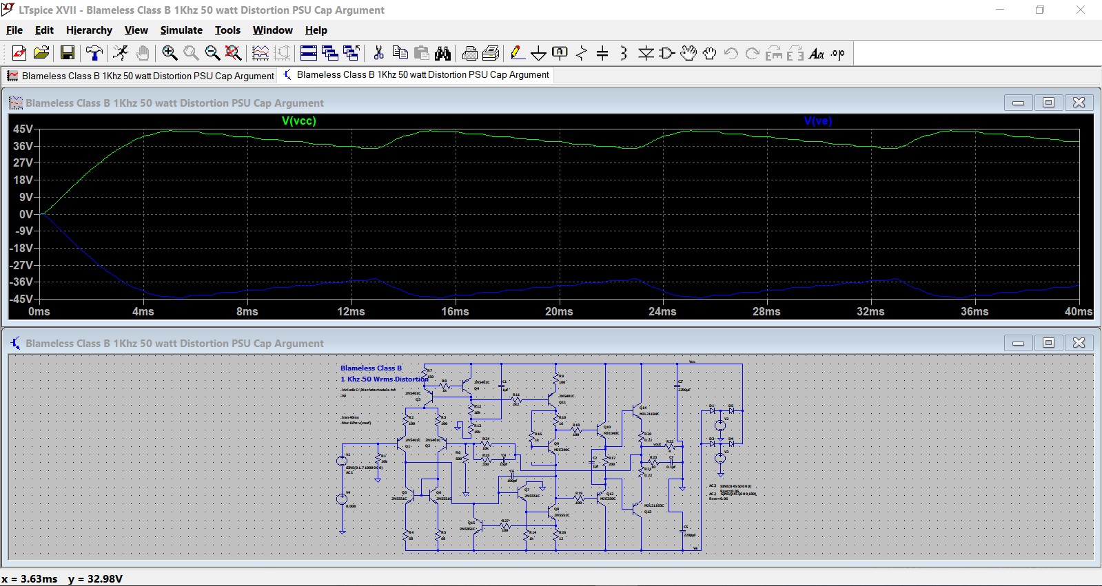

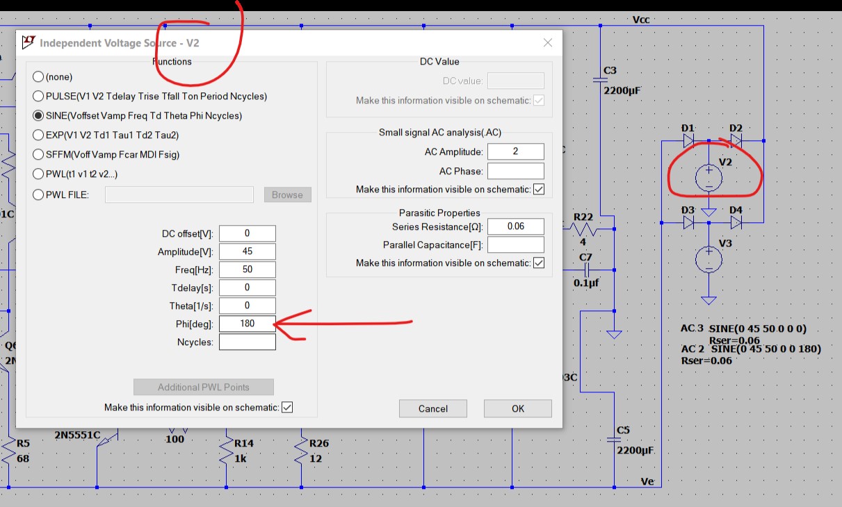

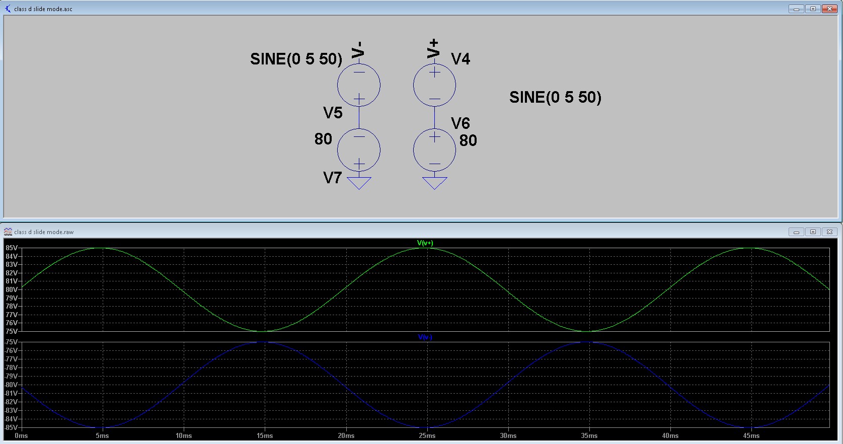

I did want ripple on the supply.
I have put a sinus signal in the supply for sim, is this right? I need to do 100 hz afcourse, but for the idea.
thanks.
Ripple isn't sinusoidal. If you want to simulate ripple then try setting each rail like this (first image) or use a 'real' AC voltage source and rectifier.
