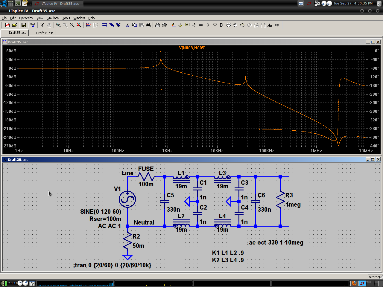

Klewis, find a diagram of the wiring system of a house and you will have an idea of where the ground goes. I don't know why you would get no current through that resistor, unless your voltage source had too high a frequency or too low a voltage. Or you had accidentally given one of your caps a low value parallel resistance instead of series resistance.
For the inductors you need to have a coupling parameter, for instance
K1 L1 L2 .9
Where .9 is the coupling coefficient; 1 is perfect but not realistic. You will need to flip the inductors depending on whether the coupling is common-mode or differential-mode. I think the chokes in line filters are common-mode (not sure).
Here's a schematic for my Feller filter, with improvised house wiring (bad guess probably). Response graph is probably unrealistic too.

keantoken is correct, the sine source needs to be ground referenced. for 6 amps, make R3 20 ohms. if you need to simulate noise on the line, you can add a noise source in series with the sine source (for the frequency response test make the AC parameter of the noise source 0V). all voltage sources in LTSpice are zero output resistance by default.
i think the resistance between neutral and ground is more realistically around 100-200 milliohms. there's quite a bit of footage of copper in those walls, and a lot of the integrity of the ground and neutral runs depends on the skill of whoever installed the wiring. i once tried to help somebody figure out a wiring problem in their house, and the neutral and ground at the end of a string of outlets had about 1 ohm between them (with a 10 amp load, the difference between neutral and ground was 10V, and 110V between neutral and hot). now that's extreme (and dangerous) (fortunately, tightening up some screws on some of the outlets in the string brought it down to about 0.2 ohms). likewise, poorly installed grounds can be a hazard if something shorts to ground.

Thanks for the help. Kean, no don't solder your outlets. The reason the screws seem to loosen is because when you draw significant current through an outlet, the wire heats up and expands. With the expansion, either the screw stretches, or the wire compresses. Either of these actions are permanent, so, the screw to wire contact is reduced. This bad contact then increases the heat when current is drawn and the process repeats until the contact is pretty weak and the screw is quite loose. In modern house wiring the neutral and ground are joined at the fuse/circuit breaker panel. It's a safety thing, two ground paths are better than one and also better in case their is current on the neutral in the particular circuit. In older houses, the neutral is also the ground and is connected to the earth ground at the panel.
