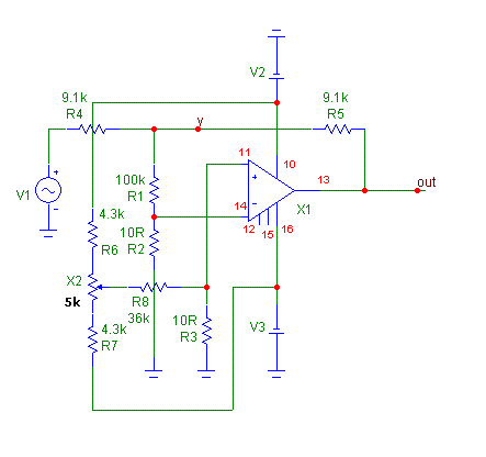

Re: Re: off topic
To be more comprehensible, how much accurate can be a spice simulation for this circuit:
http://www.diyaudio.com/forums/attachment.php?s=&postid=1151427&stamp=1173212907
And below it is the spice model of it ready for you:
http://www.diyaudio.com/forums/attachment.php?s=&postid=1156551&stamp=1173773152

Re: Re: Re: off topic
Simulating what?
Don't let the number of trannies fool you. It's essentially a classic circuit, already analyzed to death. Even the THD (if that's what you are looking for) can be estimated by simply inspecting the schematic and having some previous data regarding the open loop THD vs. the output stage bias, for a particular set of output devices.
I think you just hit one of the simulation major traps. Relying on simulations without having some understanding of the circuit functionality is a pretty safe recipe for disaster. Simulation is a tool for the already illuminated - it may deliver (more or less precise) what you are looking for but it won't tell you straight what to look for.

Re: Re: Re: Re: off topic
The concrete circuit it is not of Hi-End classs, as i suppose that you are thinking so i am thinking for it. It is obviously armed for hard working in P.A. applications. On the contrary of your statement that it is for death, it is checked in practice and it works just fine.
In the spice model that i quote, the only that i try to estimate it is the values of static currents (because their correct values are very significant for the exploitation of the plentiful dynamics which offers this amplification arrangement) so don't be harry in your conclusions. You can calculate very easy their values with the aid of voltage drop markers in the different locations. For this purpose the spice gives by 90% correct results for practical use (because the 1% MF resistors used and only for this). Also i don't use the time domain analysis of simulator to estimate something. The only diagram which i take it is the output power level under different loads (and this is indicated satisfactory by simulation because the output load it is supposed clear resistive) so i can set the values of the output VI limitter circuit resistors summing network to place a limit down to 2 Ohms for activating it. Concretely i modify the values of resistors so the current calculated via the voltage drop accross each emitter resistor, does not exceed the 1,5A per output device so it remains into the SOA given from Motorola.
Because as i suspect you are Mosfet fun, by debate this bipolar implementation with any Mosfet (i bet anything you thing that you can get easy from me by eliminating the obstacle of distance of our places) maybe you revise your thoughts for this "paleolithic" amplification circuit "with its one foot already into the grave". In a previous thread i gave a complette documentation with curves from DSO. You can search it in the forum or in my web page. I refer only that its rise time vary between 1,3ìsec up to 100W/8Ù and 2,3ìsec up to 350W/8Ù with the Miller pole strongly compensated (limitting thus its bandwidth up to 100KHz). My experience showed me that the big power projects of class AB can beat easy each Mosfet or class A project due to its dynamics. This project it is not a toy of 2X100W.
This project also it is not a copy (a CLONE as you like to say in this forum) of the design of anyone. It is the result of my research for many years and the implementation of different topologies in one design for my concrette demands.
Finally this project because the extremely high supply voltage used (up to 170Vpp) i suggested in my thread only in skill full persons because any accidental shorting during setup can causes a big BANG! with catastrophic results so in the devices as in the PCB.

Re: Re: Re: Re: Re: off topic
"Analyzed to death" = Analyzed and re-analyzed all over until nothing new is to be revealed and basic information (like the bias) can be quickly calculated without any Spice help.
Example: Assume beta very large, so that IB~0 and IC~IE. The IQ3=Vbe/R3~3mA. IC4~Vcc/R11=3.7mA. Assuming the circuit is balanced, then IQ1=IQ2=IQ3/2~1.5mA IQ5=IQ1, IQ2=IQ6, etc... Same as above, IQ8~3.7mA and IQ~Vbe/R18~20mA. IQ9~IQ12 and IQ11=(Vbe+R22*IQ12)/R21~2mA Q7 is normally off. It would take much more time to draw the schematic in the capture software than to directly write this bias estimate. The same with the AC analysis, C13 defines the dominant pole, and the impedance at C13 terminals (giving the time constant, which is related to the pole frequency by f=1/(2*PI*Tau) is a textbook exercise as well.
Trannies = transistors in jargon (not "slang"). The number of trannies in parallel do not influence the amp architecture, it is only an implementation detail.
I am having fun with MOSFETs but I'm not necessary a MOSFET fan.
